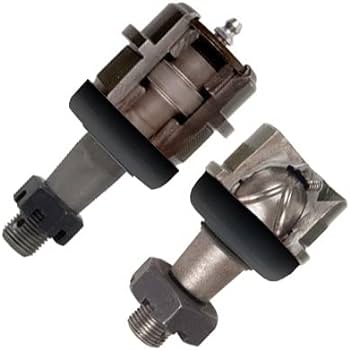

Here is a good cut away representation from Synergy. I run Teraflex and have a similar design.
