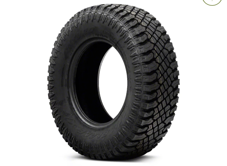

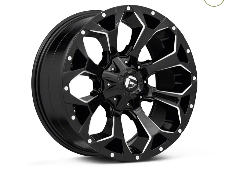

I just bought my 2017 Jeep Wrangler a month and a half ago. I would like to lift it and put bigger tires.
I would like to do at least 17in rims but have considered 20in. I have also looked at 35s for tires.
Suggestions on what rim/tire size do best with what lift height?Recommendations or pros/cons?
Below are the rims (17in) and tires (35s) I am considering.
Welcome, You will need to get the jscan app and a doggle so you can adjust the tire size in the computer for correct shifting and speedo readings. Also check your gearing before going with a larger tire size. Vehicle goodies
Reactions: BLACKJKU
Welcome fellow Huntington Member. Like said above^^^^^^.
Just a thing to remember when you go a bigger tire size you have to recalibrate your speedometer.
Also if you go to a 35" tire you'll more then likely have to do a gear change depending on which gears you have. So it won't be a cheap thing to do unless you would happen to have 4.10 gears, then you can DD a 35" tire ok.
