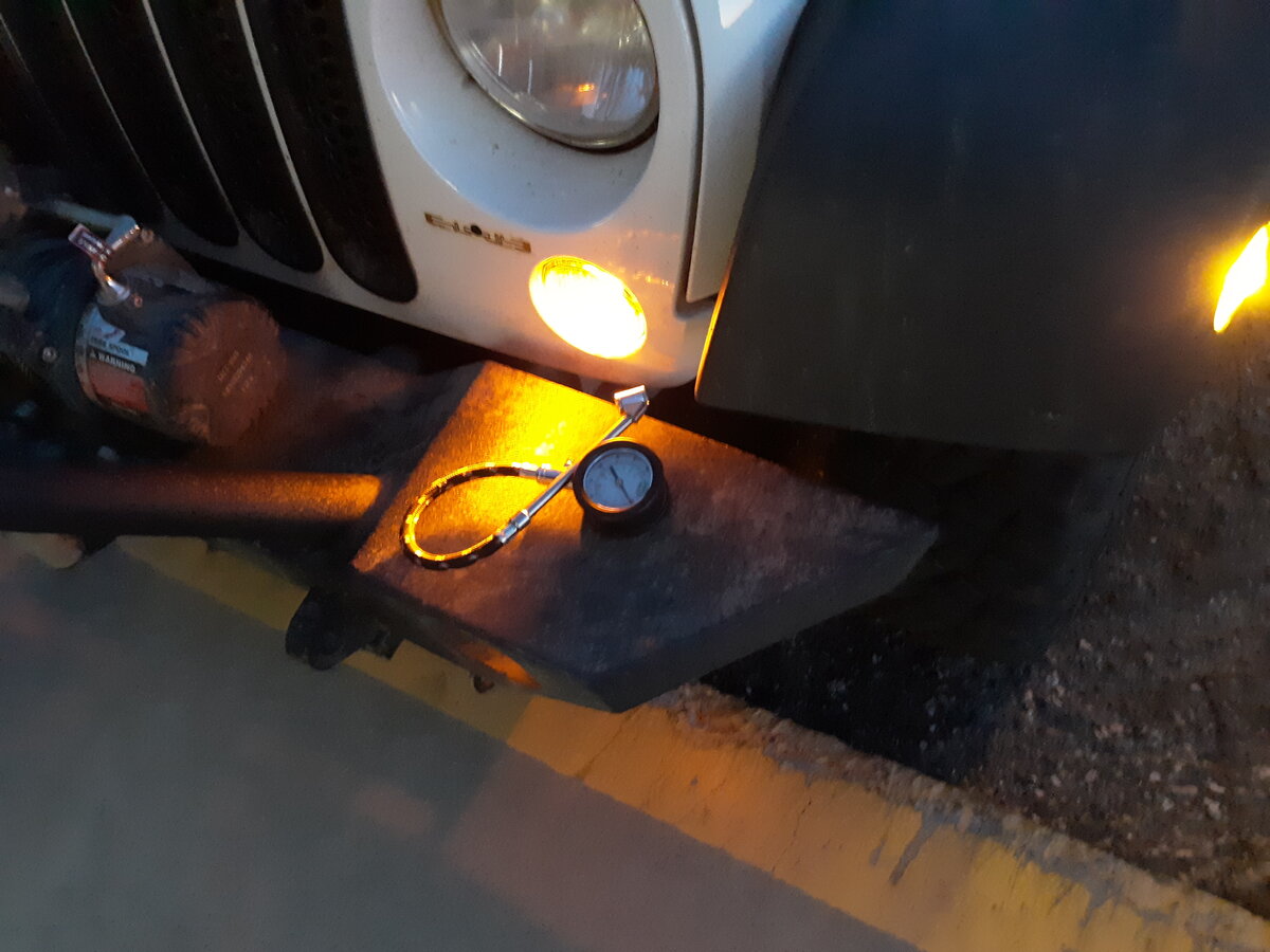

One night I turned on the headlights and turn signal, then walked maybe fifty yards away and ....
The the turn signal was invisible! This was with the crappy stock headlights.
I called Headlight Revolution and ordered the most powerful turn signal light bulb they had.
I crammed a T-10 from Amazon in the side marker lights and them touching the lens has had
no effect.
The tire gauge was left there while I drove 7 miles to the store.
