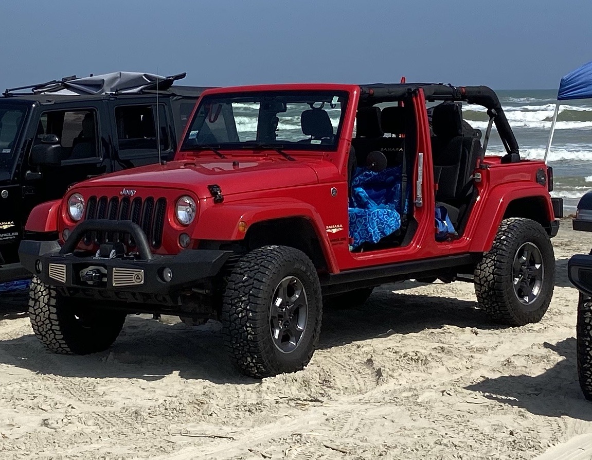

I just put 2020 Gladiator take offs on my 2014 Sahara. They are 17 inch rims. I needed to add spacers and I did a 2.5 lift at the same time but it looks great....
