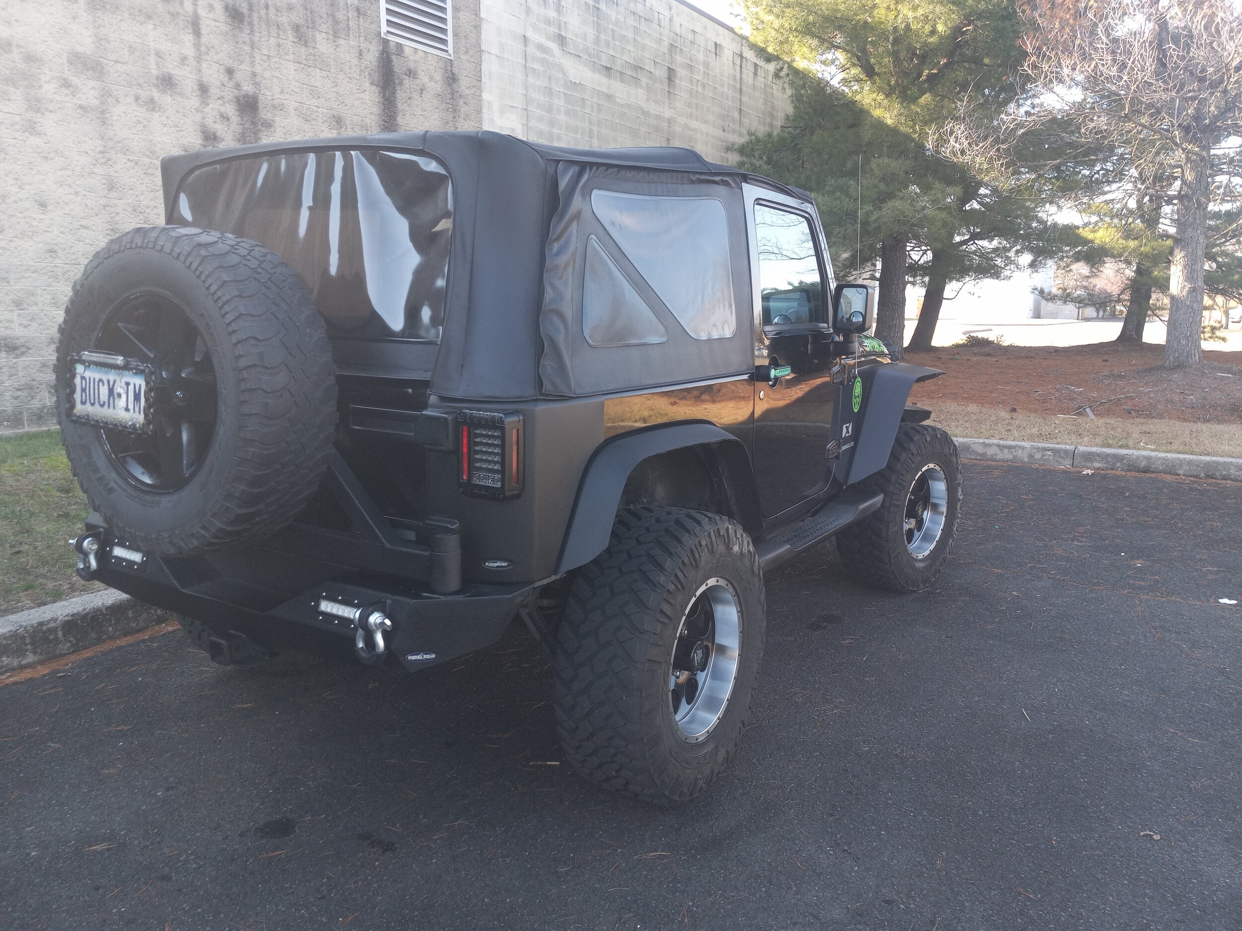

Yes, I’m sorry about that. It is a 2-door.
Go for it a soft top will make you love your jeep more then you already do...so yes there are Xtra parts needed a header rail , a tailgate bar ,and door surrounds .go on offer up ,craigslist etc. They are in abundance and most include all the parts needed I got mine for 125 bucks on offer up ...
