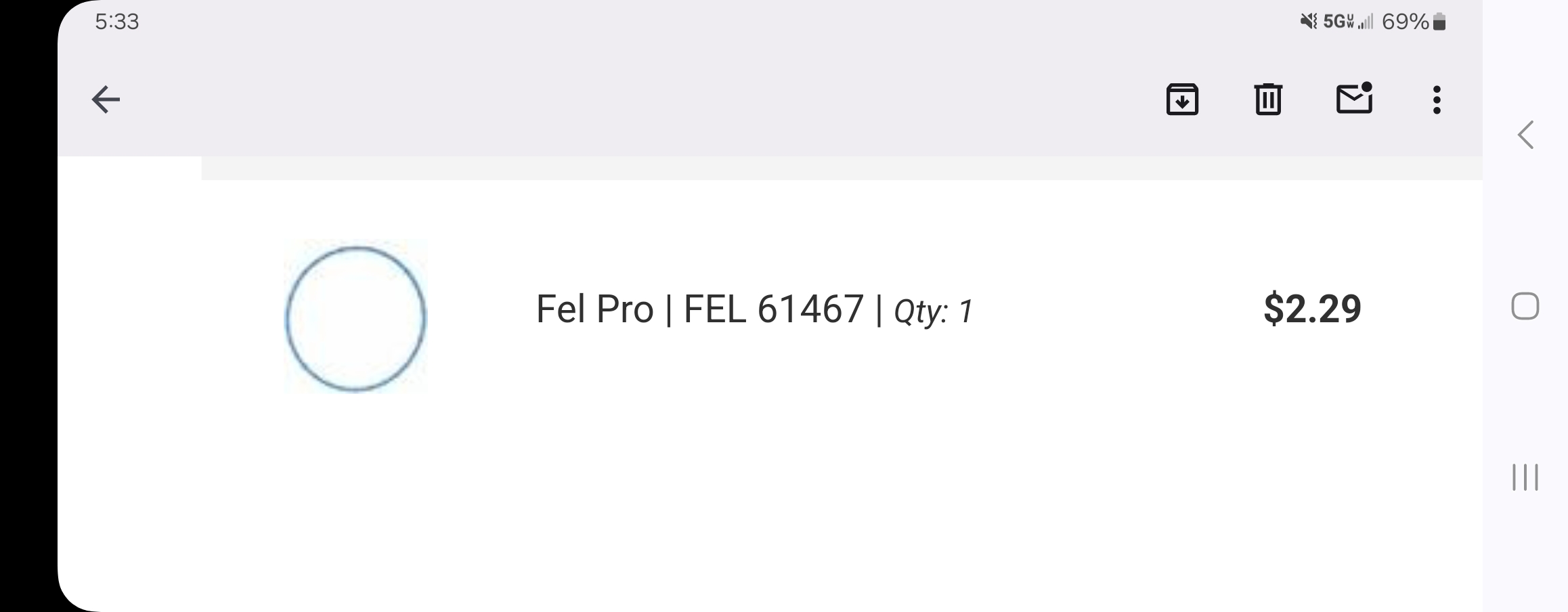

Please provide a few more details on this O-Ring…
Reactions: tJKrider
this is the gasket. It goes between the throttle body and the intake. 2.50 from O'Reilly auto parts.
