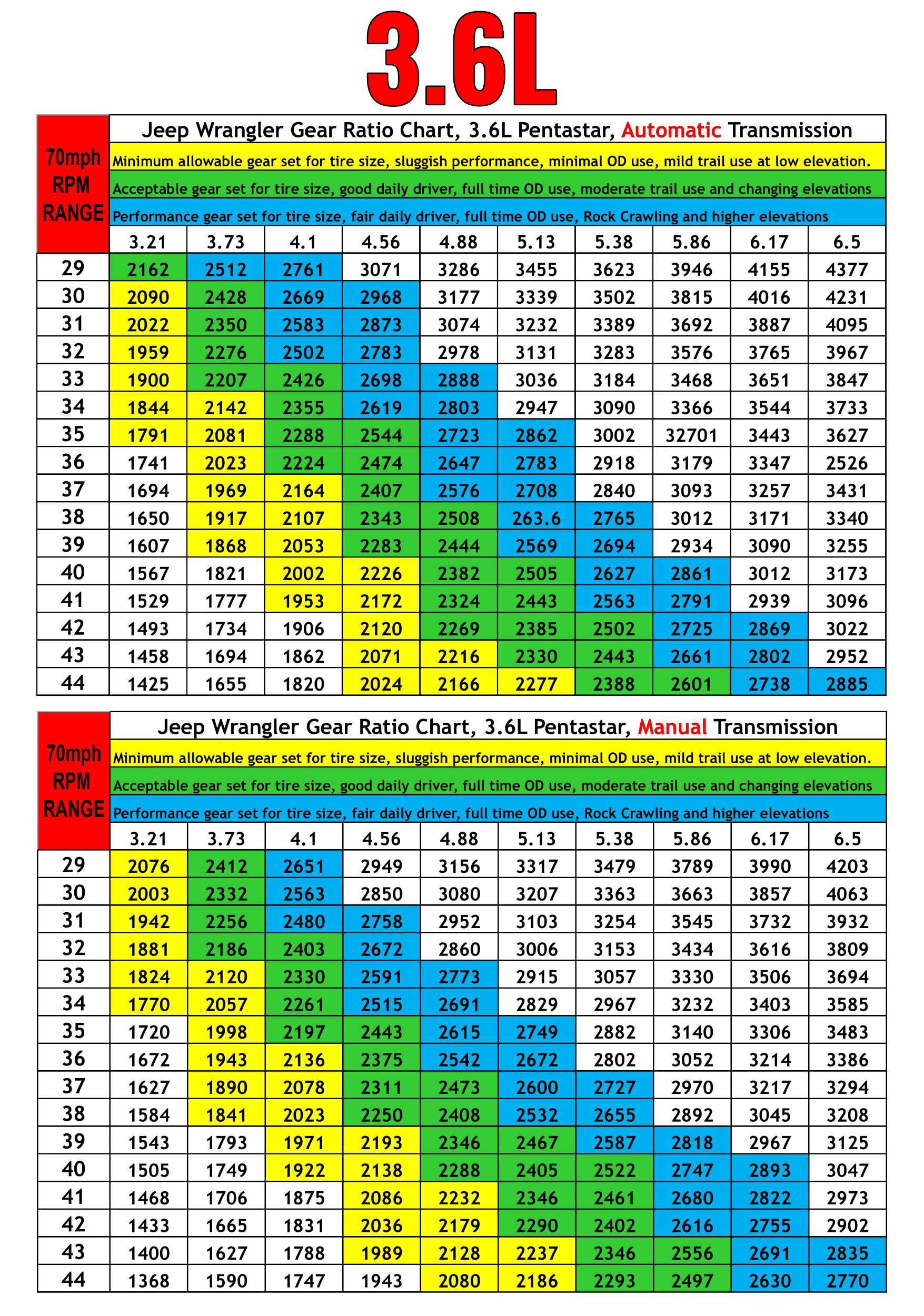

My question is, typically what is the stock gearing on a D44 and since the previous owner had 35's on it and an air locker, would the gearing have also been changed? I know it's probably difficult to guess with just this info but there it is. I looked around on the housing for a tag or anything to find out what gearing it had but couldn't locate it.
