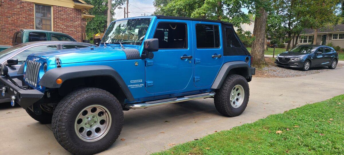

I have a jku 2010 automatic 3.8L 33s on a 2.5in lift
Nice looking Jeep. I'd duck it.
