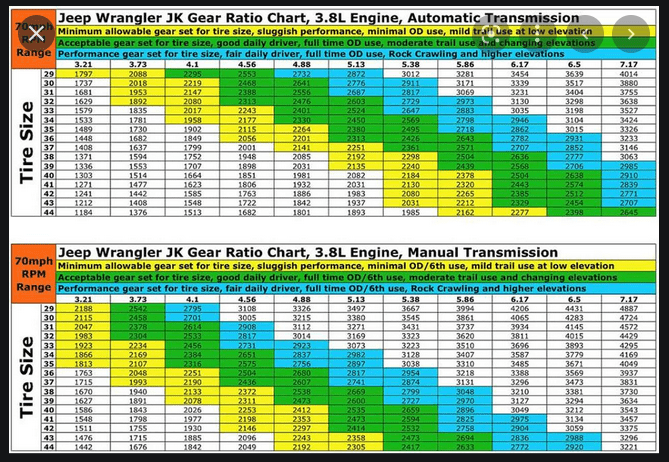

And here's the gear chart I feel like I'm posting about every other day, but use it, please:
I think the other issue that needs to be addressed is using 37s on a daily driver that will see little off-road use. The optimum gear, based on the chart above with a 3.8 auto trans starts at a 5.38. Next up is a 5.86.

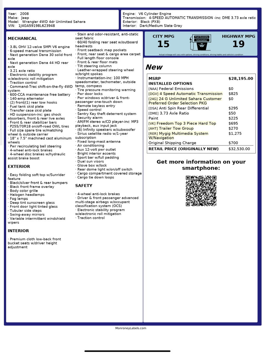

At the moment it’s in the shop but I was able to locate the original factory sticker online which leads me to believe it’s got the 3.73 ratio with the towing package.[/url]

And with a D30, it starts AND ends at 5.38.
That's why I went 35's. 37's are a lot of weight to stick on that axle with that transmission, not to mention the gearing issues.

The sticker lists the base, but look at the right column with all the option upgrades: he's got a 3.73 w/automatic trans among other installed options.

If he's got an automatic 3.8 he'd need 5.38's for 37's though. 4.88 in a manual would be ok, but 4.88 in an automatic would be awful.
I'm running 5.13's for 35's in my '07 and stayed away from 37's due to the gearing required in a 3.8 auto for that size tire.

I have no experience with the 3.8, but looking at this chart, there's no way I'd put 37s on this vehicle unless I was using it off-road more than a DD. Even then, I'd be looking at a Dana 44 swap.
