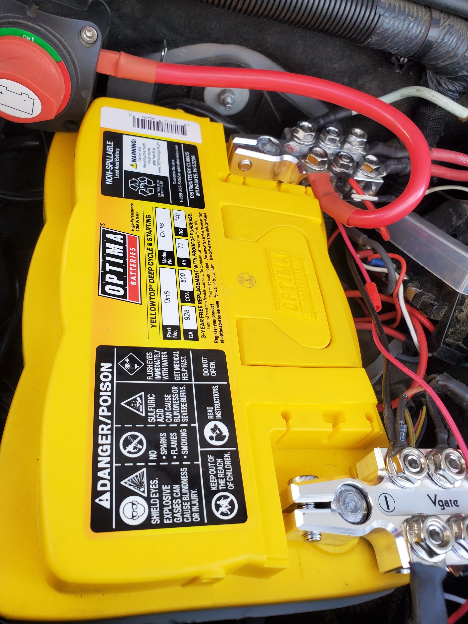

The terminals and cables are connected together. This is the setup I went with. VGate terminals and I bought a lug crimping set to put new lugs on the ends of the cables. Knock on wood...I've had zero issues with weird electrical issues since.
You can also put dielectric grease on the terminals when bolting them down to help with corrosion.
