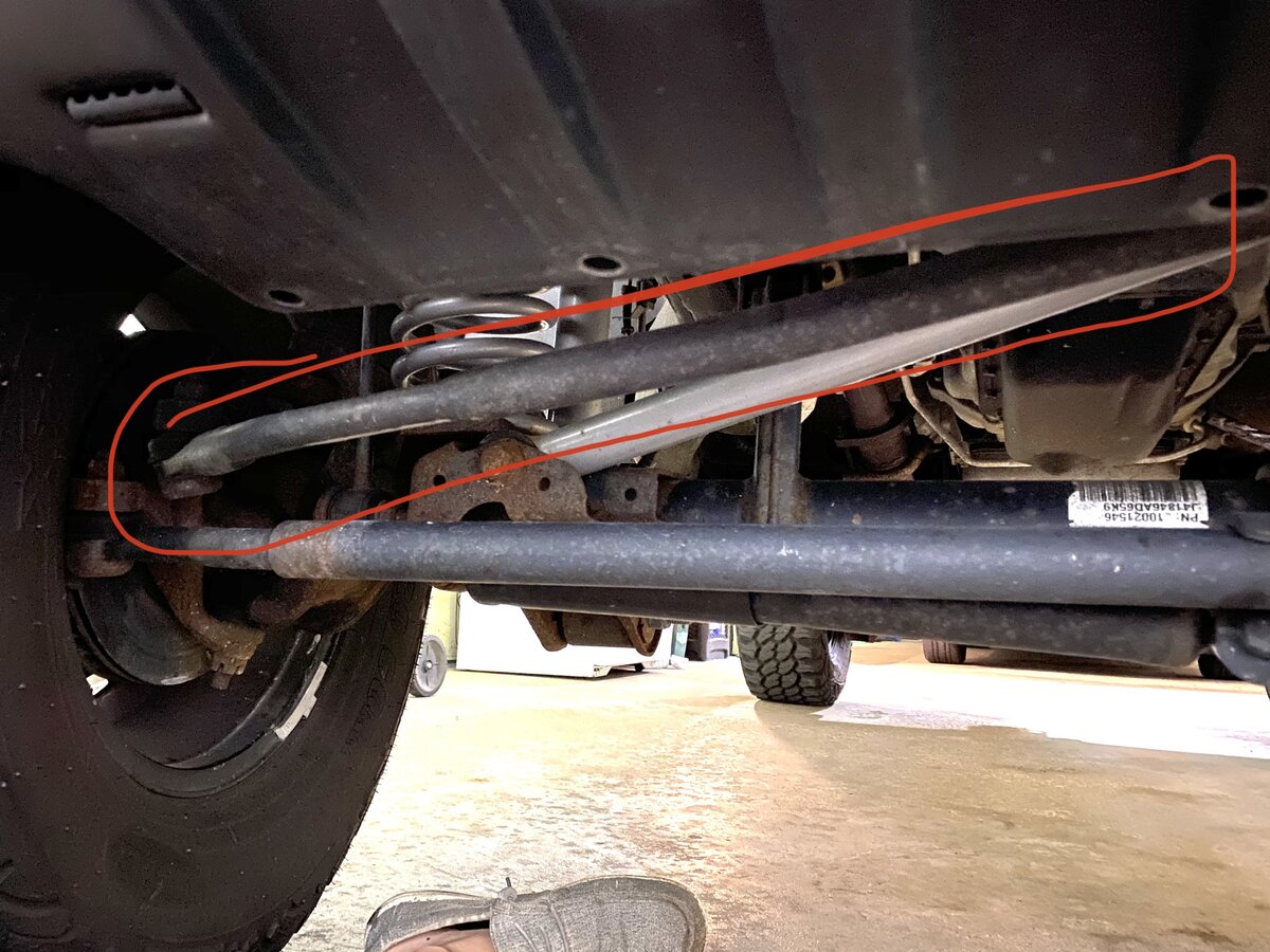

so my drag link is loose. It moves, I'd say ..... About 5 degrees either way. I can twist it, it doesn't move side to side. Is this normal?
There are ball joints on both ends, so yes you can move roll it on the joint (Cheech & Chong would snicker at that).
If it seems excessive, I can't tell by description. If it seems overly to you, it may be worth getting a torque wrench and making sure all your ball joints are torqued to spec on the knuckle and pitman arm ends. If you're doing it, I'd check all of them personally.
