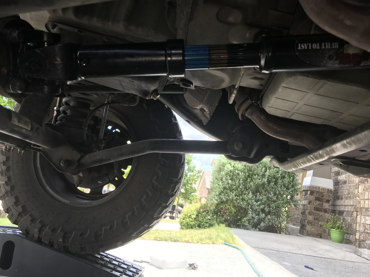

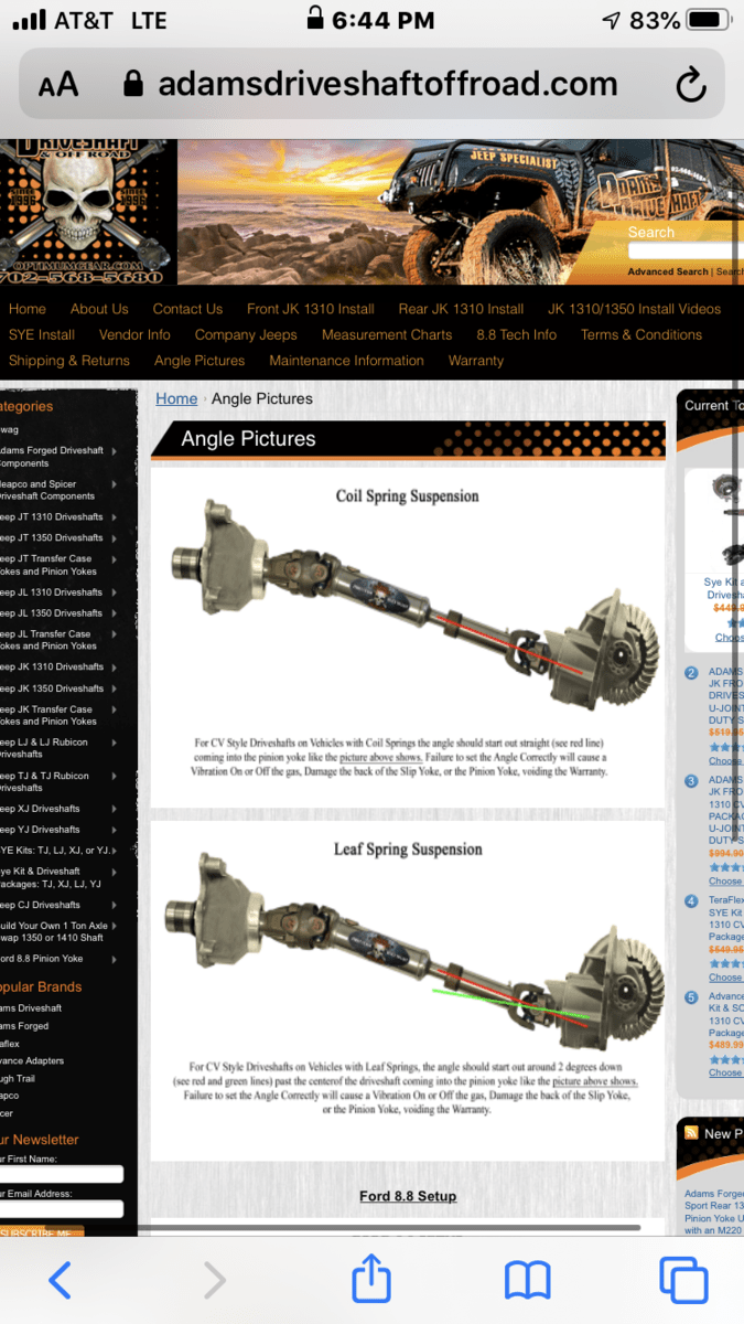

I just installed an Adams 1310 front driveshaft and was seeing that they wanted the pinion angle adjusted according to the image I attached below. The lift kit I had installed a few years ago did not come with adjustable control arms just fixed control arms so I was considering purchasing a set of adjustable UCAs, but before I do so I had a couple of questions.
