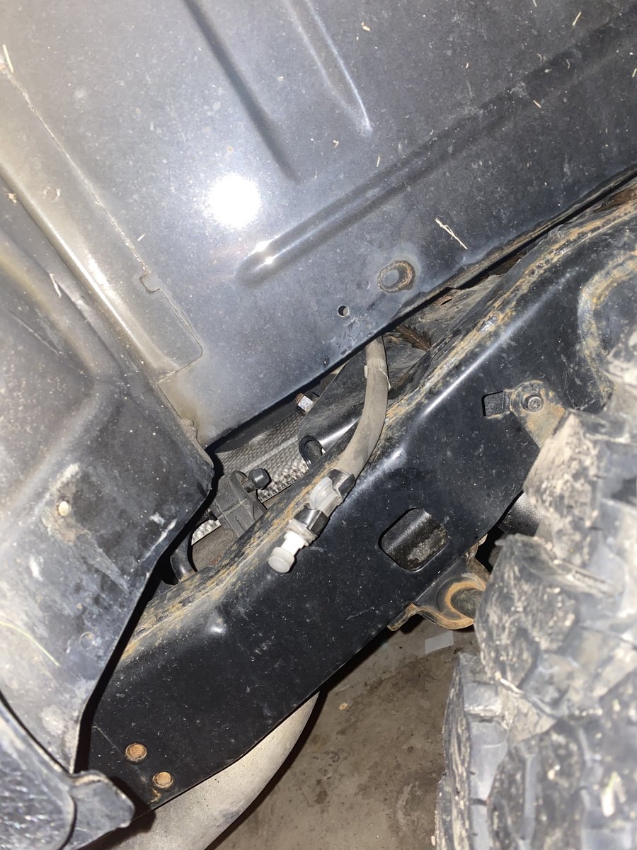

Jackcannon18 New Member Joined Apr 27, 2020 Messages 2 Location Geneva IL Apr 27, 2020 #1 Does anyone know what this is and where is should be?
RubiconFreedom Member Joined Apr 27, 2020 Messages 41 Location North Eastern, Maryland Apr 27, 2020 #2 I'll take a wild guess and say it has something to do with the rear windshield water reservoir. If this vehicle has had a hard top and no longer does then the previous owner disconnected this line and pushed it back through the fender well.

BLACKJKU Moderator Staff Member Lifetime Supporting Member Joined Feb 22, 2020 Messages 5,123 Location Huntington In Apr 27, 2020 #3 That looks like the vent hose for the rear diff, it just needs to be clipped on the metal crossover above the rear axle.

Jackcannon18 New Member Joined Apr 27, 2020 Messages 2 Location Geneva IL Apr 27, 2020 #4 BLACKJKU said: That looks like the vent hose for the rear diff, it just needs to be clipped on the metal crossover above the rear axle. Click to expand... That was it thank you so much! Reactions: BLACKJKU

Chris Administrator Staff Member Joined Sep 28, 2015 Messages 32,405 Location Gillette, WY Apr 27, 2020 #5 BLACKJKU said: That looks like the vent hose for the rear diff, it just needs to be clipped on the metal crossover above the rear axle. Click to expand... Correct
