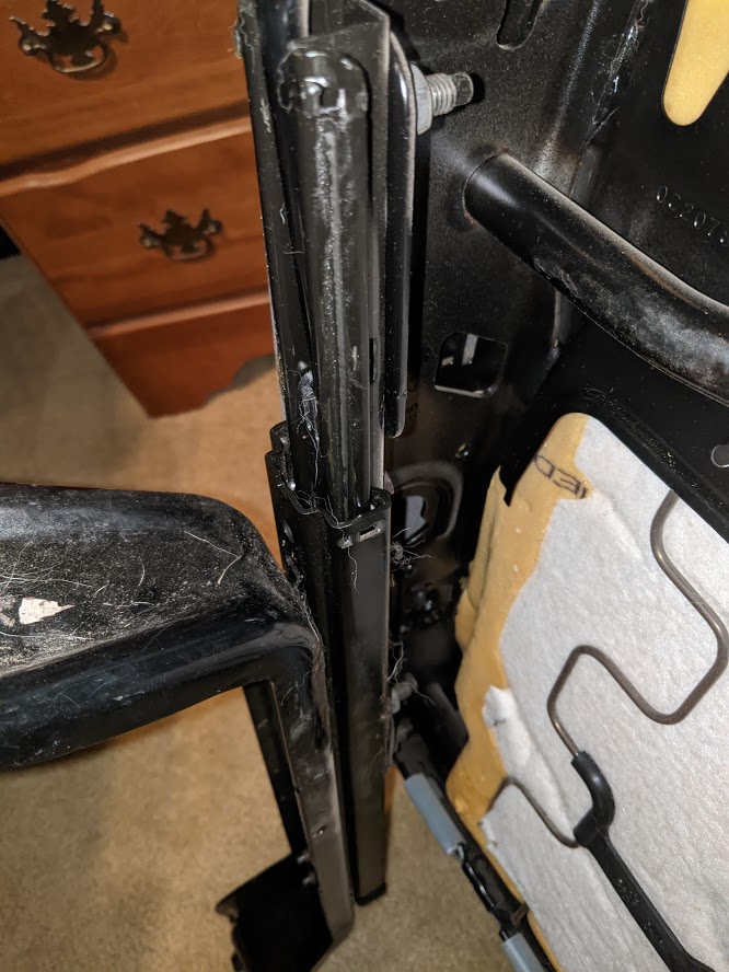

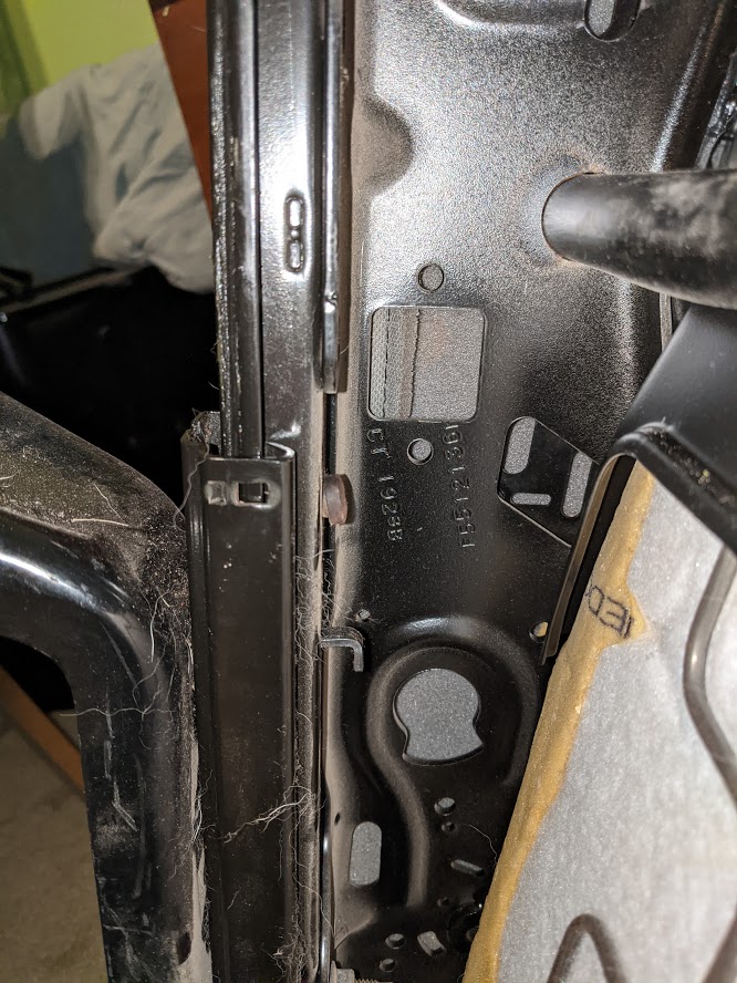

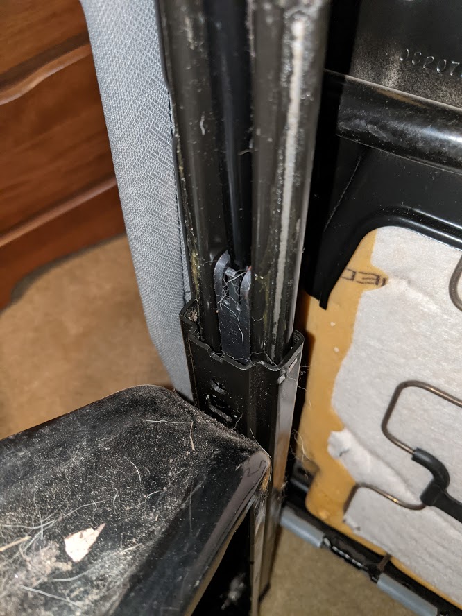

Lucky day, I happen to have the OEM seats for my 2009 in the spare room. However this is out of an Unlimited, so if you have a two door those are different. This may help though.
after playing around with it, the only thing I can see is that either the spring or springs that pulls the level down is off / broke / missing... or the pegs that lock into the slots are broke off. I'm guessing the springs are off somehow.
The front of the spring is shown in the last picture in the middle of the rail. it holds the lever down.
The second image shows the side view, the hook on the right (top of rail if the seat is properly oriented) is the back side of the spring.
there is a duplicate spring on either rail. I highly suggest taking the seat out if you have not.
