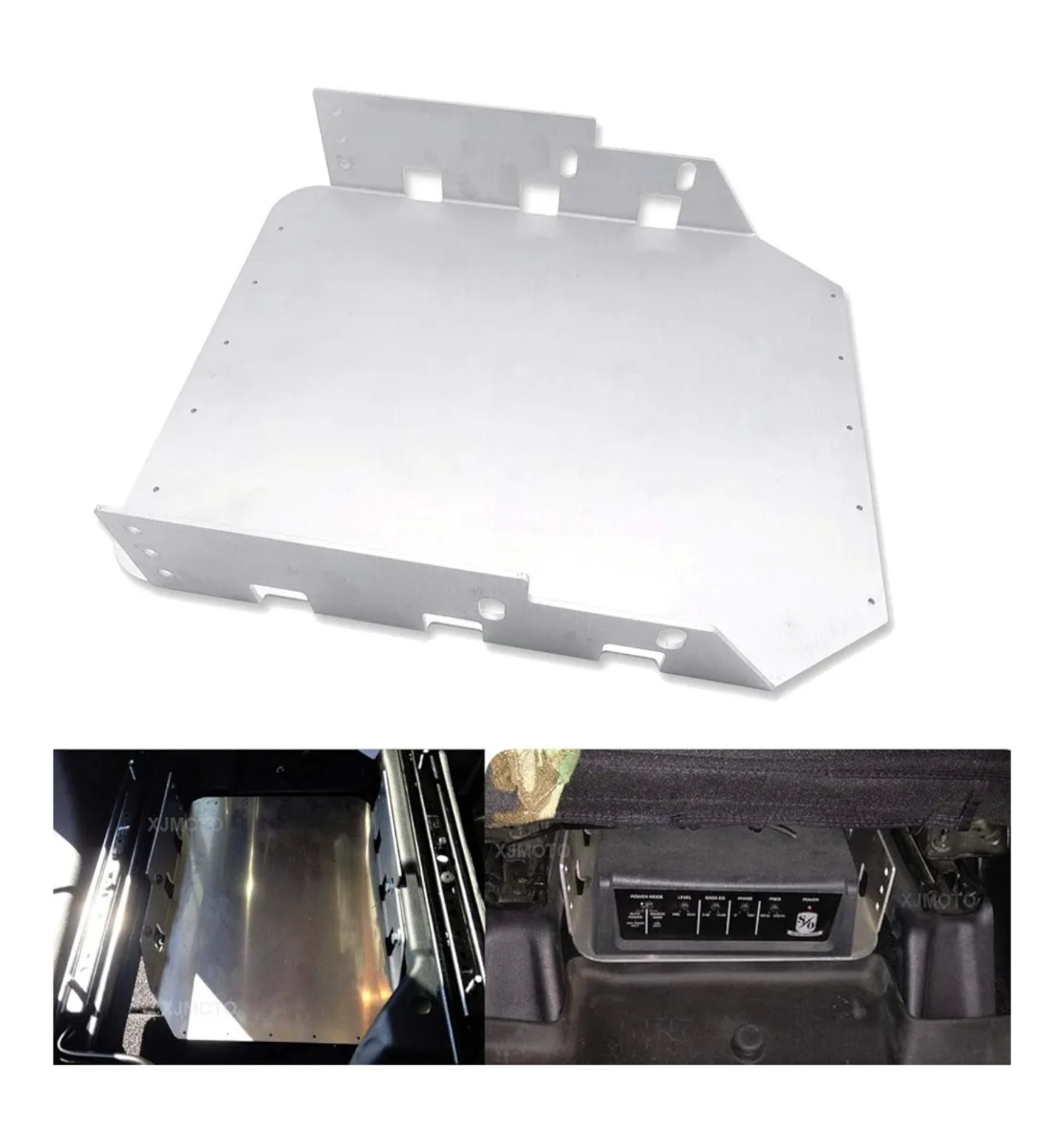

Want to mount a 5000w invertor under the passenger seat of my 2012 JKU. Invertor dimensions 33 x 15 x 9 cm (approximately 13 x 5.9 x 3.5 inches).
I found this bracket on Amazon.
https://www.amazon.com/dp/B07VXNQVFS?tag=jkforum-20
Seems to have decent reviews. I was going to mount it facing to the rear. So I could hide cables and plug into it from behind the passenger seat. Uses might include charging phones, batteries, laptops etc. And someday maybe a fridge in the back or power bank. So facing rearward seemed like a good idea.

Looks solid. I like how it is suspended along the seat rails. As long as you have the dimensions worked out, I would do it. Even if you have to mod a little bit. Any reason why you are going with a 5k inverter?
