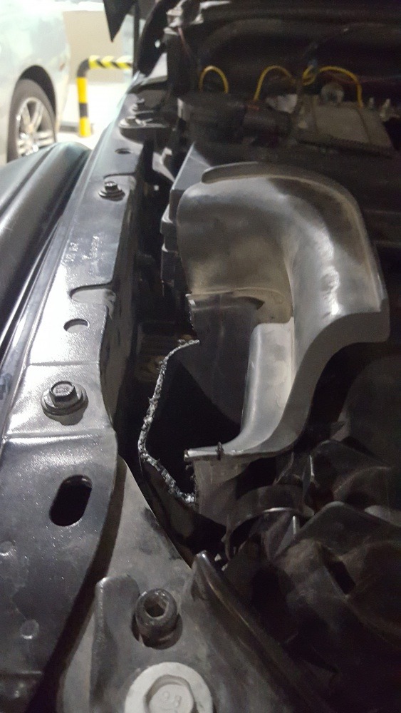

Are you using the stock air box or a CAI, here's the exact same problem and same year as yours. I found this in another Forum he says what the dealer did to fix his problem if your using the stock air box. For some reason the links won't open so what the dealer found out the guy said was the hoodliner was being sucked over the intake on the air box. The picture he showed the Dealer cut down across the front of the opening on the airbox's intake so that it was below the radiator support.

I owe you a beer, that was exactly the issue and I see why now as well. The top hood liner is sagging a bit over time so when I step on the gas hard it sucks the liner down over the small air intake opening since a part of the opening already seals to the hood when it's closed.
Adding the picture from the link you posted here for anyone else who stumbles upon this same issue and this post.
Thank you for the solution to this post! This had been an ongoing problem over the last month. You were spot on, the hood pad is being sucked down over the air filter housing inlet under heavy acceleration. Removed hood pad as a test and problem no longer occurs.
