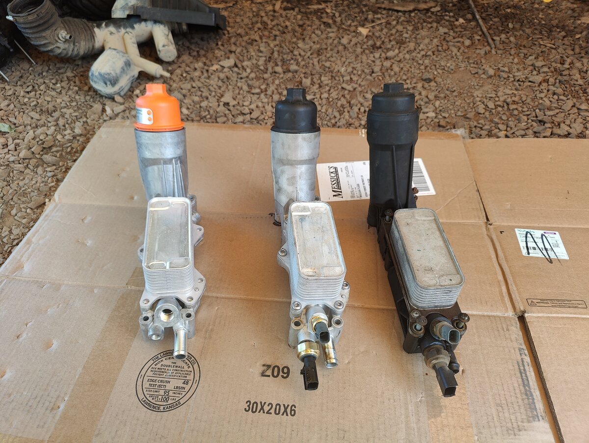

<blockquote data-quote="khutjomad" data-source="post: 461263" data-attributes="member: 25595"><p>Happy JK 2012 driver after major oil system upgrade and repair. Fitted Aluminum cooler, came with new sensors, oil filter and fitted like a glove. Then Po66d remained present. Next step was the solenoid. Ordered the doorman one on eBay, Went down under and removed the sumps and replaced the oil pump solenoid. Problem solved. Can now rev past 3000rpm and all the engine protection restrictions are gone and the truck growls past 3000 rpm with ease!! Did all the work from the front of my garage. Total spend: R5000 (about $220) including new oil. Dealer qoute to fix the problem: R15,600.00. <img class="smilie smilie--emoji" loading="lazy" alt="😉" title="Winking face :wink:" src="https://cdn.jsdelivr.net/joypixels/assets/8.0/png/unicode/64/1f609.png" data-shortname=":wink:" /></p></blockquote><p></p>
