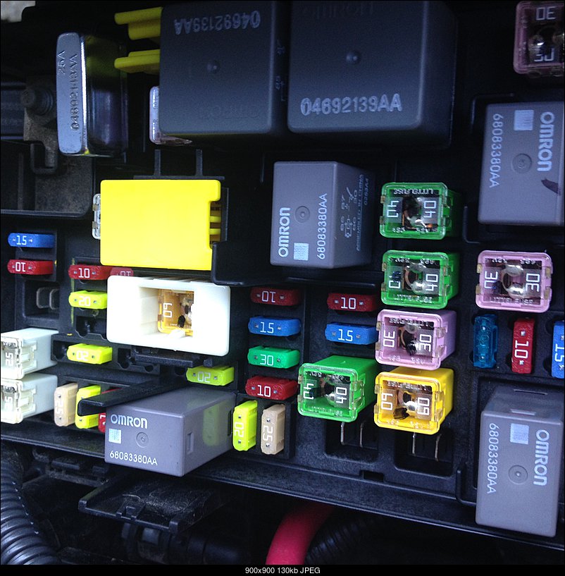

I then went to the cooling fan relay (J19), which the location of is not listed in the owners manual. It IS listed on the TIPM cover in the engine bay. In the picture, it is the pink relay with the 30 on it that is in between the yellow and green relay. I checked this for poor connections or corrosion with none noted. Relay was operational.
