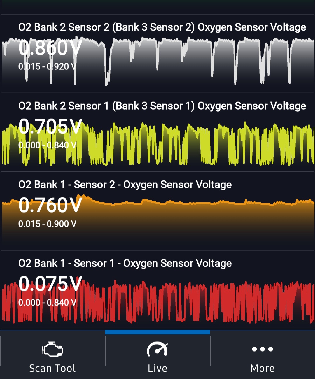

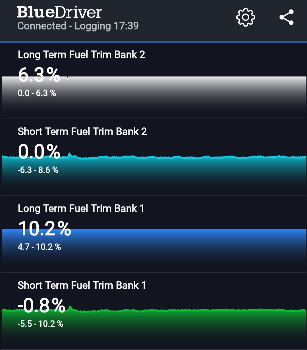

Looking for some experienced members to have a look at my O2 sensor readouts and help me solve P0430.
Recently replaced cracked bank 2 exhaust manifold, trying to determine if I have O2 sensor issues or leaks. I've attached the fuel trims and O2 sensor traces - please let me know if any other info is helpful. If it's cats, so be it... but don't wanna throw parts at this if I don't have to!

I was trying to use the fuel trims and voltage traces to determine whether or not the CATs were plugged or damaged. Based on what I've read, bad or plugged CATs are indicated by upstream and downstream O2 sensors showing similar behaviour (both switching at similar rates). The data I retrieved with the scan isn't clear cut to me. Bank 2 does have some switching but I'm not sure if it's indicative of a CAT issue, as it isn't as frequent as some of the examples I've seen. I'm also a little interested in the LTFT numbers, as they seem a little high.
All that together, with the research I've done, here's where my head is at:
-Tired upstream O2 sensors causing fuel trims that overwhelm the CATs, resulting in the efficiency to fall below threshold;
-Vacuum leak (but not convinced since bank 2 is affected differently than bank 1);
-Another exhaust leak; or
-Actual failed CATs.
I'll start with the ECM reset and see how that goes. Next I'll take BigAL's suggestion and swap the down stream O2 sensor and see if the fault follows. With almost 190 000 km, I'm thinking it might just be time for new O2 sensors anyway, so that's on the table as well.
