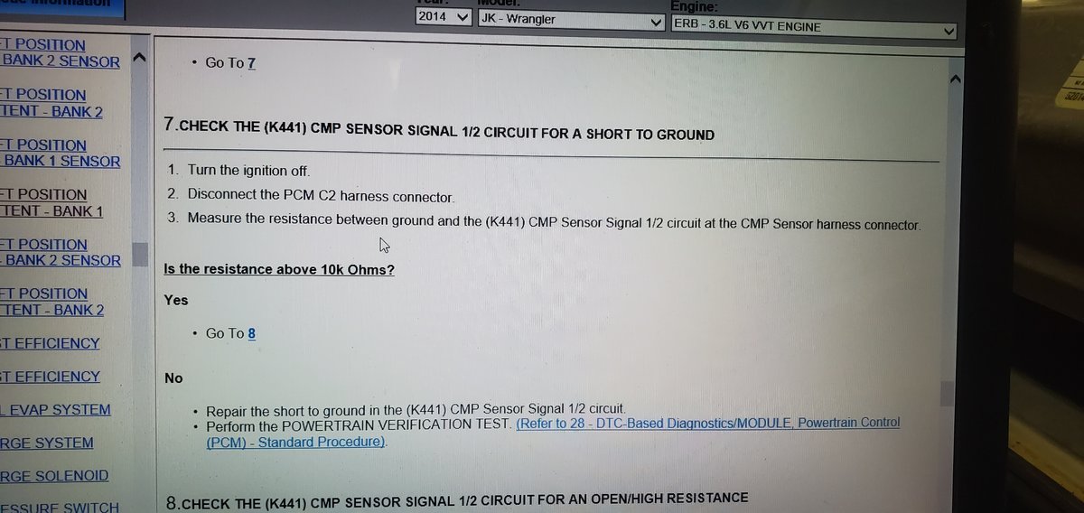

Last spring i replaced the rockers on the passenger side of the engine and code p0369 came up so i tried replacing sensor camshaft checked wiring and im stumped anyone give any insight thanks.

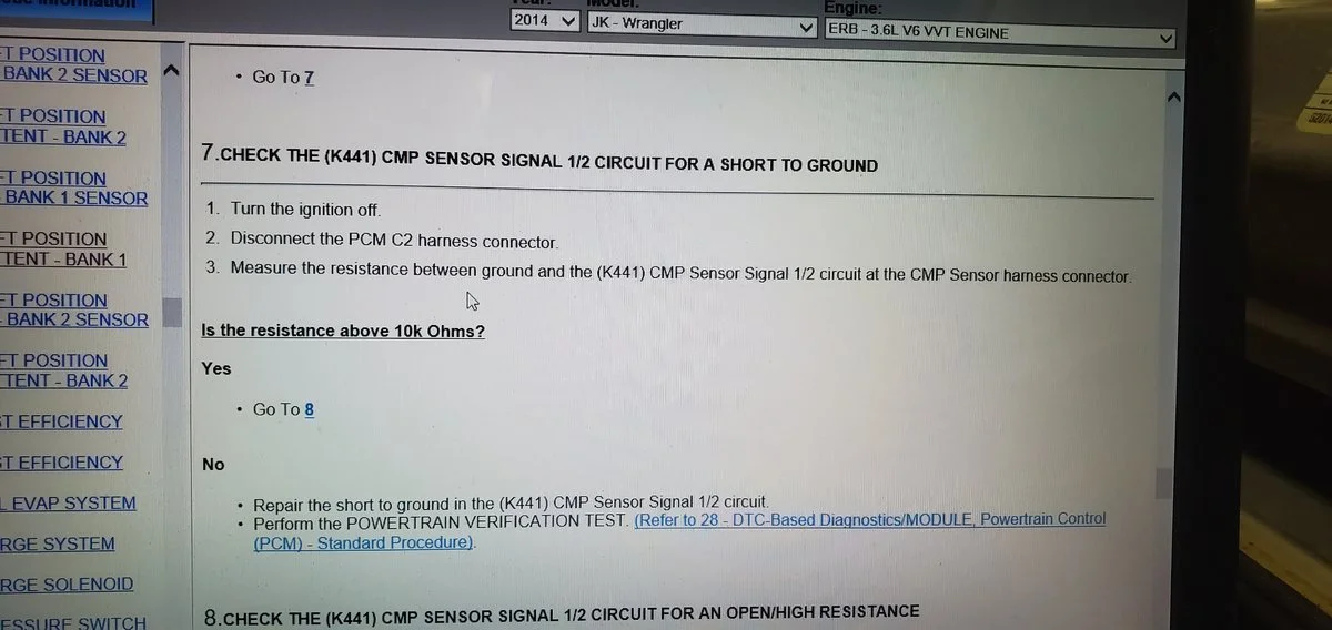

I have replaced sensor with OEM and ended up buying a digital manual and did some test it said to do for the code P0369 and when I get to this step I dont have but 5k instead of the desired 10k
