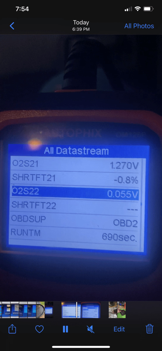

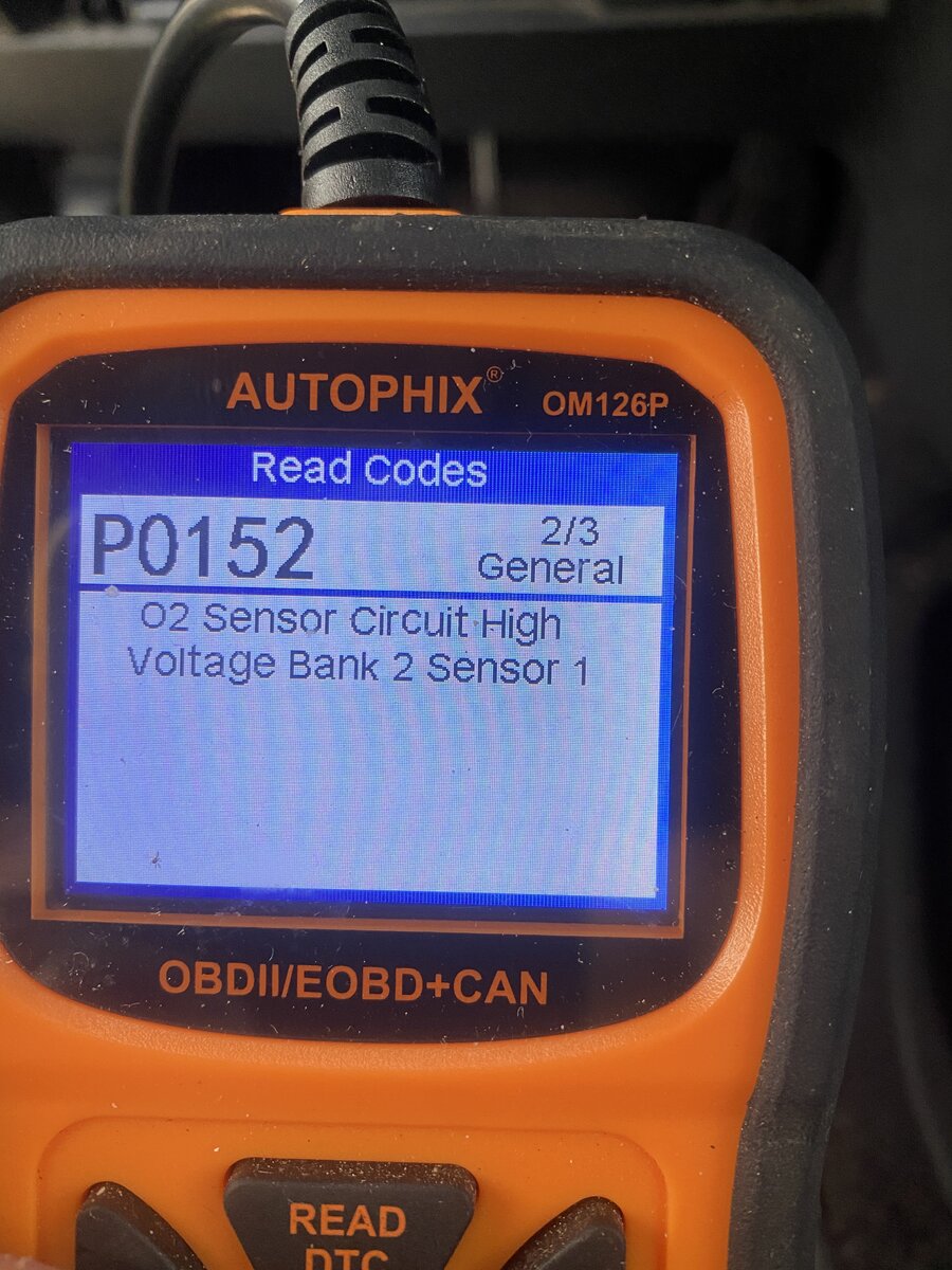

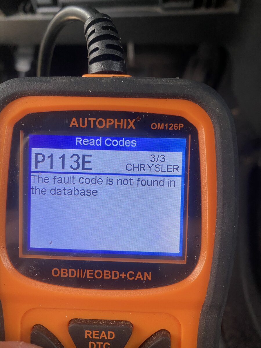

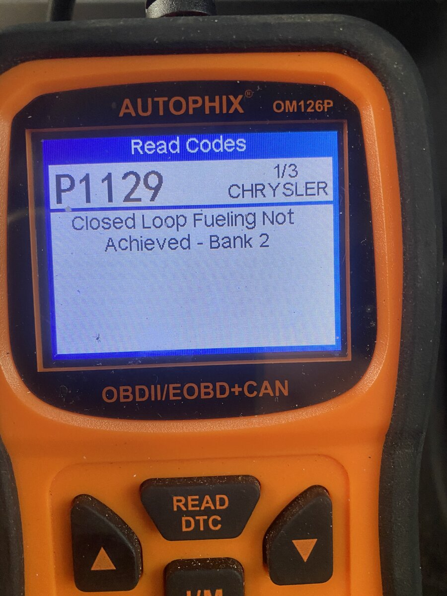

I am new to the forum so I hope this looks right. I have 3 different codes popping at once P0153, P113e and P1129. Also had an engine miss. I changed the bank 2 02 sensor, driver side upper, the miss went away but still popping the 3 codes. Pretty new at reading a scan tool but it looks like the bank 2/1 O2 sensor is pegged out at 1.270v. Any help would be greatly appreciated.
Changed it out. It’s reading at 1.240v and doesn’t vary. I am guessing I have something going on with the writing. A short somehow.
Yep, I'd be looking at the wiring very thoroughly. This is usually one of the last places people look, but it's one of those things that happens more often than not. All it takes is a little break in the wiring somewhere.
