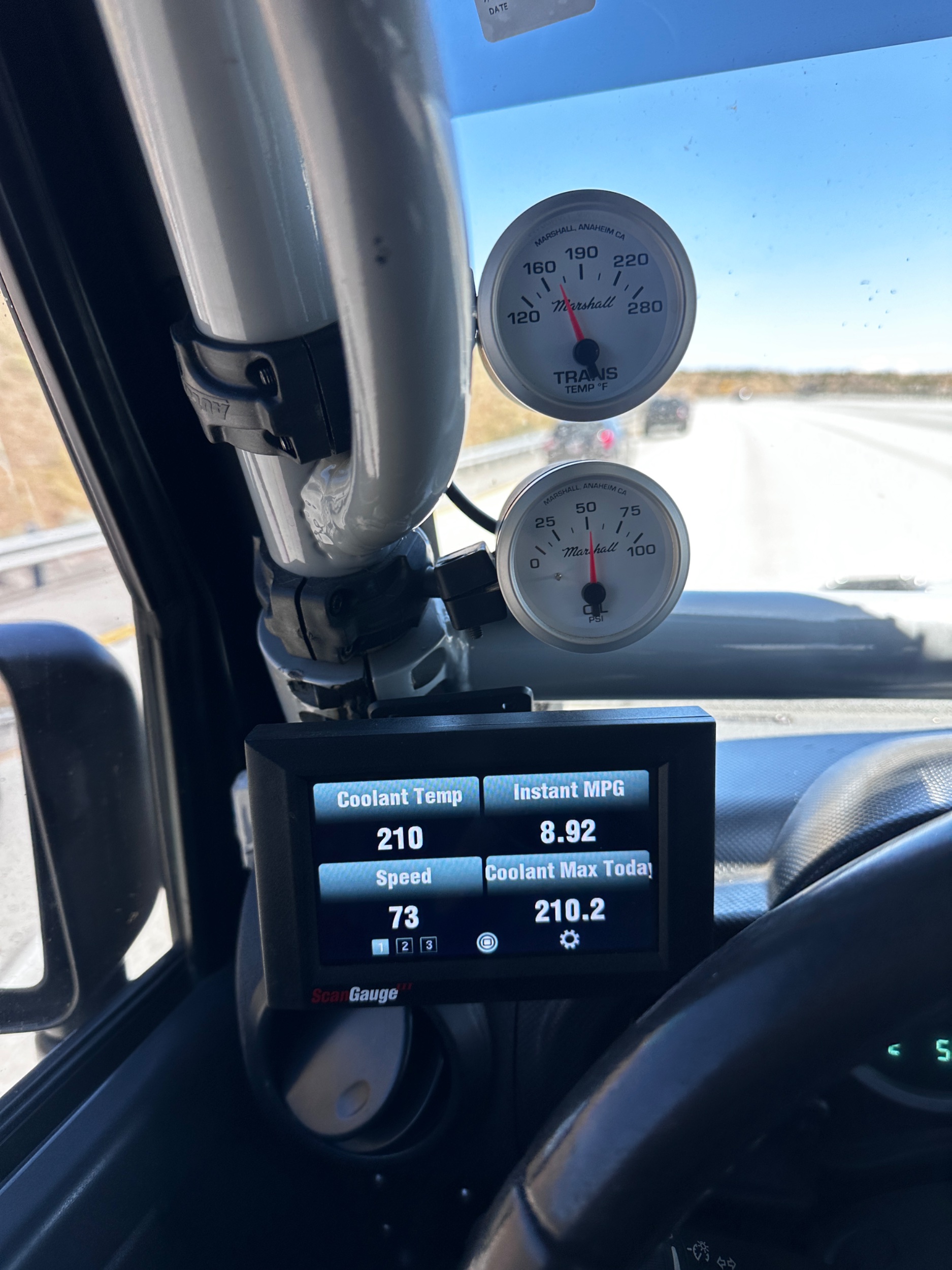

Looking for some real world info on hemi's stuffed in JKU's. I am still having a heat soak or air flow problem. I have a Ron Davis radiator system with twin 12" spal fans, old style noisy ones. My issue is at highway speeds under load. As soon as I start a grade, the coolant temps rise to 230, when the grade is over (flat or downhill) the temps drop to 190. Trans temp never goes above 190, usually around 170. I am going to seal the bottom of the radiator for more forced air through the grill.
I have removed the inner fender liners for more flow, is this counter intuitive? Will this make the problem worse? Also, do hood louvers work in this situation?
I gotta get this fixed cause it is going to catch me one of these days.

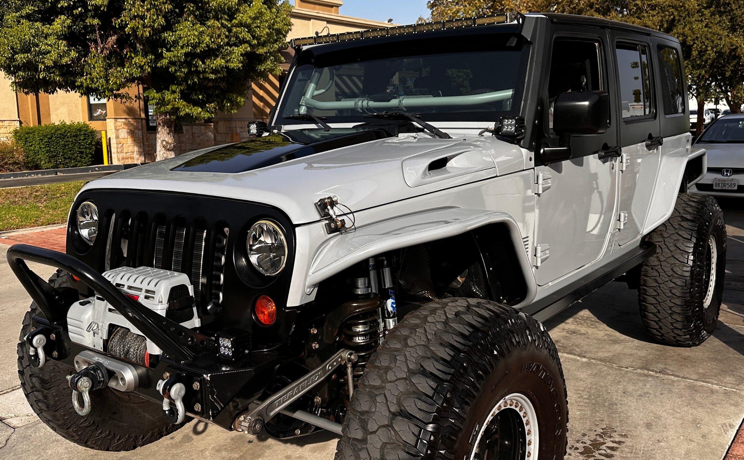

I do have one of those "expensive hoods" but it lacks any useful vents. It has a "cowl induction" type setup but the hemi runs a K&N type, so the cowl system is not used. It is a "GR8tops" brand as far as I can find.

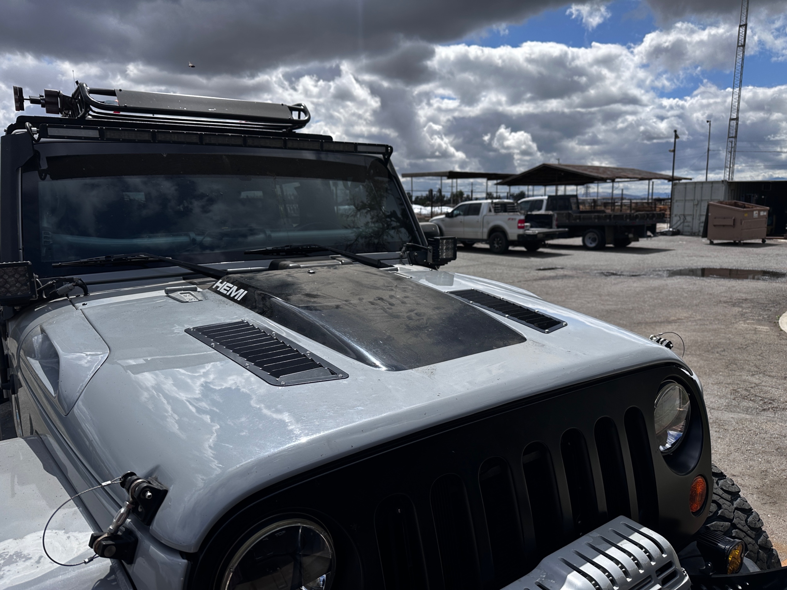

My hood has vents in the top on each side of the center.
