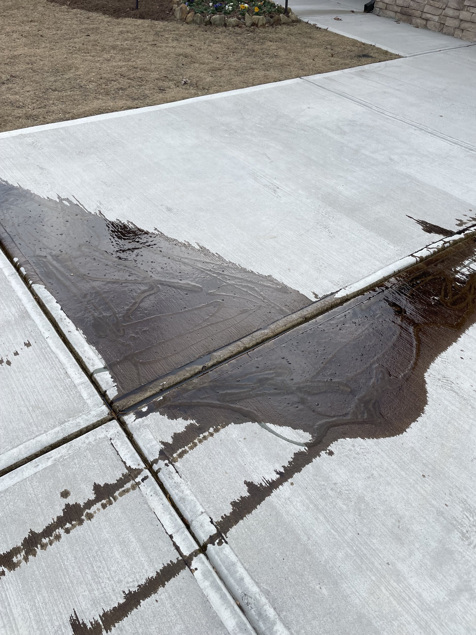

One minute I have oil and the next I don’t. No leak until I pulled out of the garage and not a drop in garage and the next thing I know engine light on and oil is ALL over my driveway. What could have happened?
Roughly 4,685,324 things could have happened. You'll need to start by crawling under it and looking to see where the oil is coming from. If it's splashed all over, clean it off and have someone pour a bit more in while you lie underneath it and look.One minute I have oil and the next I don’t. No leak until I pulled out of the garage and not a drop in garage and the next thing I know engine light on and oil is ALL over my driveway. What could have happened?
Wow. The only time I've experienced something like that was when a bolt came off (internally) on a 2006 Fusion transmission. It got knocked around and quickly ventilated the case dumping all the trans fluid on my driveway.
Sounds like it is the oil cooler /filter housing. They are made of plastic and seem to have a limited lifespan. If you look on YouTube there are many videos talking about this problem and the repair. There is an aftermarket version made out of aluminum that seems to be a better choice. You are fortunate your engine did not get damaged from running while low on oil.I was told it is a cracked oil assembly which gonna cost $1200. Really can’t afford this bill right now but better blowing up my whole engine. Trying to be positive about the situation.
What is your model year and mileage?I was told it is a cracked oil assembly which gonna cost $1200. Really can’t afford this bill right now but better blowing up my whole engine. Trying to be positive about the situation.
