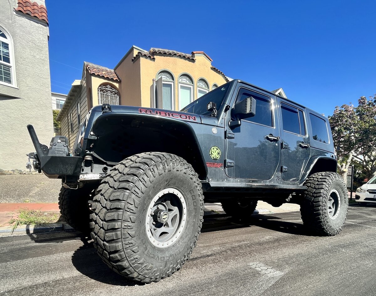

I have a 2007 JKU. My full doors have automatic windows and door locks. I just came across a set of half doors from a 2013 JK that have electric door lock and mirrors. From everything I have read, the doors should fit just fine. The interior will be a different "design" than what I currently have but should work fine. My only question is regarding the wiring.

For this JKU:
