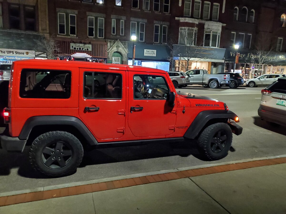

So in the quest of looking for tires to run on my recently purchased 17 big bear unlimited I stumbled across Kenda Klever Rt in a 33x10.50 17 and was wondering if these would work with a budget boost lift 1.5" to 2" lift on stock wheels with no spacers. The price is right at 149.00 a tire.
So in the quest of looking for tires to run on my recently purchased 17 big bear unlimited I stumbled across Kenda Klever Rt in a 33x10.50 17 and was wondering if these would work with a budget boost lift 1.5" to 2" lift on stock wheels with no spacers. The price is right at 149.00 a tire. View attachment 120162
What size tires are on it now?
According to this they are just a little over a 1" taller and close to the same width. Shouldn't have any issues anywhere except for maybe recalibrating your speedometer.
That's what I was hoping for. I like my stock wheels and didn't want to do spacers. I was planning on the RC 1.75 Budget boost with the shocks. I think I can go it for under 1k which I'd call a win.
