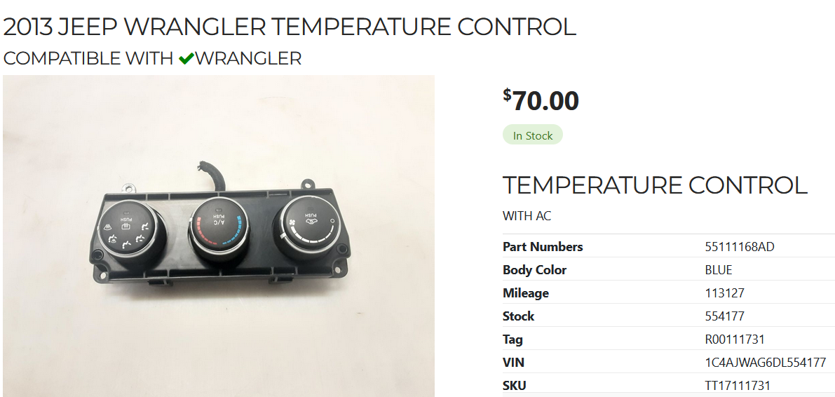

Thanks for the suggestion. Didn't occur to me... duh! Checking Mopar for replacements. Thanks again. and Thank you for your service!
https://baseline4x4.com/parts/JEEP/WRANGLER/554177/2013/TEMP_CONTROL/111731/

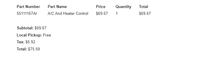

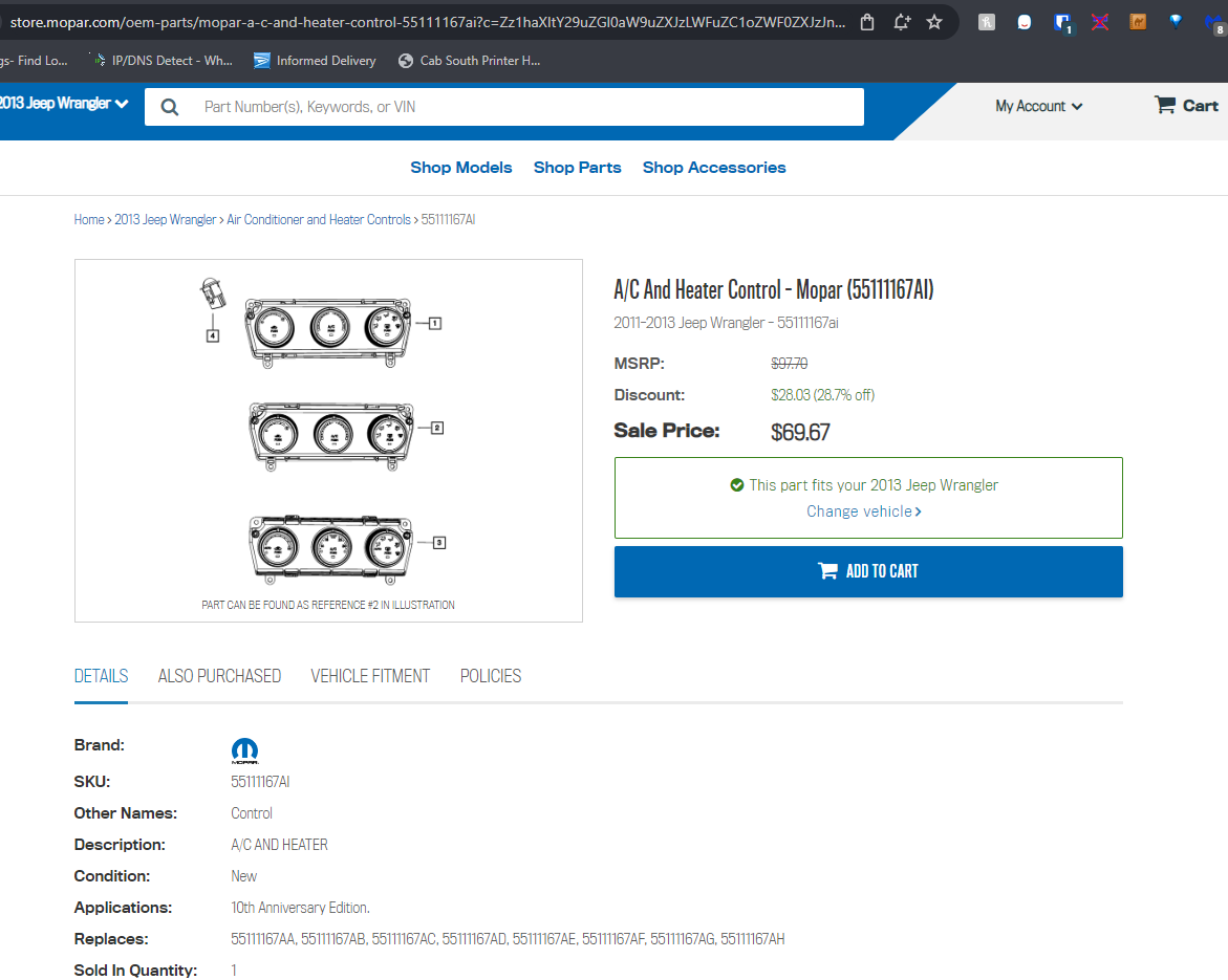

Thank you. I actually found a local dealer with a new one for $69. Driving there this week to get it. But it's a different part number but I think it will still work. what do you think?
thanks for the help!

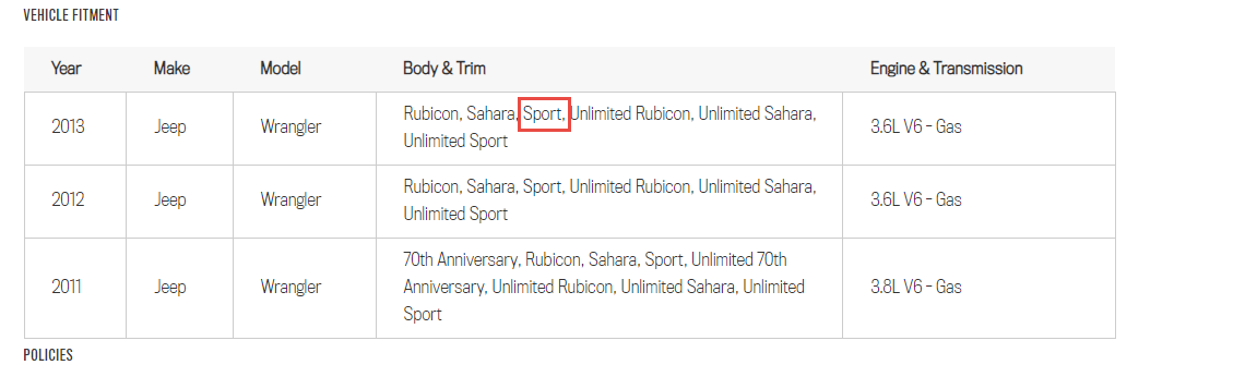

I think they're relatively generic, and the one I attached is actually used. Most of the new ones I saw were well over $100, so good on ya for finding a new one that cheap!
The one I attached, after checking the VIN, came off a 2013 Sport, auto with the 3.6.
Well, resurfacing my issue. The item I originally purchased did not have the option for the rear defrosters which is why it as so cheap. So I purchased the correct one, replaced it and the problem persists.
