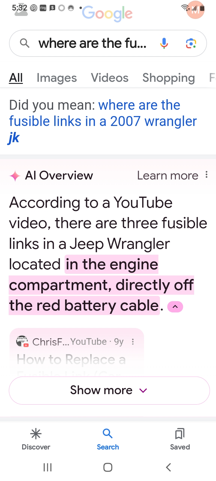

Did you try unplugging and plugging all the fusible links..there are a few of them I'm not talking about fuses these look like a wire with a small plastic block and all you do is unplug it there are 3 of them just off the positive battery cable.give me a minute i try too send you a picture or video link
The images I'm trying too pull up are not good... Google fusible link locations on 2007 wrangler
