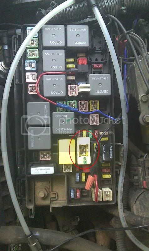

Hi guys just wondering if it’s possible to turn off the No Fuse warning on the dash with the JScan tool and tips, links on how to do it would be really appreciated. Cheers Steve.
PS I’ve checked all my fuses.
I don't believe JScan can turn that off. I've heard of a few people reseting the IOD (Ignition Off Draw) Fuse (circled in red in the pic) to get rid of the error.
(not my pic)
