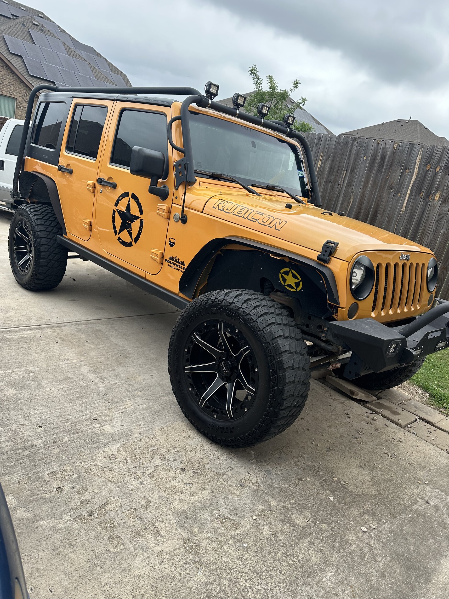

Bout this 2012 on Monday and working on cleaning it up, tune up, etc. had oil changed today and discovered it had now cabin ac filter…glovebox super dirty when removed. Put a new filter in and then the the Jeep overheated about 15 min later - all the way to red line. Pulled the filter out and heat came down some. Anyone else experience anything like this?
