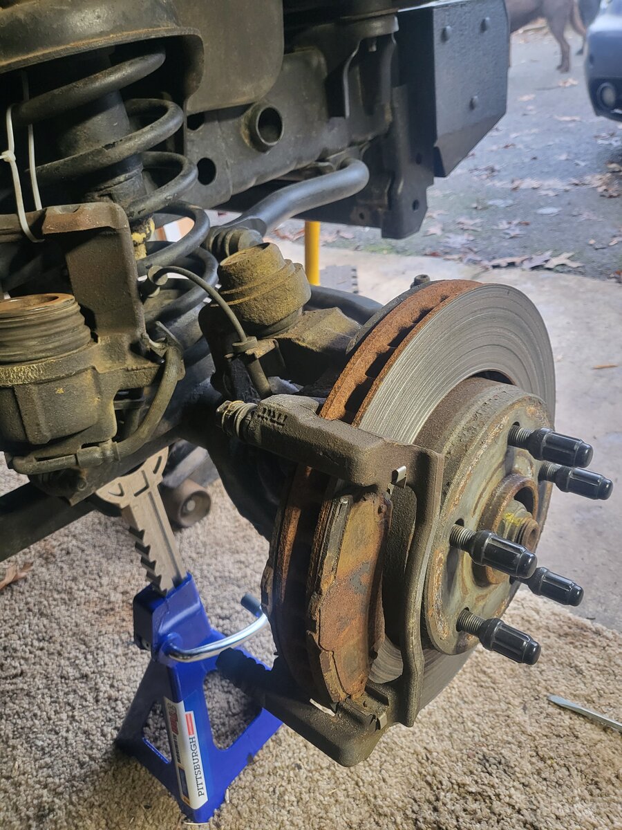

I always shudder when I sign a form that says "AS IS". Oh come on it's a used car, they wouldn't lie. I only got to drive it for a few miles, took it on the highway up to 80mph, no wobble, one of the cleanest drives of the ones I tested. So let's give it a run, up the mountain I go. thought I smelled a little coolant but gauge was steady. On the way back I thought i heard a scraping in the brakes, must be some cinder in there from the roads.....oh hum what could it be?...so now the real truth. The right front caliper was defective causing the pad to stick and had ruined the rotor. The ECT (engine coolant temp) sensor was defective and the ECM had no clue what the temp was. This is where most would have buyers remorse I guess. But I am a jeeper for life....here we go again

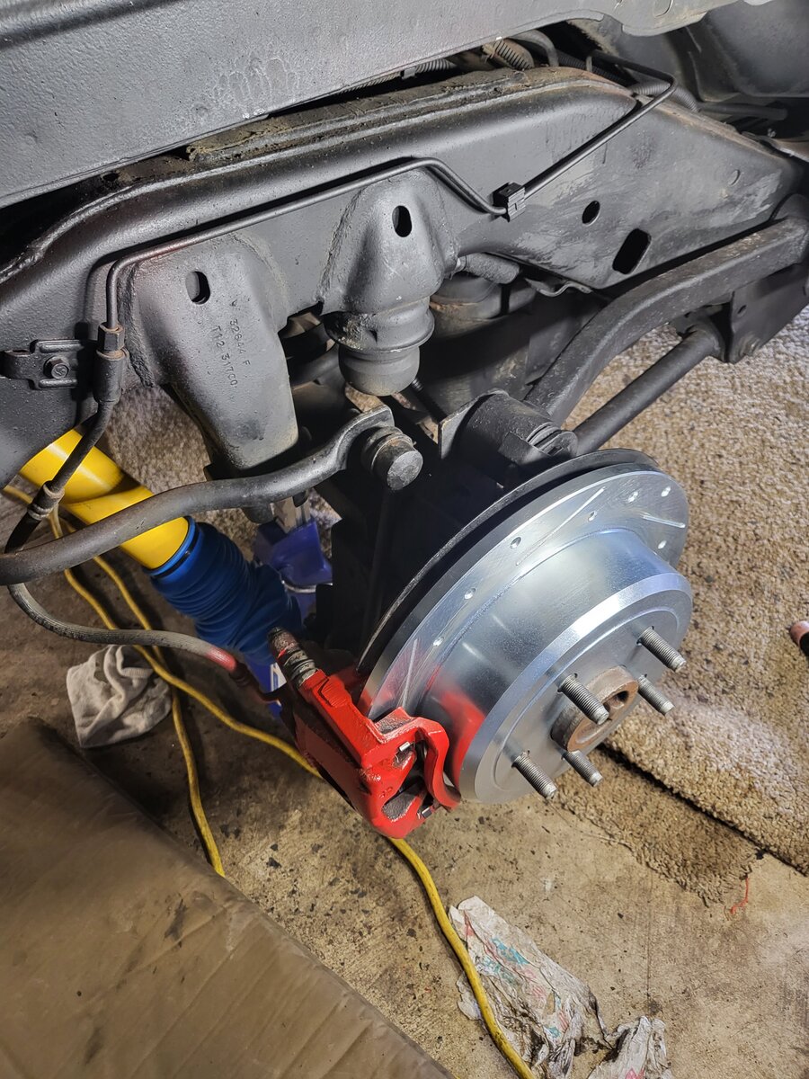

Got it home, up on the stands. Okay let's tear into it. Yep right front rotor toast. Got j-scan, yep temp sensor is not reading. Fine, was going to upgrade a few parts anyway....mumble mumble...OK got some detroit-axle parts coming. Replaced the bad rotor, might as well pretty them up with some caliper paint. Also added some bilstein shocks plus front stabilizer. Spent 2 days underneath jeep with wire wheel brush, rust reformer. (I am old, this shit just hurts my back). Frame is in great shape. Got it back together and still had some cooling issues. Had to replace thermostat and radiator cap to finally get it to work correctly.....(hint: there is a error with the new installation: my son spotted it)

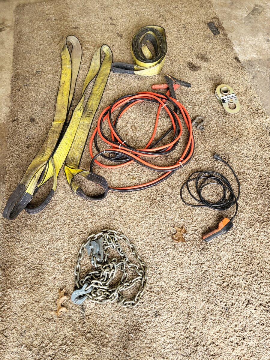

Let's roll. Got it up and running and feel like it's a bit more reliable. So off to the trails. Lot's of snow and wet weather here in Oregon. Trying to get up back side of Marys Peak had a bit of slipping. Then a huge tree had uprooted in the wet soil and caused us to ponder. I wonder if this happens to all jeep owners at one point. "Over it or remove it?" With a jeep nothing is impossible. But no chainsaw or desire to go farther just to find another downed tree. Installed a winch and started to gather for a recovery bag. So I am up and running and will be jeeping mostly the west coast. Planning to be down on the Mojave desert in March. Cya out there ! ham radio - N7MLV
