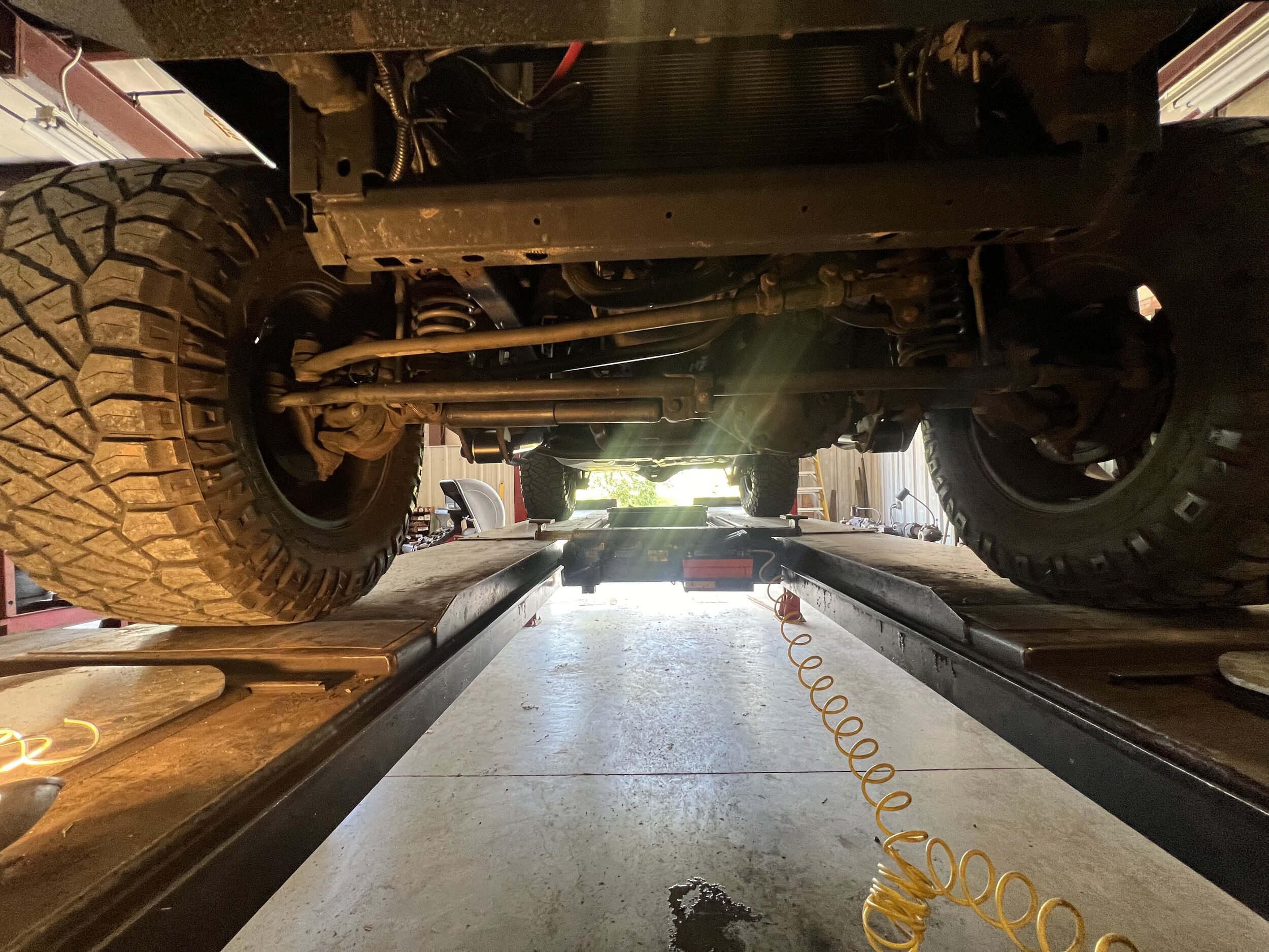

I bought a 2015 JK little over a week ago. I have since taken it to 4 mechanics and still having issues.
It was driven rough (not death wobble) I took to have the oversized offset fuel wheels balanced, rotated and an alignment. I was told one issues was the wheels had a type of washers someone should have known not to use and they fixed that. Also, they said whoever did the brakes should have known that the wheels couldn’t be put on like that.
I actually drove it from that mechanic just a few miles to another one to get new control arms on to tighten the steering. When I picked it up from getting the control arms I noticed a grinding/vibration when accelerating only at 2500 rpm’s going first to second gear and that was it.

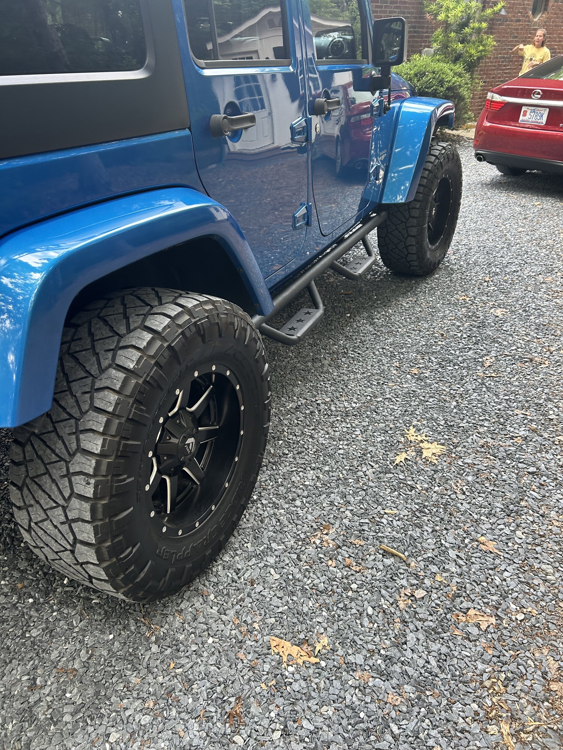

If your Jeep is all over the road and you have 35's then i'll bet they have to much air in them, do the chalk test and lower the air pressure until the tire sits flat on the road.
Does the Jeep have a lift?

There’s a rough country lift on it, and the tire pressure was reduced upon buying it.

How much of a lift is it? Over 2.5 inches you need to have adjustable control arms and adjustable track bars front and rear so the axles are centered under the Jeep.

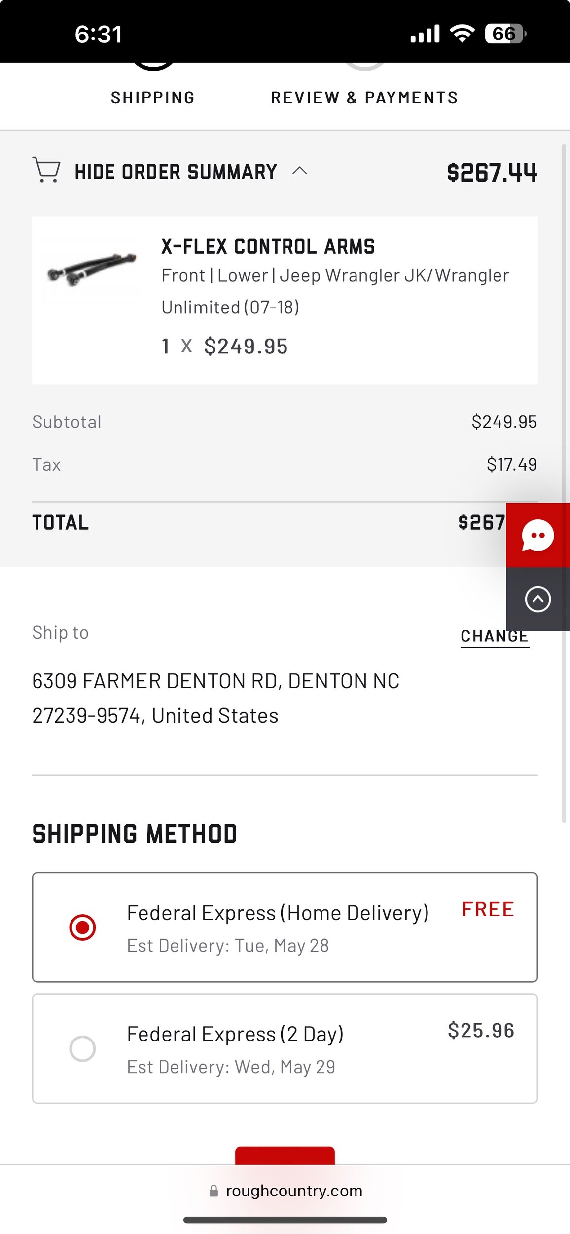

what control arms where put on? Sounds like you have bushings going bad. I would check all bushings, Make sure your tires are not over inflated as BLACKJKU said and post up some pics, that will up us see whats going on.
This is what was put on. I will get a picture up asap
