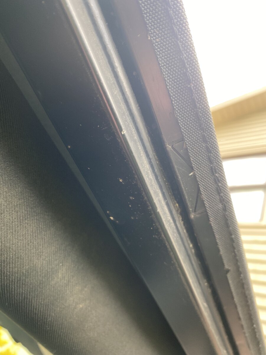

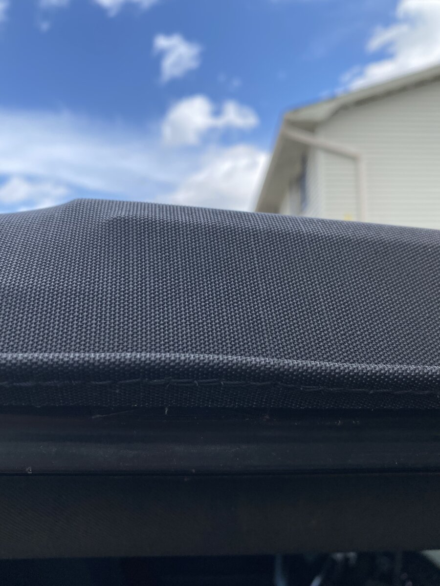

<blockquote data-quote="MacGuyver" data-source="post: 446565" data-attributes="member: 18877"><p>You put the top together or had a shop do it? Where did you get the top? What is the mopar number? </p><p></p><p>If you got a early model soft top that they changed for the 2011 model. Starting that year the front was held down by a hidden cable. Before that, there were the plastic clips or channels into the door surround. These need to be popped out before the top will open.</p></blockquote><p></p>
