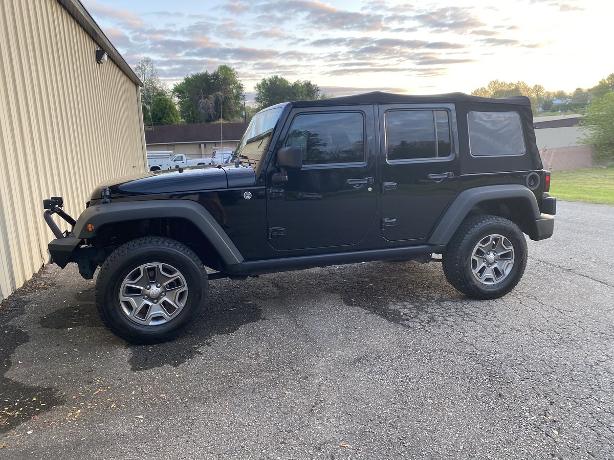

Hey y’all, I’m new to #JeepLife, y’all mind helping me figuring out how much this is lifted, if any?
I can visually look at that and tell you I'm almost certain it's a 2" lift.

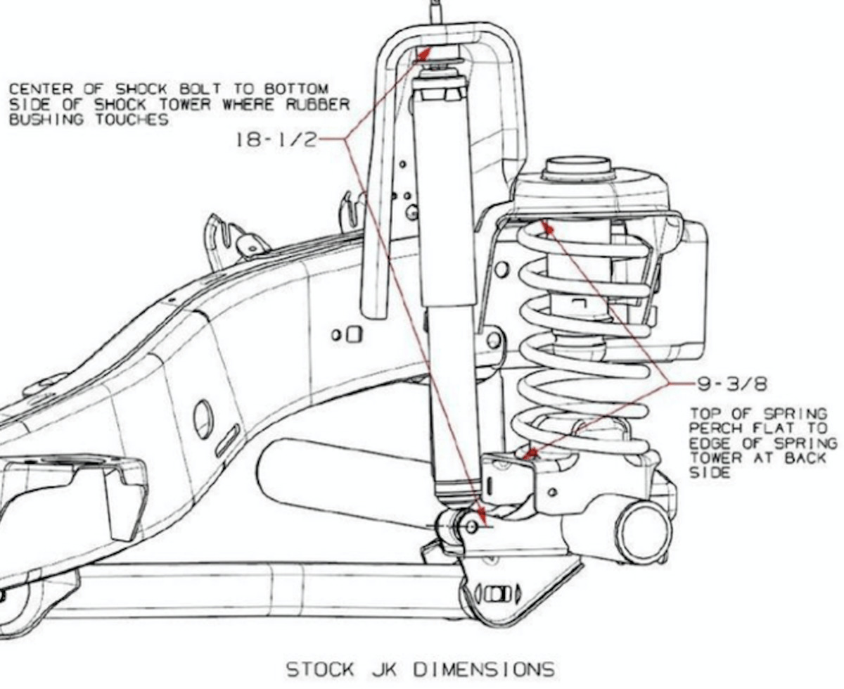

See this diagram though:
Take those measurements. Any additional inches you have on top of those measurements is how much it's lifted.
Being that it is 2” or greater, what size tires could I safely add, without major mechanical changes?
With 2" of lift you ideally want to stay with nothing larger than a 33" tire.
For 35" tires it's suggested to have 3.5" or more of lift.
While you could fit a 35" tire on a 2" lift, you'll lose a substantial amount of up-travel, which will dramatically reduce both the on-road and off-road (especially off-road) performance of your suspension.
