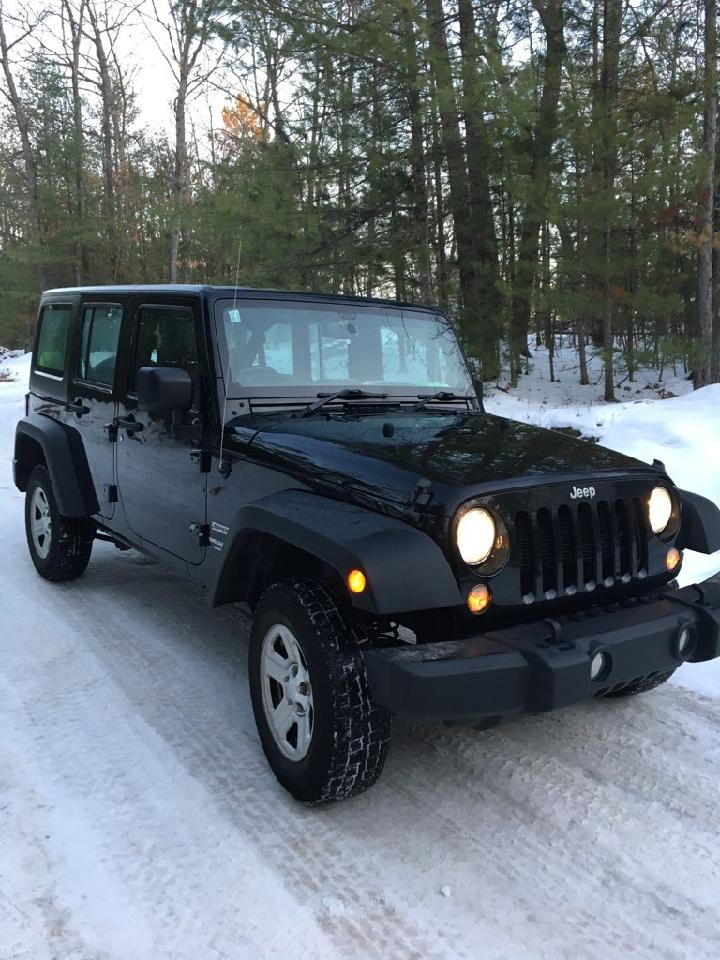

Hello, my wife just picked up a 2014 unlimited right hand drive for mail delivery. It's all stock with 100k miles.
What type of maintenance things do I need to look out for? I'm assuming all fluids need changed.
Front axle ball joints....
She wants a lift of course and big tires. I'm guessing 31" tires are about the biggest you want with stock gears. Which would need no lift.
Are bilstein 5100 still the best shocks for ride quality?
