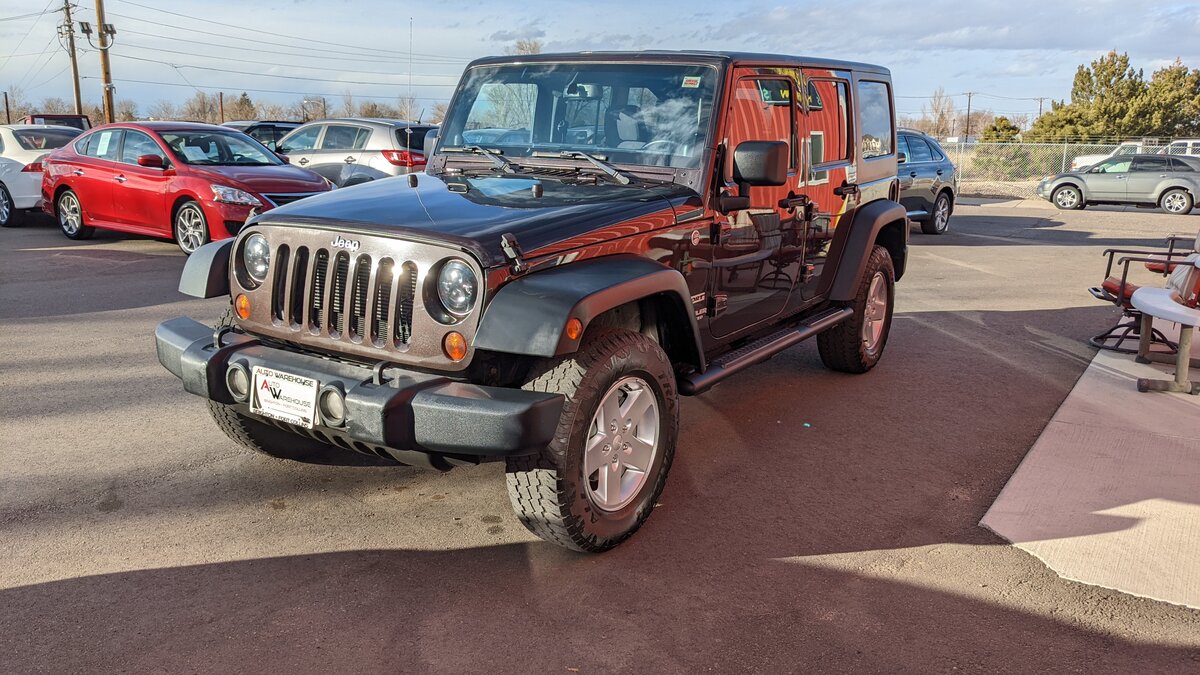

I have a some questions. I previously owned an XJ and man what a difference going to a Wrangler. My questions ...
A: Should I be nervous considering it has 130k because I truly don't know the longevity of these Jeeps? I'm technically the second owner, clean VIN, and in really nice shape. Well maintained.
B: Drove the Jeep home from the dealership from Brighton, Co to southern Colorado Springs roughly 100 miles. It would over heat at highway speeds in cruise control. Dropped it back down to 70ish and the temp stabilized.
Other odds and ends:
Tire pressure sensor front driver side not working, carpet driver side missing (easy to replace?), and should I replace the factory hood latches because I've heard the scary stories.

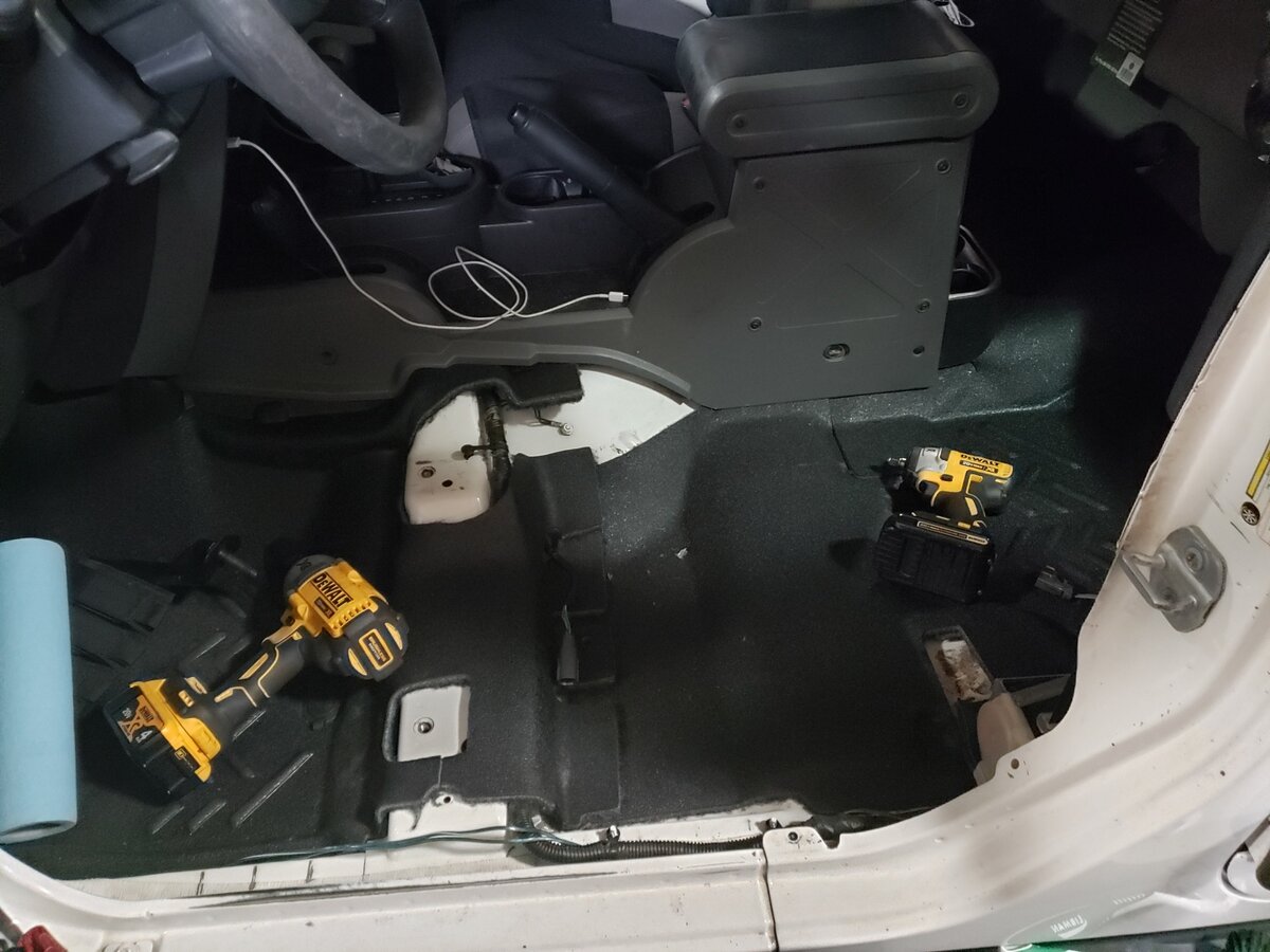

Armorlite makes an amazing flooring system if you're looking into replacing your carpet. I love mine and it excels in that snowy/muddy situation. It's more like a rubbery texture and is removes the need for floor mats. In fact they mention you shouldn't use floor mats with their carpet replacement. Great fitment too and drain plugs are very accessible making it a breeze to hose out any mess. Doesn't get stinky like carpet can if it gets wet. Honestly I can't say enough good things about it. Very non-slip.
Not super cheap, but not much more expensive than a carpet that you might have to replace again if it gets wet.
You don't have to pull the seats, I was just doing a bunch of stuff at the same time.
