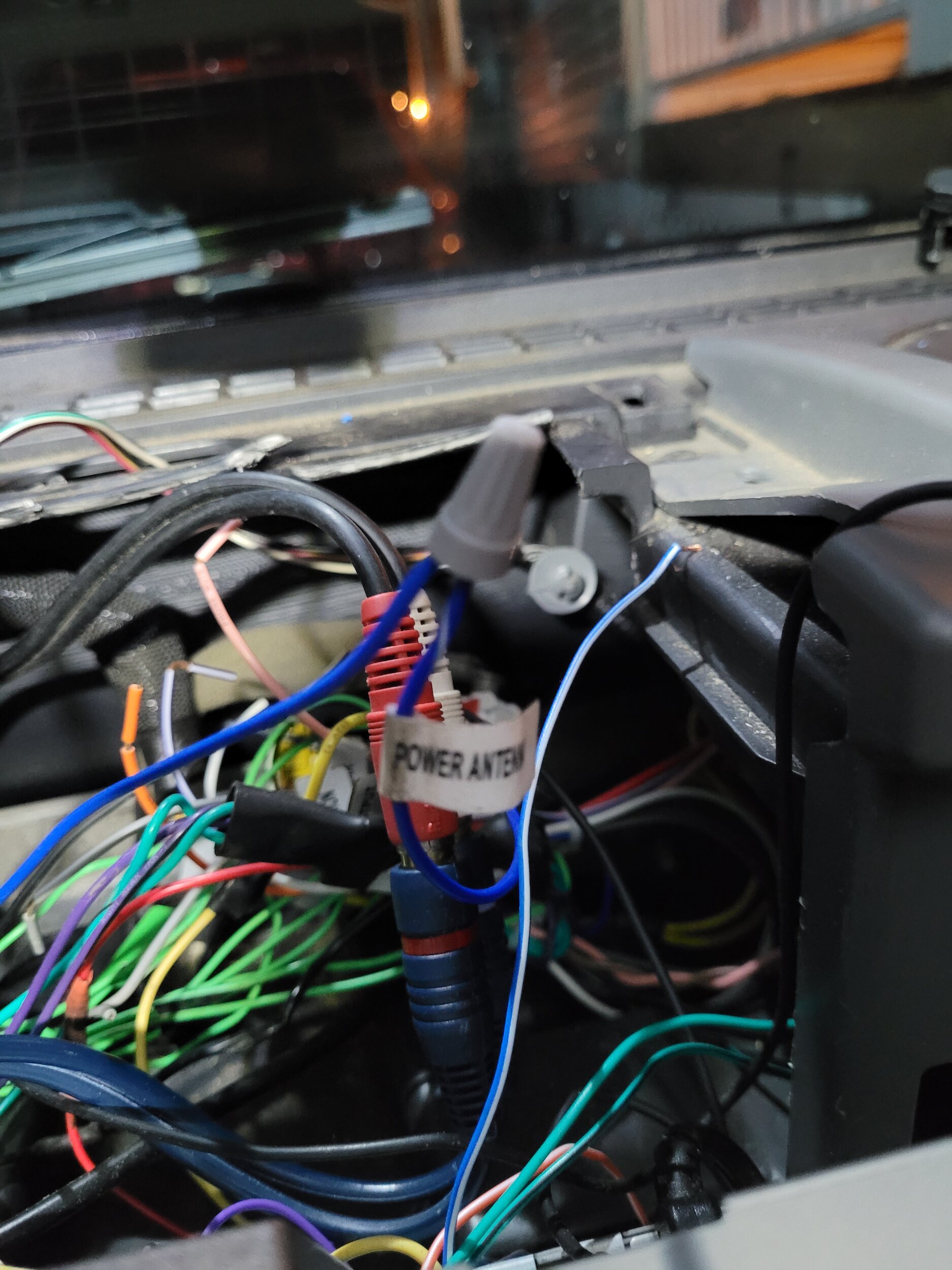

<blockquote data-quote="longlivenintendo" data-source="post: 462137" data-attributes="member: 24533"><p>Solved!</p><p></p><p>So this thread while short and not much discussion hopefully will help somebody with similar problems I had. If you have a jeep jk 08 or around that hear guessing 2007-2011 there is no "power attannae" wire. My after market radio had the red wire labeled ignition switch which when I spliced into it solved the problem. Thank you jeepjeezy. See pic. U have the pioneer dmh 1500nex radio</p><p></p><p></p><p>[ATTACH=full]125657[/ATTACH]</p></blockquote><p></p>
[QUOTE="longlivenintendo, post: 462137, member: 24533"] Solved! So this thread while short and not much discussion hopefully will help somebody with similar problems I had. If you have a jeep jk 08 or around that hear guessing 2007-2011 there is no "power attannae" wire. My after market radio had the red wire labeled ignition switch which when I spliced into it solved the problem. Thank you jeepjeezy. See pic. U have the pioneer dmh 1500nex radio [ATTACH=full]125657[/ATTACH] [/QUOTE]
