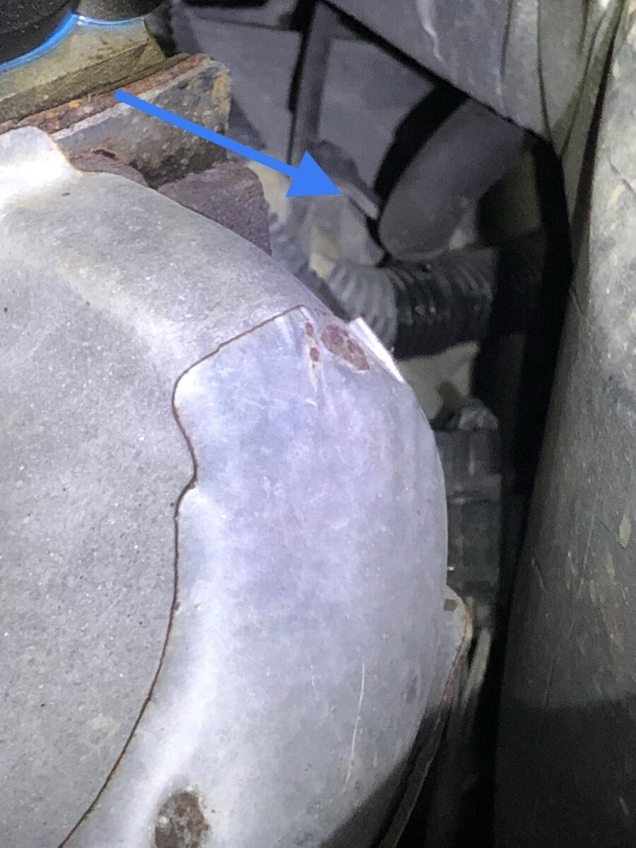

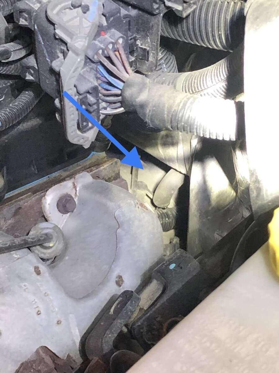

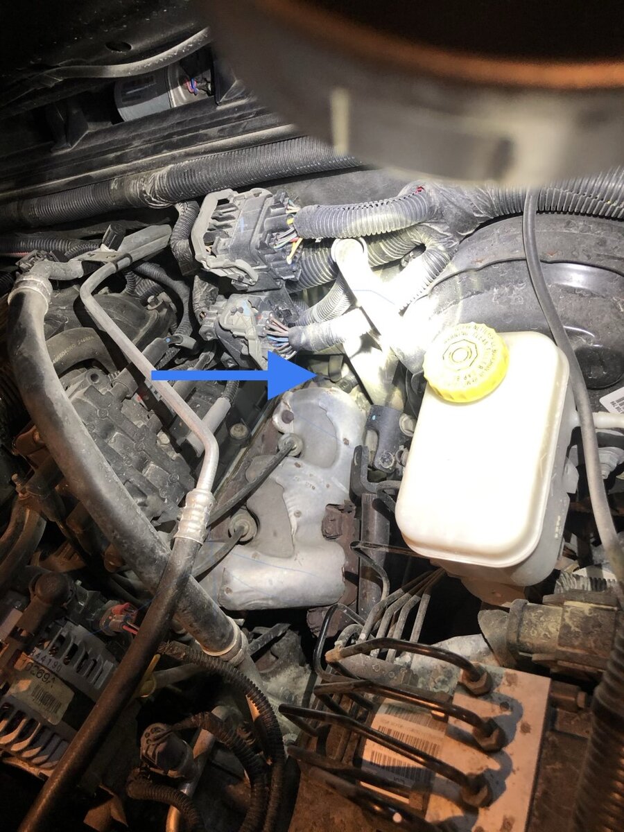

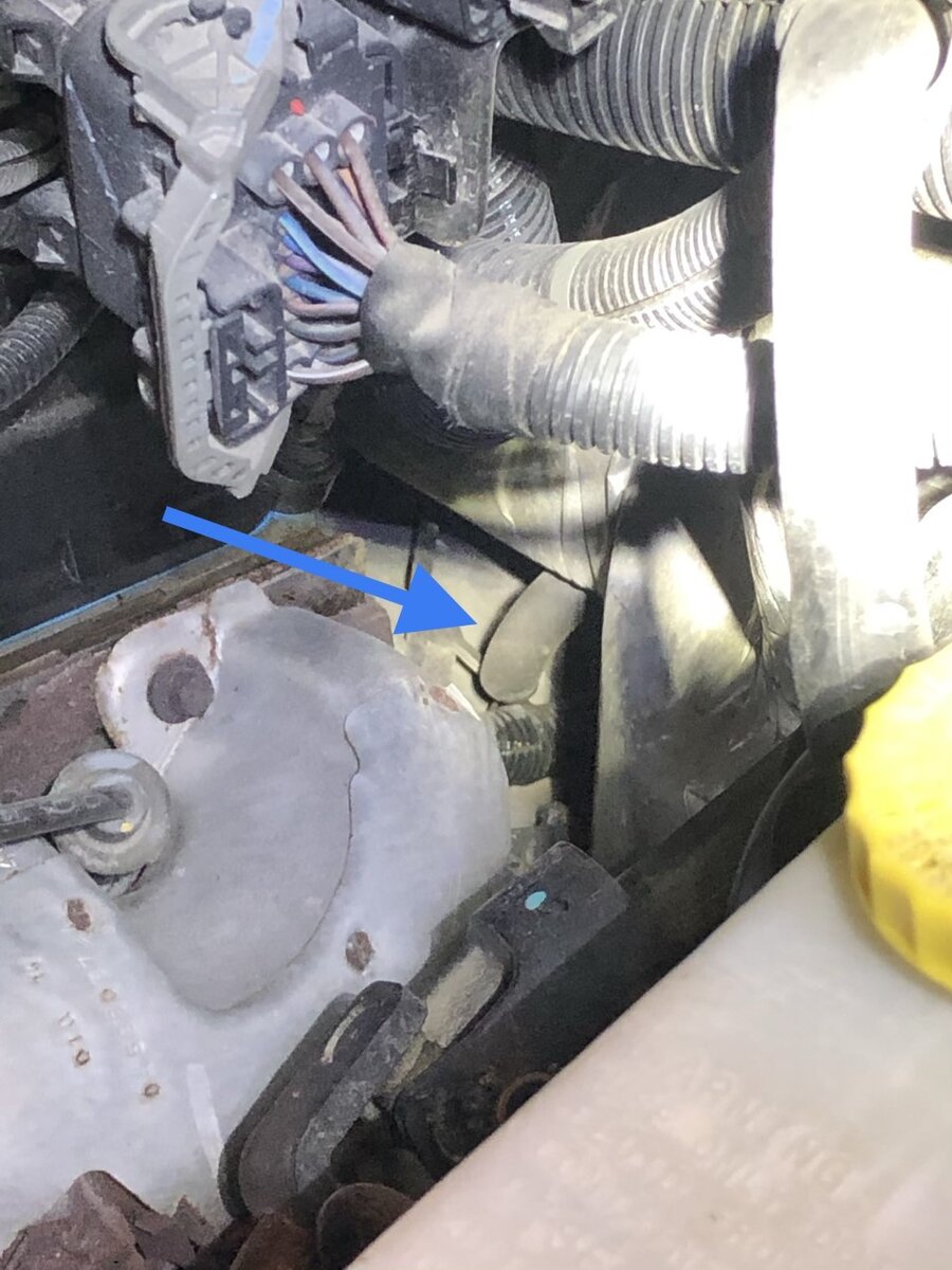

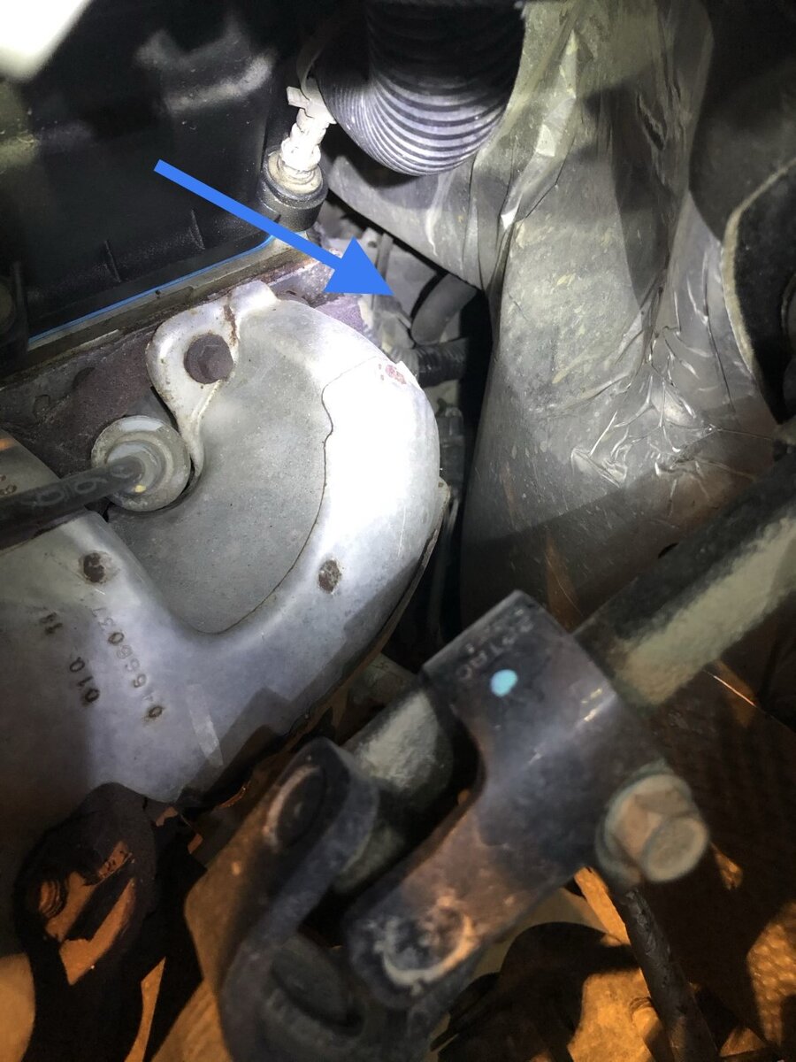

Here's the rub, when I got back home and parked in the driveway to crawl back under the Jeep to pop the retaining clips that hold the plastic radiator shroud back in to place that I loosened to clear debris from the bottom corners of the radiator I noticed a drip coming from near where the firewall is. I looked up to see what appears to be a rubber hose 2-3" in length that is pointed downward at a 90 degree angle was dripping. This was not happening before I started this project today, there was not fluid leaks on the garage floor.
I have attached some pictures that are from the top down angle. These are of the driver's side looking down at the side of the block and back to the firewall. I have an arrow pointing to the hose that is leaking.
I am hoping someone can clue me in to what this hose is, why it is leaking, and what in the world I could have possibly done that would have caused this issue. The only part I ran pressurized water through was the heater core.
