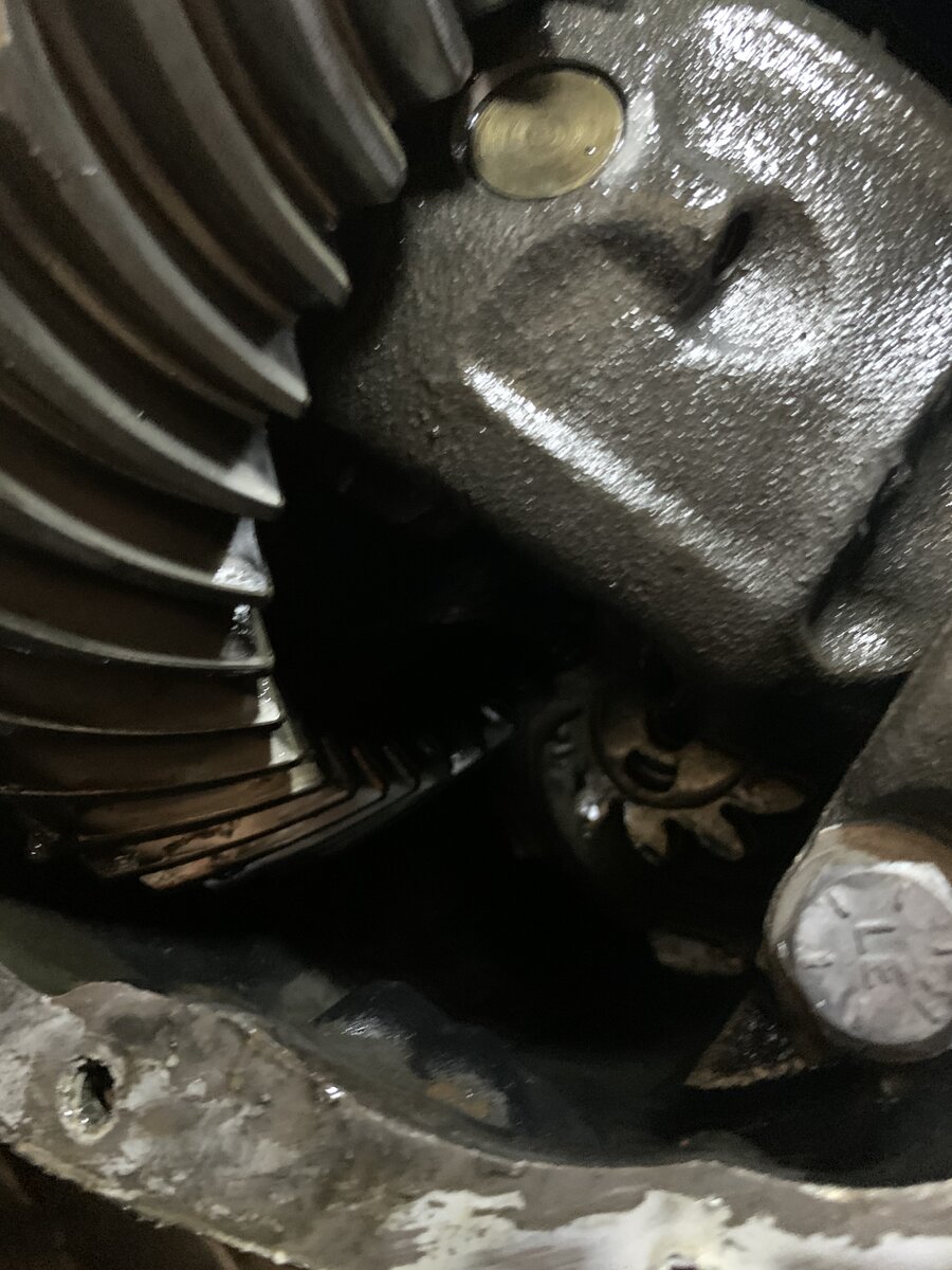

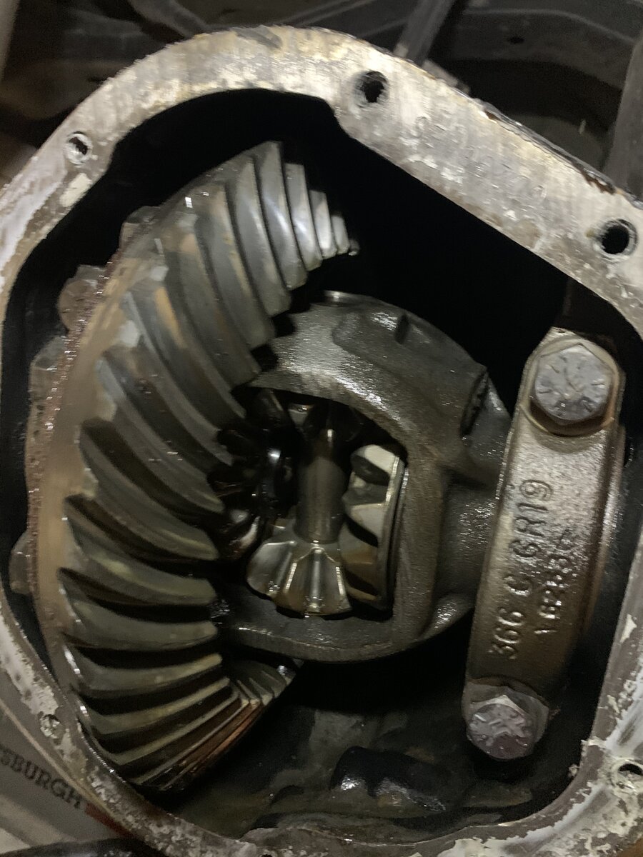

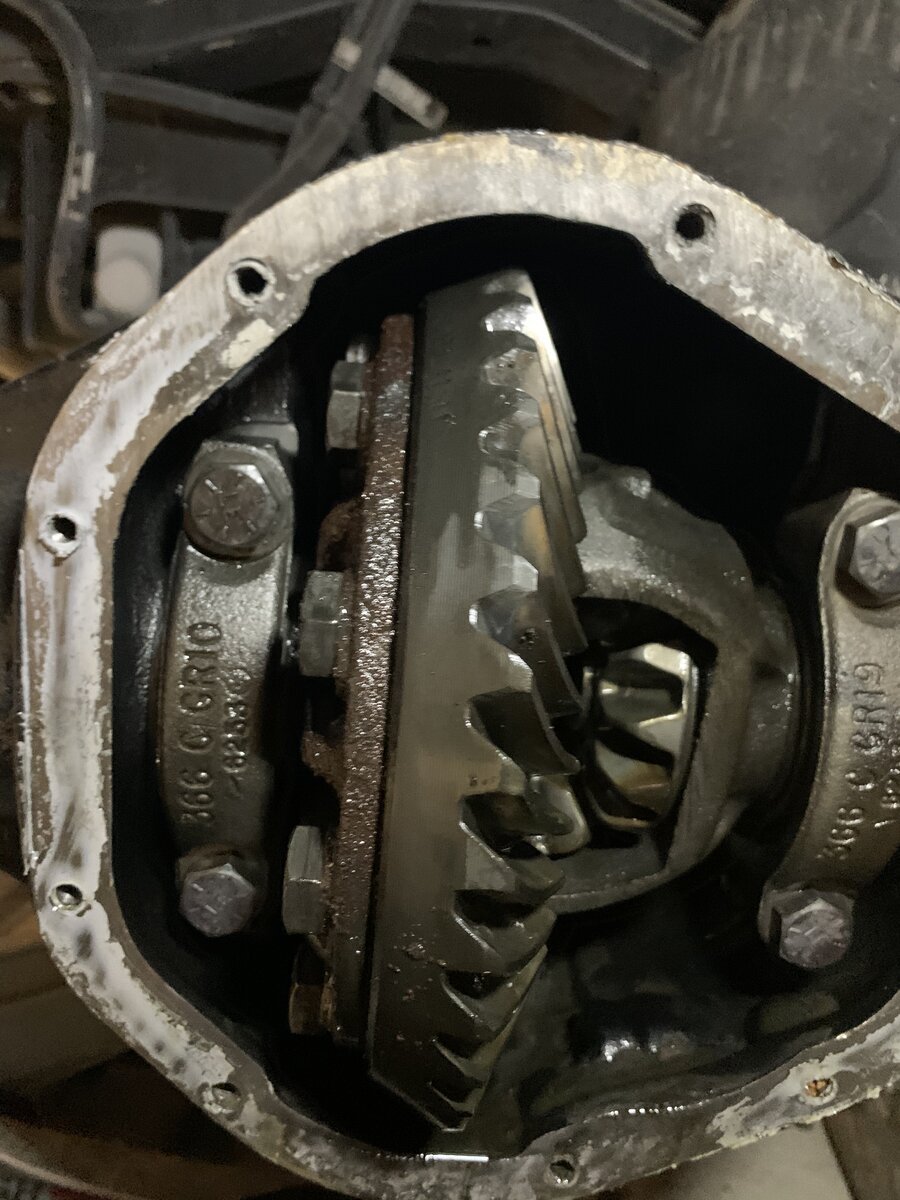

@Willys14jk ...So finally had a chance to get the diff cover off and have a look at it. I am no expert but looked ok to me. Counted the teeth on ring and pinion and confirmed it has 3.73 gears, which is what the VIN says it came with from the factory, so just going to do the turns of the tire vs turns of the drive shaft for the front just to make sure nothing ever got changed up front, but feel much better that I think the rear end is good and the gearing matches the front. Here is some pictures, let me know what you think.
Yeah man if you had a problem it would be apparent. Your spider gears even look good. Mine looked like hell when I swapped in my locker. Make sure to clean off the housing and cover before you run new sealant on. Glad everything worked out.
