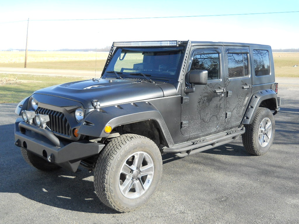

I figured I would put my JKU and what I've done and going to do on here since i'm now a member. It's a 2008 that spent it's first 11 years in Ontario Canada, it only had 72,000 miles on it and is a 6 speed manual trans. I've always wanted one of these Jeeps every since I first saw them but the price was alot more then I wanted to spend for a vehicle. The biggest issue with buying a newer vehicle was having everything on the engine controlled buy some sort or a electronic item that could fail. I decided that if I was to get a manual trans that would at least eliminate 1 possible thing that could cause me a problem. Here is a picture of the ugly front bumper that was on it along with the 35" tires and it also had a 12,000 lb winch and 4 round lights on top of the light bar, winch and lights were already removed when I took picture and I guess I don't have one with them.

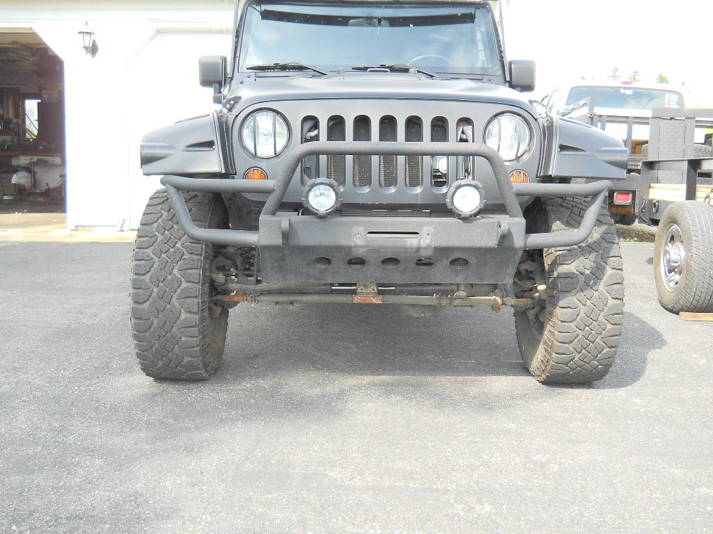

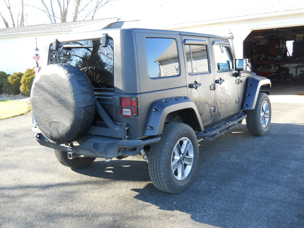

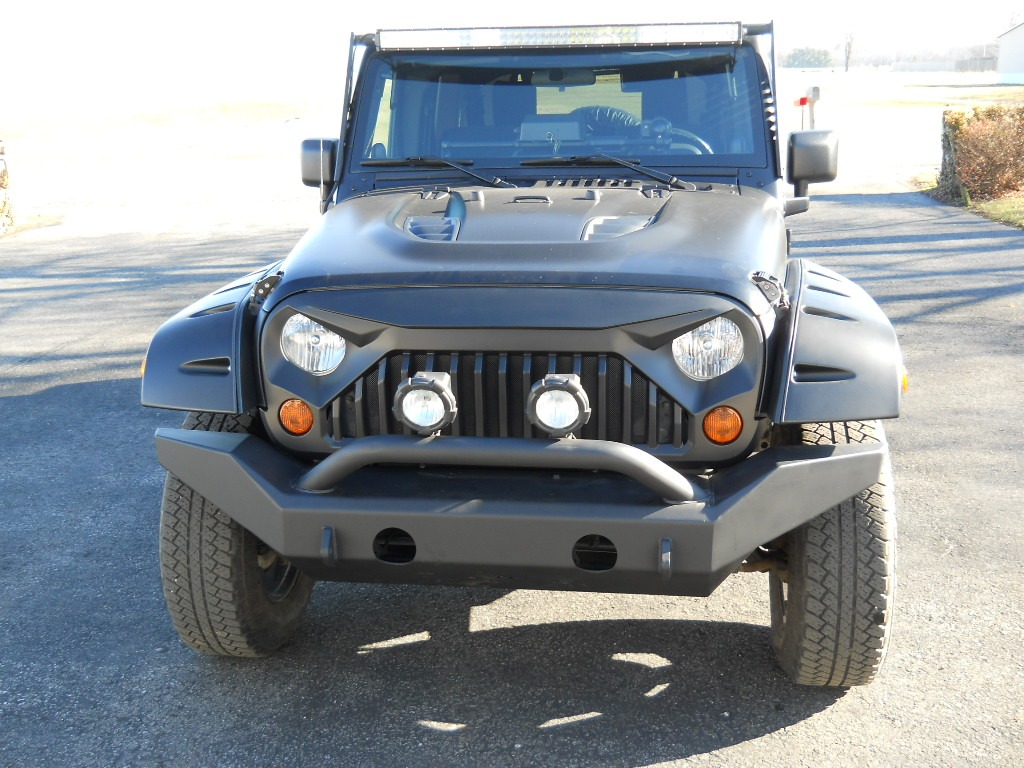

I found a new bumper for 1/2 price at Extreme Terrain along with a new grill for 1/2 price in the open box sales. The Factory grill was messed up from the winch cable. I didn't like how far out the bumpers set and since I wasn't having a winch I decided to move the bumper back as close to the front as I could. I cut 2.5" off the front of the frame where the bumper bolts up and then made new mounting brackets. I also found some 2019 JLU 255/70/18 take offs with low miles installed them and also removed the extra width Bushwacker fenders and replaced them with the Factory size Bushwacker fenders.

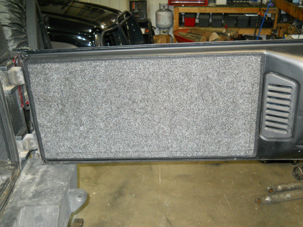

I bought a Bed Rug for my rear door in hopes to make it a little quieter inside from the exhaust noise.

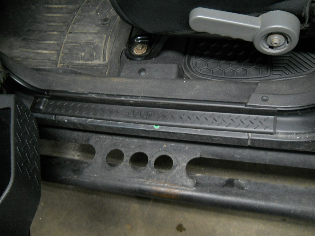

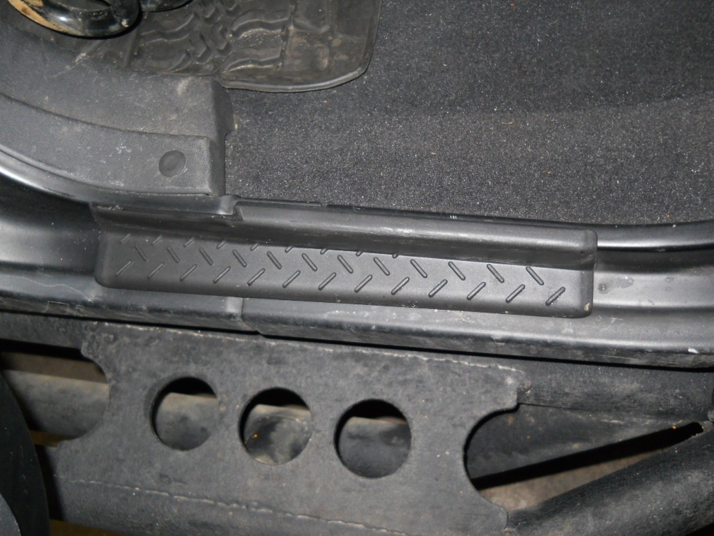

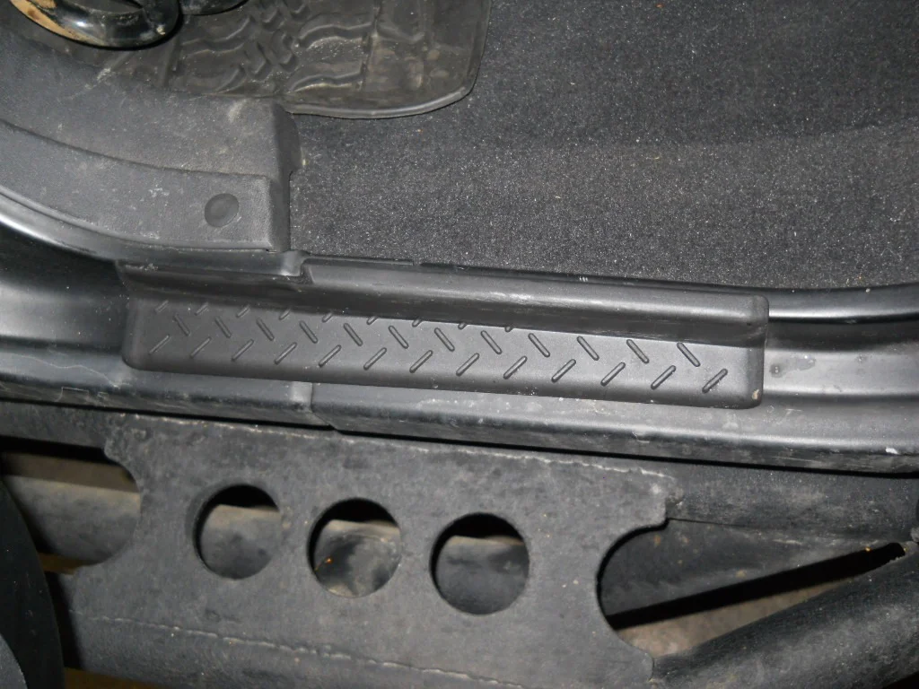

Also some Mopar door sill guards.

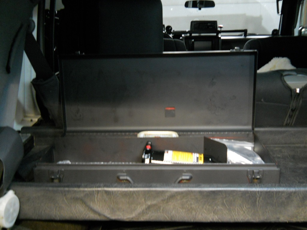

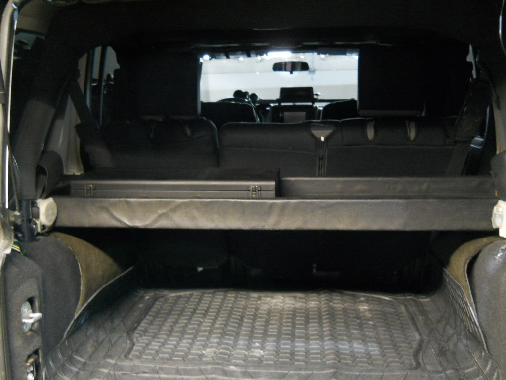

I wanted some more rear storage so I made a shelf in the rear, I had a old metal Milwaukee SawZall box that I bolted onto after painting it black. Inside I put a bottle jack and breaker bar with a socket for the lug nuts, I hate using the factory jack and tire tools.

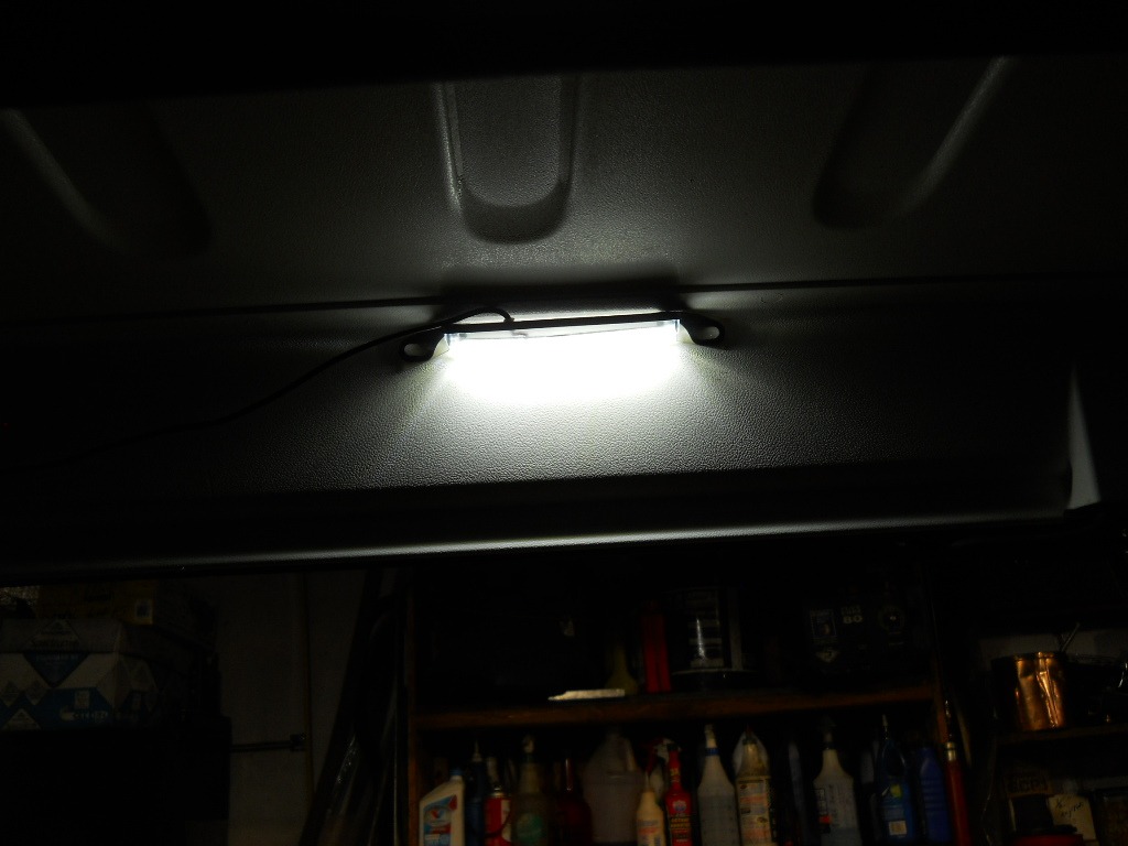

Also wanted some more lighting in the rear and I remembered I had a extra LED licesnce plate light so I wired it into the rear dome light wires. https://www.amazon.com/dp/B0083Y0WL2/?tag=jkforum-20

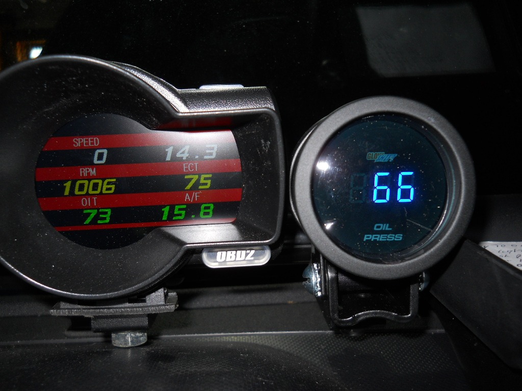

Got a Viper TB and put on and then did the Premium fuel tune along with the Viper tune, did notice a slight improvement in Performance.

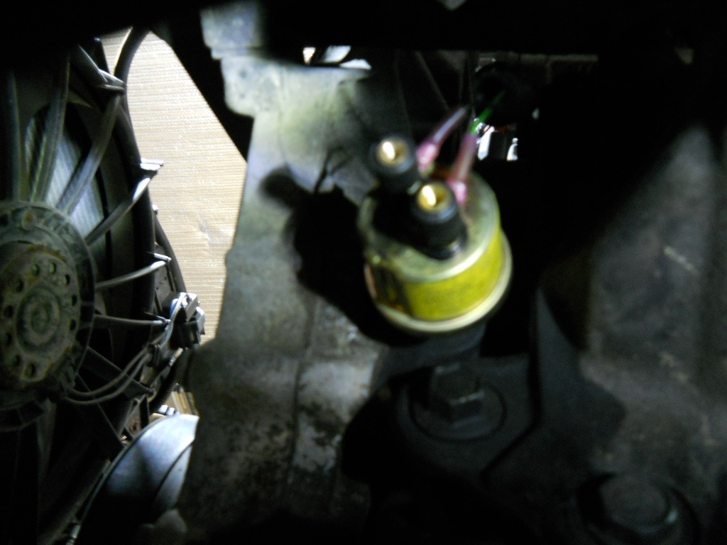

Also did a separate thread on my oil pressure gauge install but figured I might as well include it here also.
First picture is location on the left side of the block to install sender.

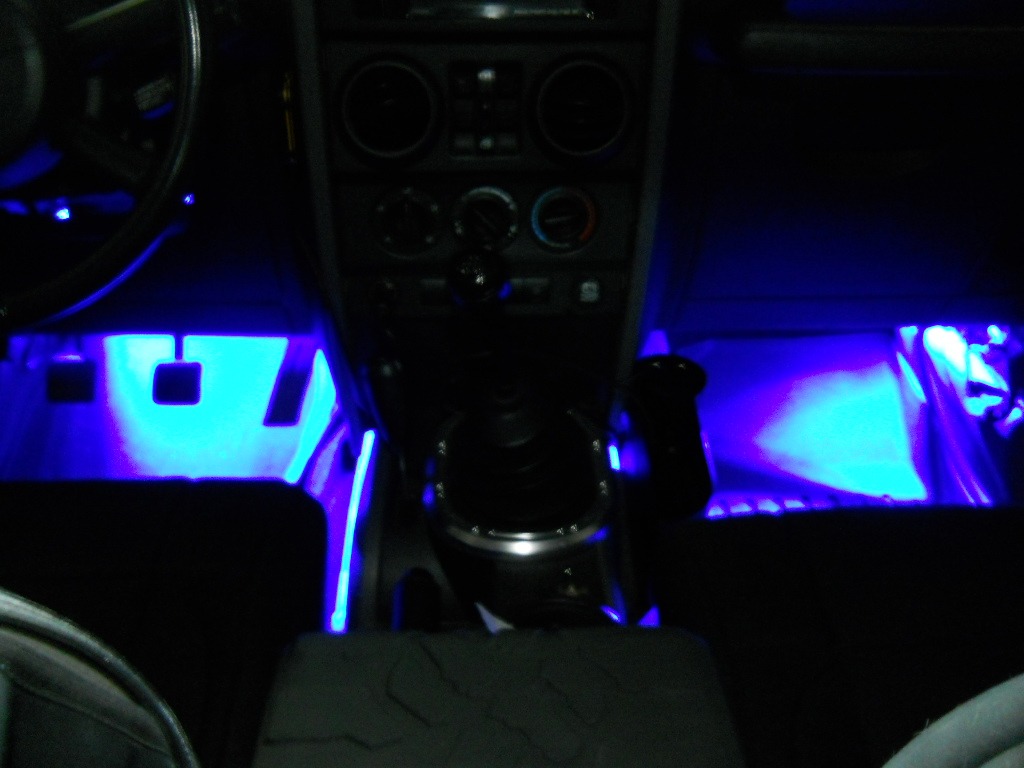

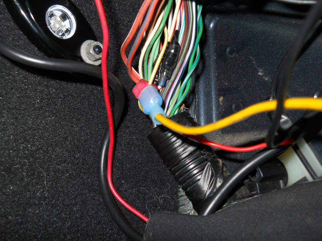

I bought some small blue LEDs to use for footwell lights so I found the yellow wire with the white stripe on it at the corner on the right side under the dash. The wire is the one with the red splice connector on it, sorry it doesn't really look yellow in the picture.

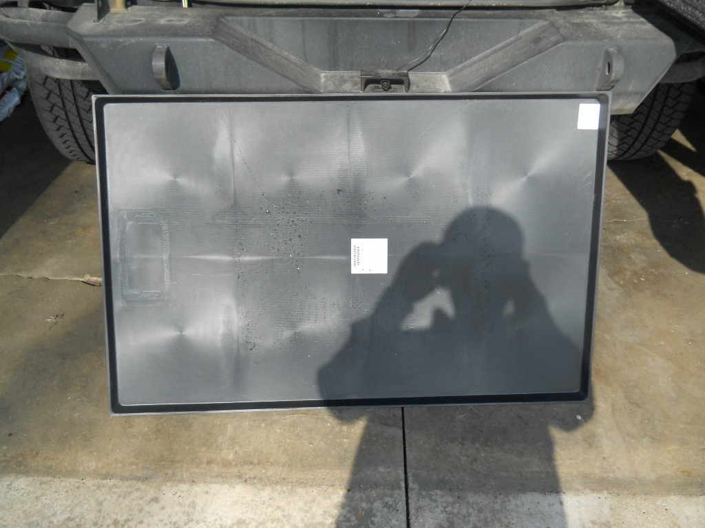

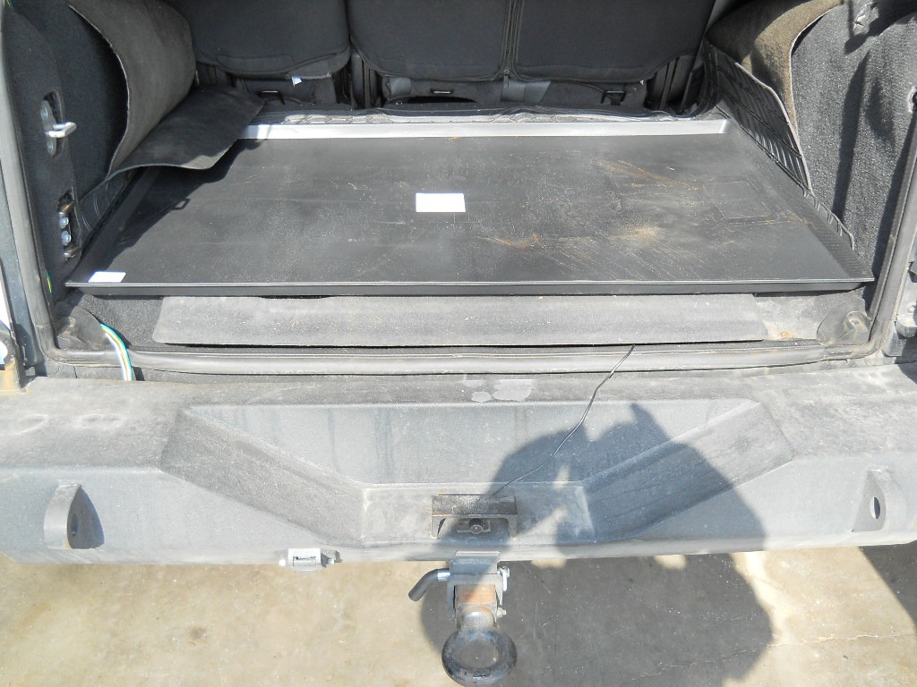

I went to my local Farm Store the other day and saw these trays that are made for dog cages, found one that's a perfect fit for the cargo area. The overall measurements of it is 26 3/4 x 41 1/4.
