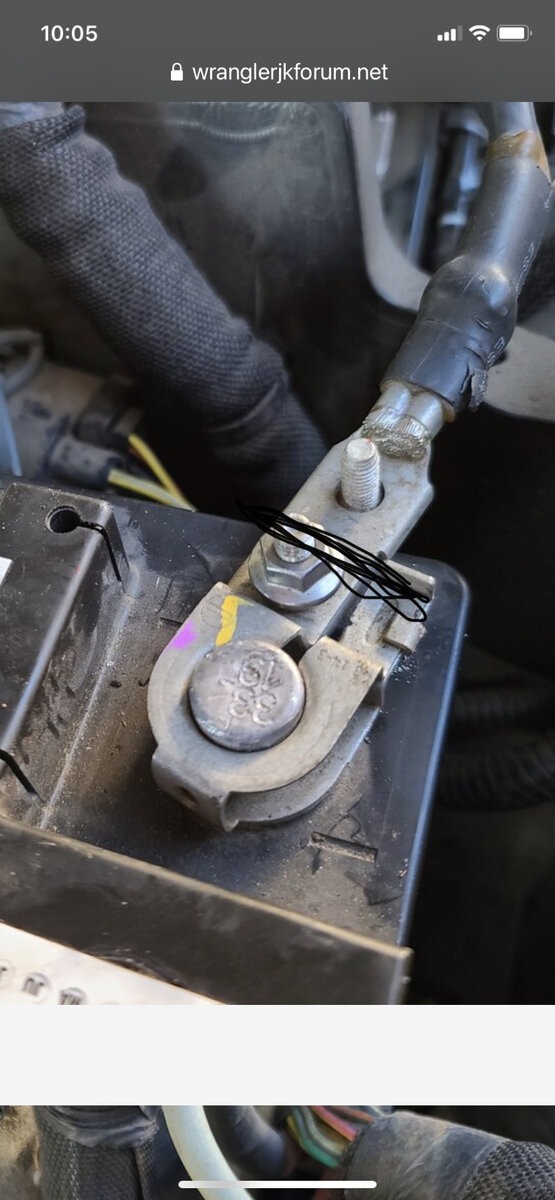

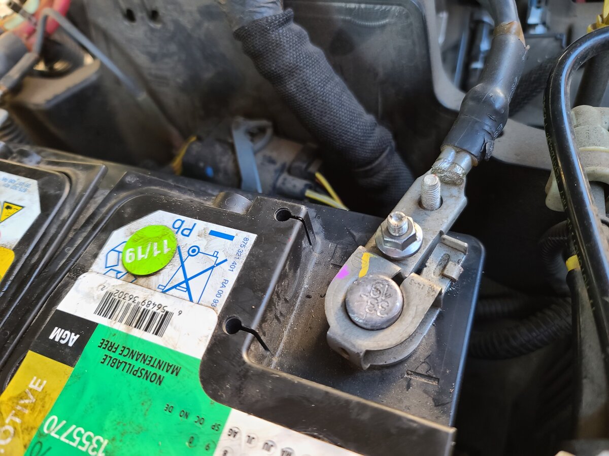

william klepper New Member Joined Jan 24, 2021 Messages 1 Location simi valley Jan 24, 2021 #1 yup..clip..no clip clip attached...really want to find one of these clips..but fell into the abyss,,,goes under cone shaped nut

JerryD ¯\_(ツ)_/¯ Supporting Member Joined Dec 20, 2019 Messages 924 Location West Michigan Jan 25, 2021 #4 Chris said: Wait, what clips are we talking about? Click to expand... It looks like the clamp the holds the cable on the post. If it's not replaced, the OP is going to experience a lot of issues, if they're driving it.
Chris Administrator Staff Member Joined Sep 28, 2015 Messages 32,562 Location Gillette, WY Jan 25, 2021 #5 JerryD said: It looks like the clamp the holds the cable on the post. If it's not replaced, the OP is going to experience a lot of issues, if they're driving it. Click to expand... Oh, somehow I missed that in one of the photos. Yeah, I'm not sure where you get that. Personally I'd just replace the battery cables with new ones even if they are a different style.
JKTim JK Enthusiast Supporting Member Joined Dec 22, 2019 Messages 146 Location Prior Lake, MN Jan 25, 2021 #6 I would do this. Cut the factory clamp at the line and remove the stud. Then replace the wing nut with a regular nut on these for my new cable ends. Reactions: JerryD

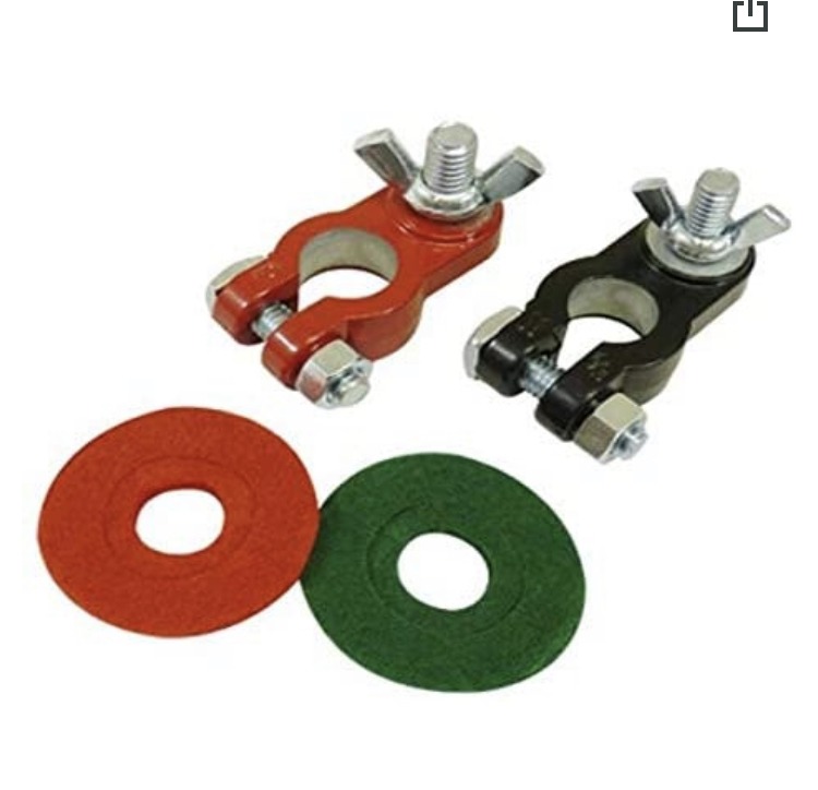

JerryD ¯\_(ツ)_/¯ Supporting Member Joined Dec 20, 2019 Messages 924 Location West Michigan Jan 25, 2021 #7 This might be an even better option https://www.amazon.com/dp/B08HN2QS3J/?tag=jkforum-20 EDIT: Clarification - do what @JKTim suggests in post #6 and then use the upgraded terminals in the Amazon link. Reactions: mrjp
