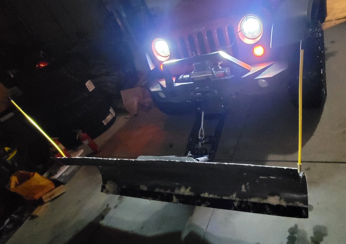

<blockquote data-quote="xackley" data-source="post: 447507" data-attributes="member: 17509"><p>I plow with a snow bear.</p><p>been plowing my 400 foot rough drive for 20 years </p><p>This year I hooked it up to my 2013 JK using a front trailer hitch.</p><p>Using a draw tight front trailer hitch was too much for the hitch.</p><p>The plow kept getting lower and lower. I welded the hitch tube back to the bracket and now use a ratchet strap from the plow frame to the jeeps tow hitches. </p><p></p><p>As to plowing, I have moved 8 inches of heavy wet snow with no problem. I don't jolt the jeep. Let off the gas and push the clutch at the end of the run. </p><p></p><p>The Meyer looks better than the snow bear. Jeep no problem. Question is the tongue weight.</p><p></p><p>Don</p></blockquote><p></p>
