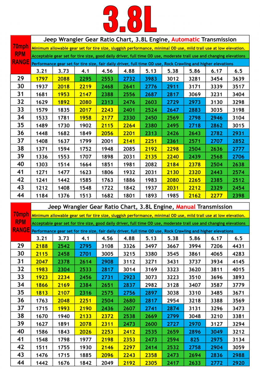

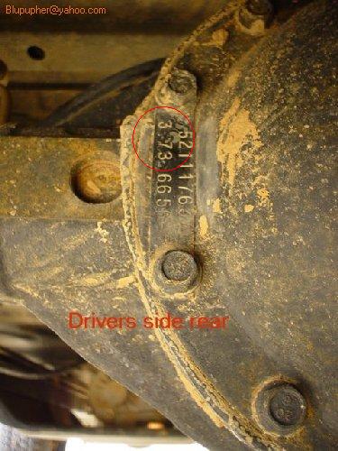

Use the gearing chart to see where you fit. I would hope that the ratio is on the rear diff. It's just a little metal tag, so may have been taken/ fallen off. Probably buried under gunk. Start there. If you have 3.21 or 3.73 that is probably the problem. Especially 3.21.
