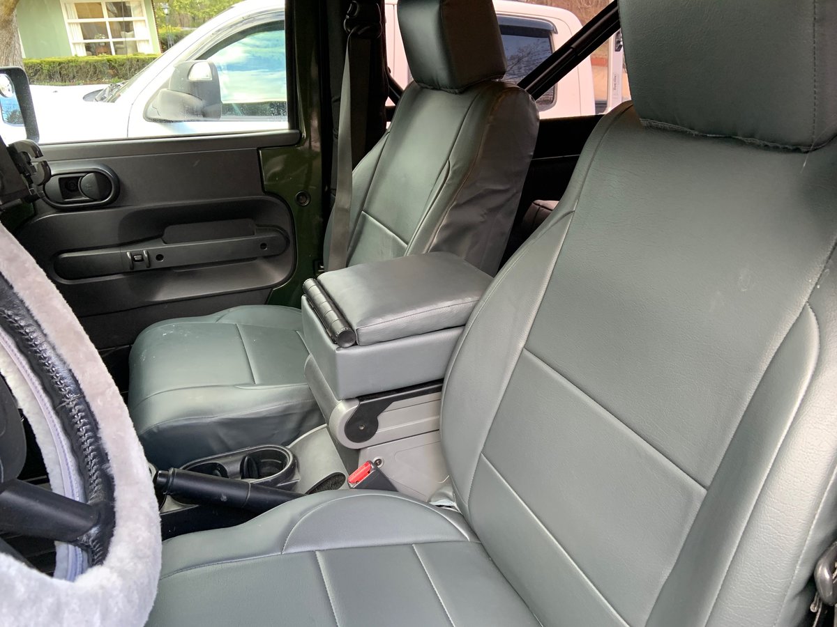

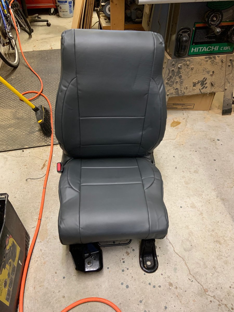

you can easily add foam and batting to the stock seat and recover/reupholster it. I got simulated leather covers from Iggee which worked great. you could also take the seat to a local auto upholstery shop and have them rebuild and recover it for less than buying a whole new seat. or you could go the junkyard route to get the seat and put an aftermarket cover on it. here is a pic of my seats after putting the Iggees on.
  • Wow
Reactions: Chris
Oh yeah, IGGEE makes some damn fine seat covers. I had them on my TJ and was blown away by how well they fit. You'd never even know they are seat covers.
