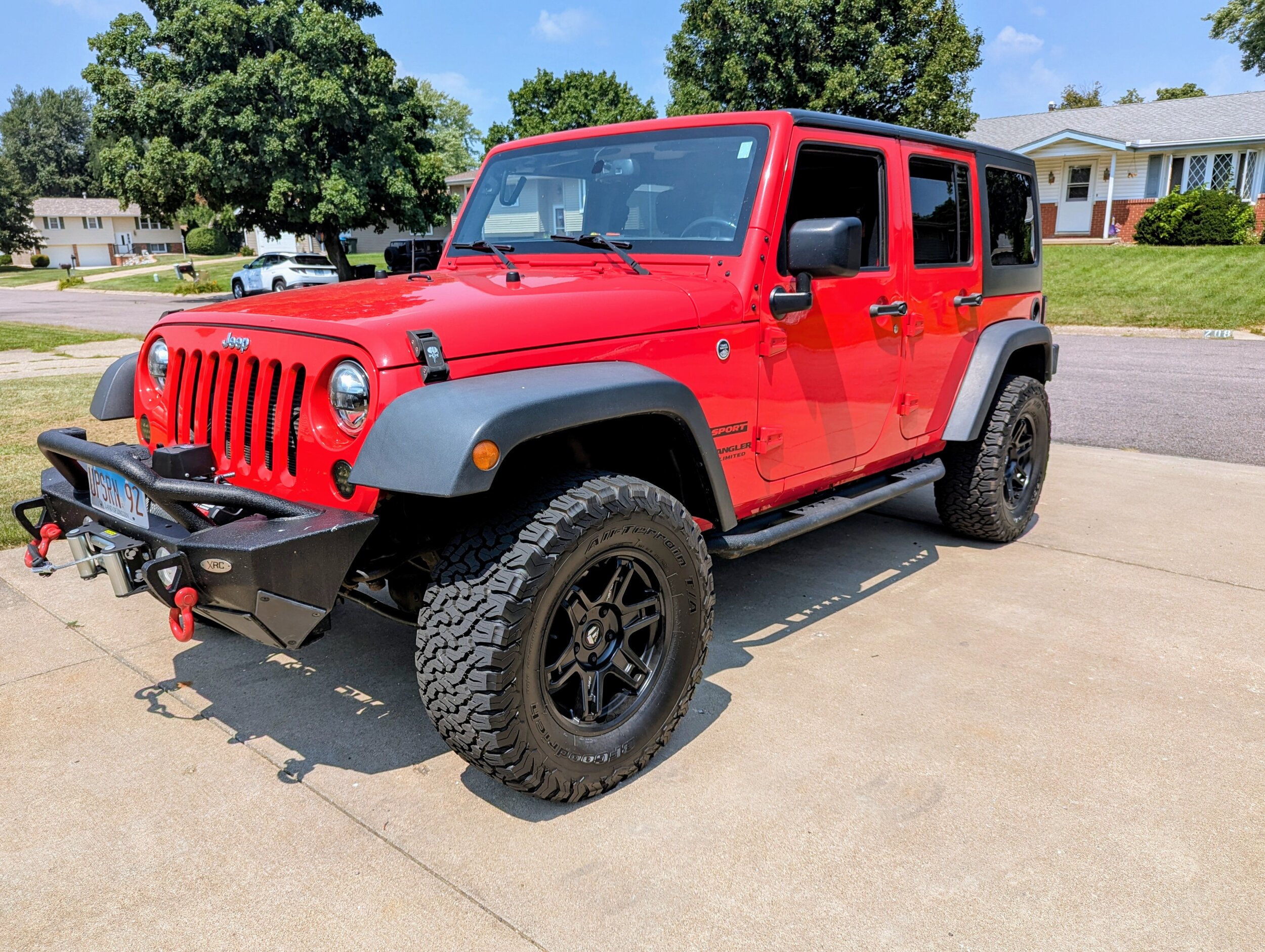

I'm still running 255/75 on OEM Rubicon springs and a 1" spacer in front. it seems like I would have plenty of room for a 285/70, although I'll probably go to a 34" or 35" tire and a lift - just don't want to buy tires twice! I'm not doing anything that's really pushing the travel though.
