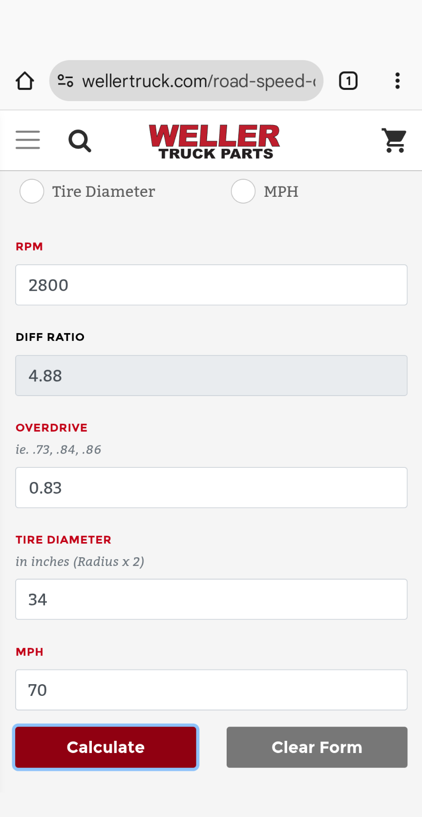

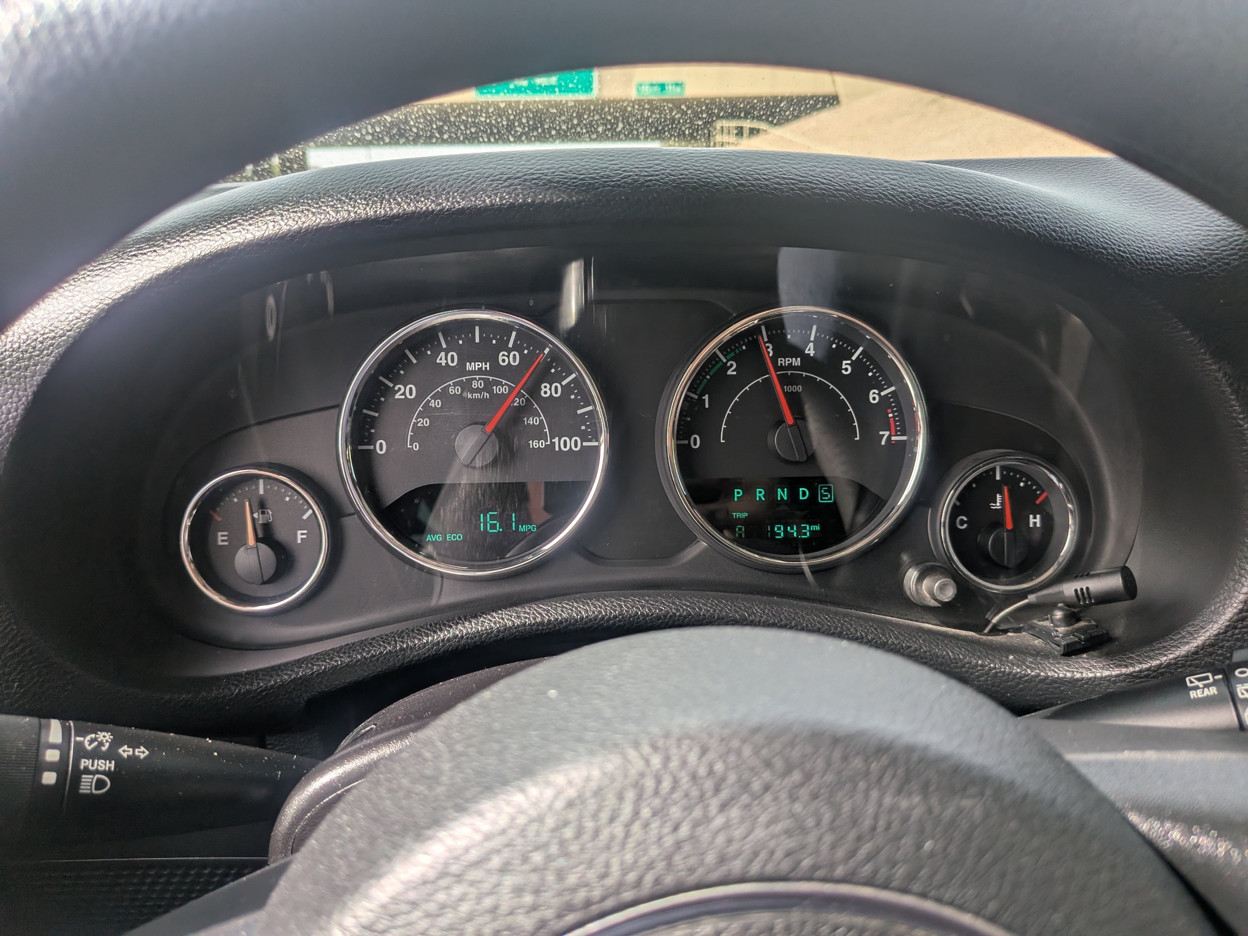

So I'm trying to figure out my gear ratio
35x12.50 tires about half worn
W5A580 transmission so 0.83 in 5th gear
I'll add the picture of my speed and RPM at 70 MPH..... And go!
