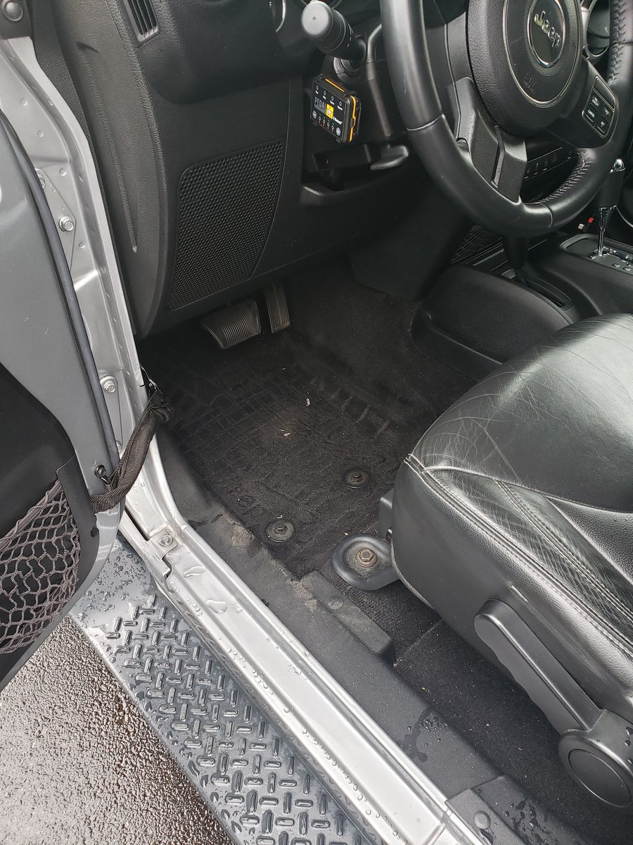

Its just rained here in NJ and I noticed my drivers side floor is soaking wet..I have the hardtop on with really no signs of water.
Has anyone had this and fixed it dont wat a moldy smelling truck
