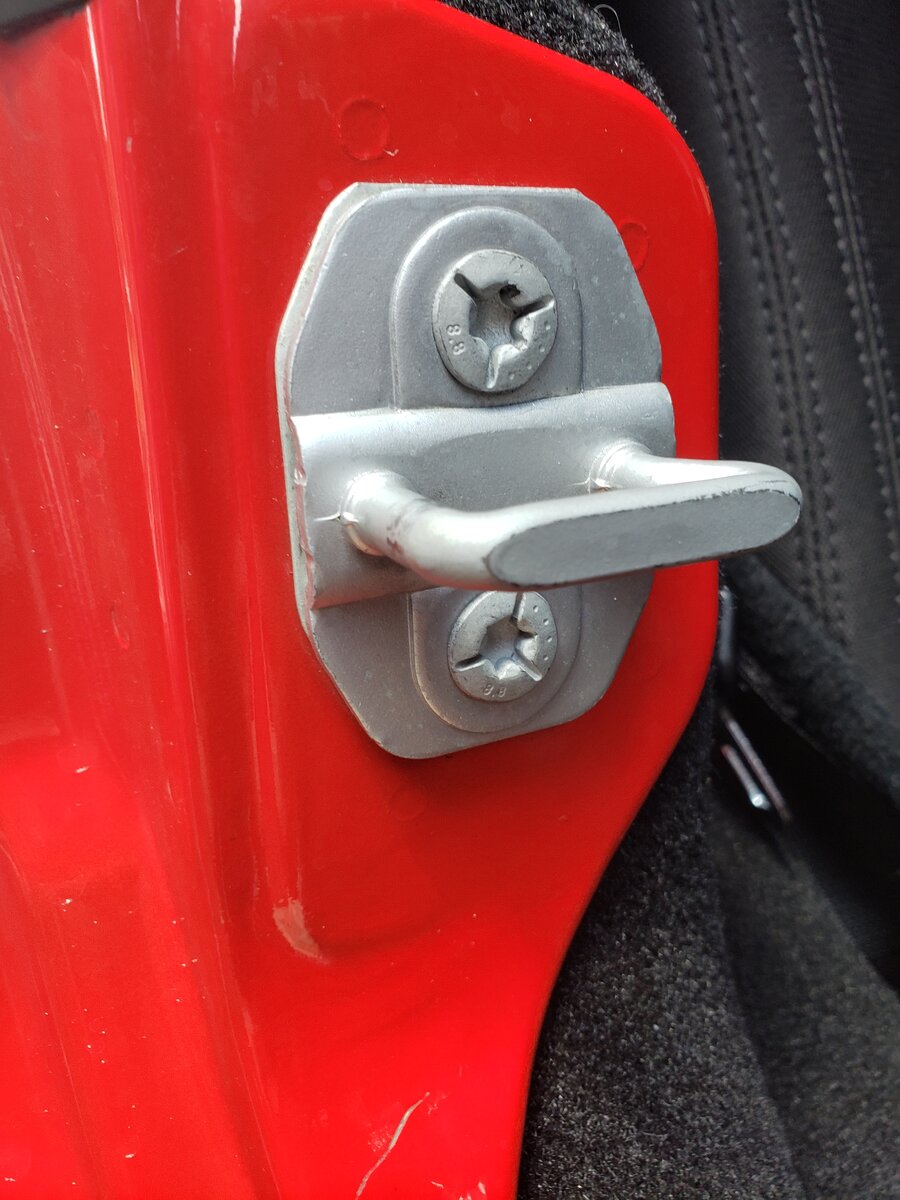

Is your door edge flush with the side of the Jeep when it's closed? It might need the striker adjusted to bring it in some if it isn't.
Here's where
Thats what those are. I think I have some in my tool box. I never knew what they were used for. I love learning new things about cars and things in general. Thankyou ill try it out.
Reactions: mrjp and BLACKJKU
About all the body bolts on the Jeep are those kind of bolts.

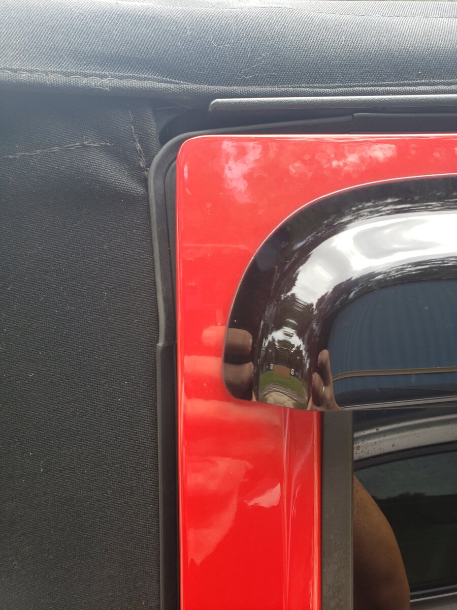

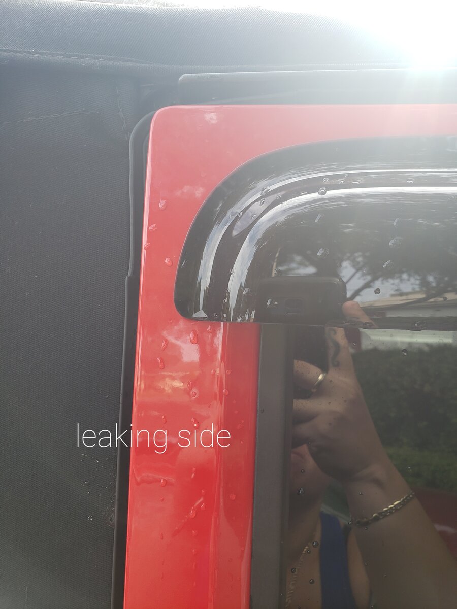

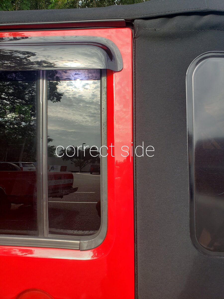

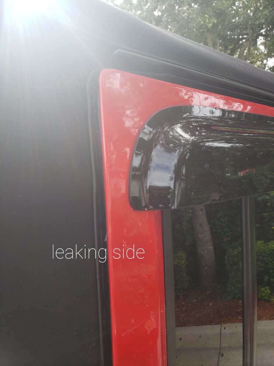

In your Post no4 it looks like there is a problem with the soft top being in the way stopping the door from closing. The top left corner.
It looks like something is preventing the door from closing properly, Do you have more gap on the hinge side on the leaker then on the correct side hinge gap.
On the side where the door hinges are is the gap between the door and body the same on the correct door and the leaking door?
It looks like the door is to far to the opening side or else the soft top is preventing it from closing.
