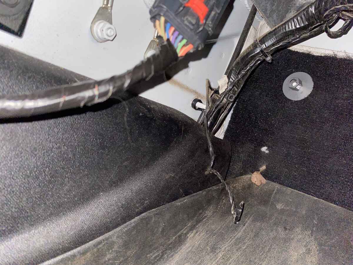

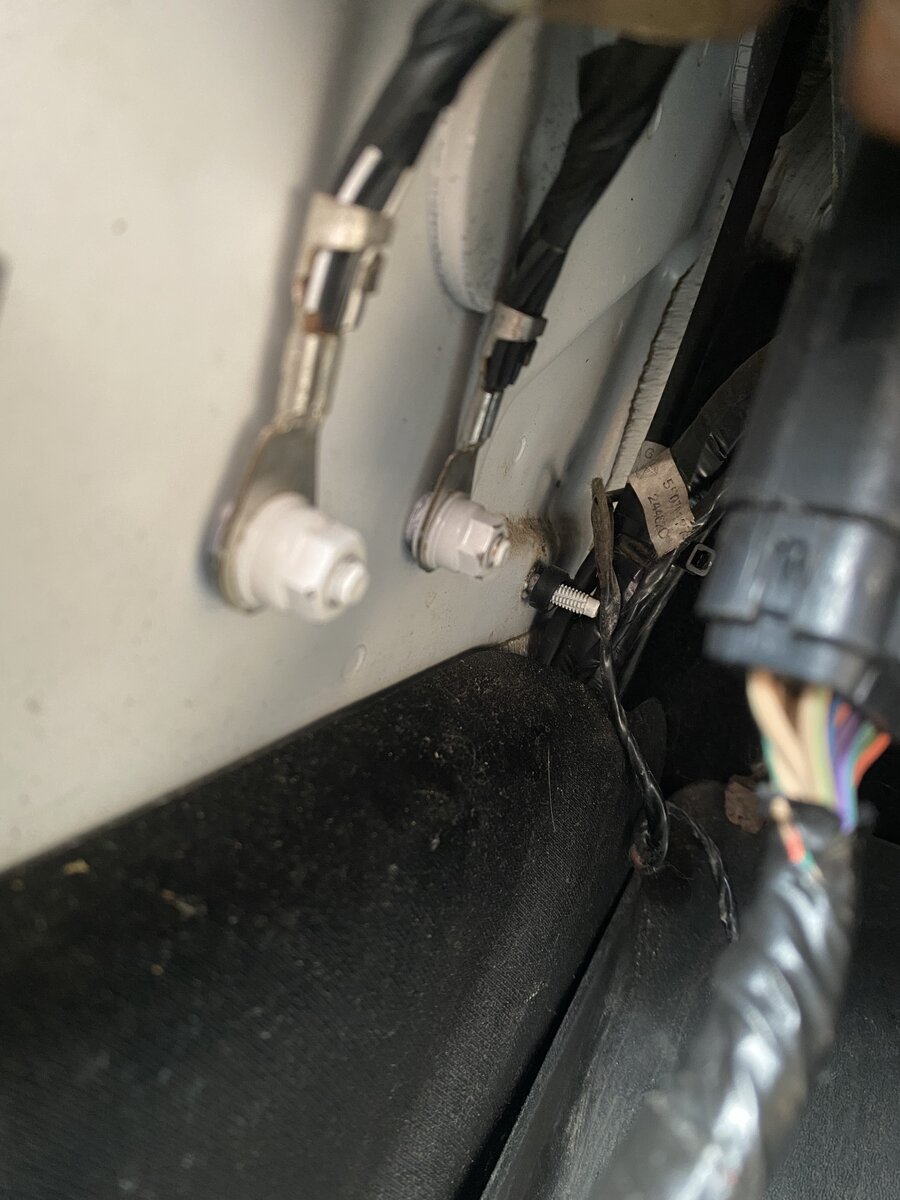

Left of the pedals on the body side is a group of grounds
Is there supposed to be a ground wire on the stud in the very back closest to the firewall?
As far as grounds you are going to have to reference very specifically a 2011 diagram. You still have a 3.8 but have the updated interior. You have the only year with this configuration. Just FYI
You'd have to look at the ends of any of the wires that are hanging around to see if they have a ring terminal on them.

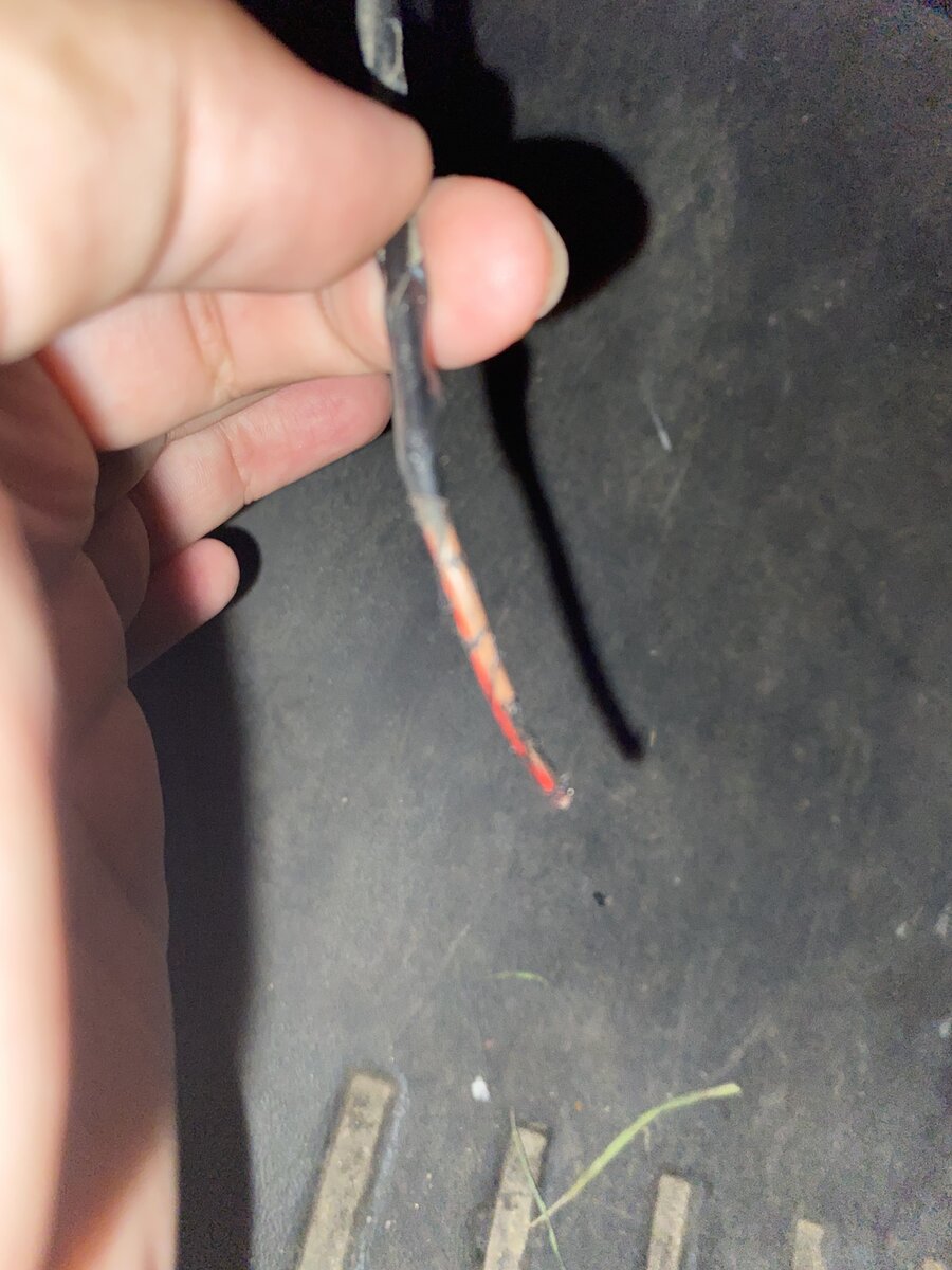

Here’s what I found, the wire that is dangling is red and tan and does not have a ring terminal. No idea where it came from. It is not stripped on the end so I don’t think it was pulled out of something, it looks like a clean cut. Never even noticed it until I started chasing down this issue.
Edit, I stripped the end and touched it to the existing ground with no change. I’m not sure what’s going on here
I would put a meter on it and see if it is a power or ground or it could be a nothing that a PO added at some point
Hmm... I wonder if the previous owner did something with the door sensor. Or something happened in general.
