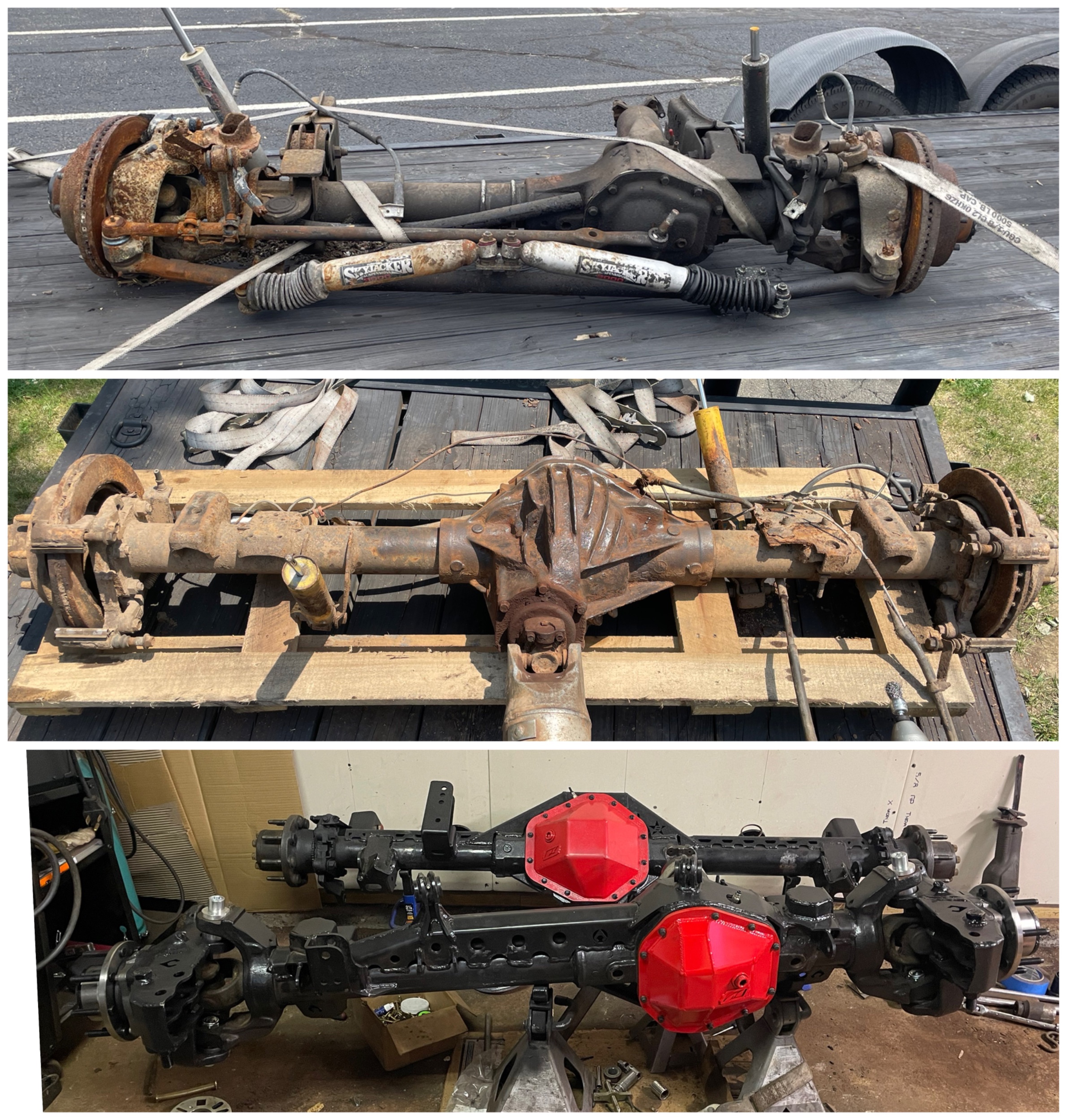

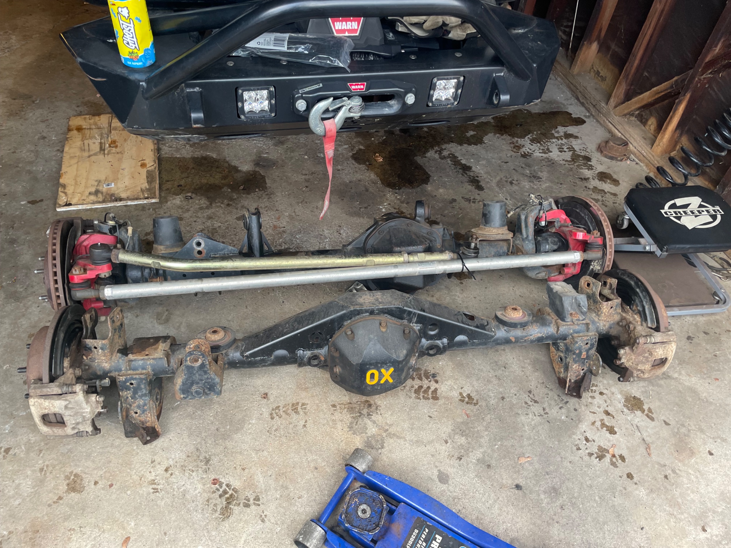

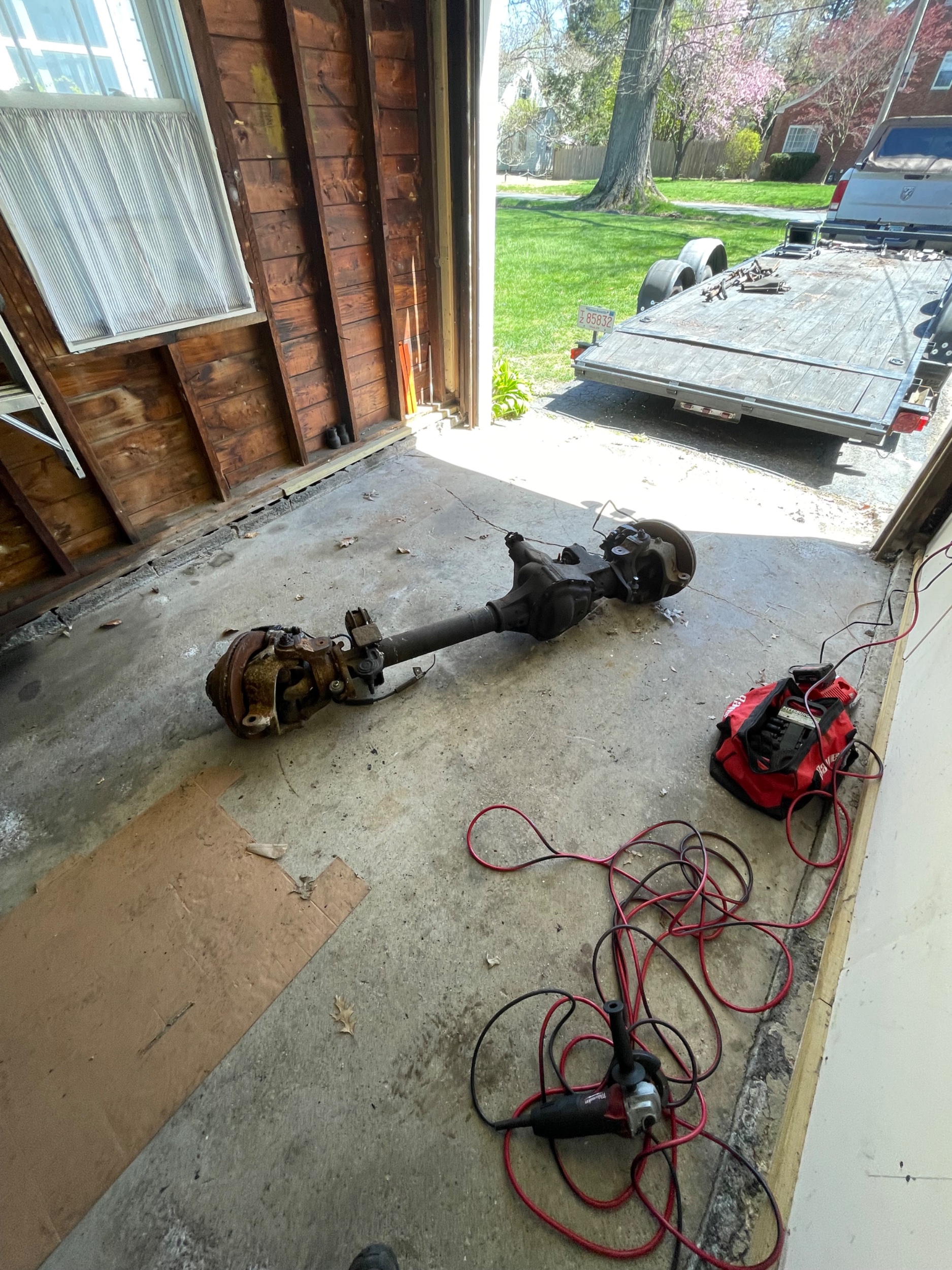

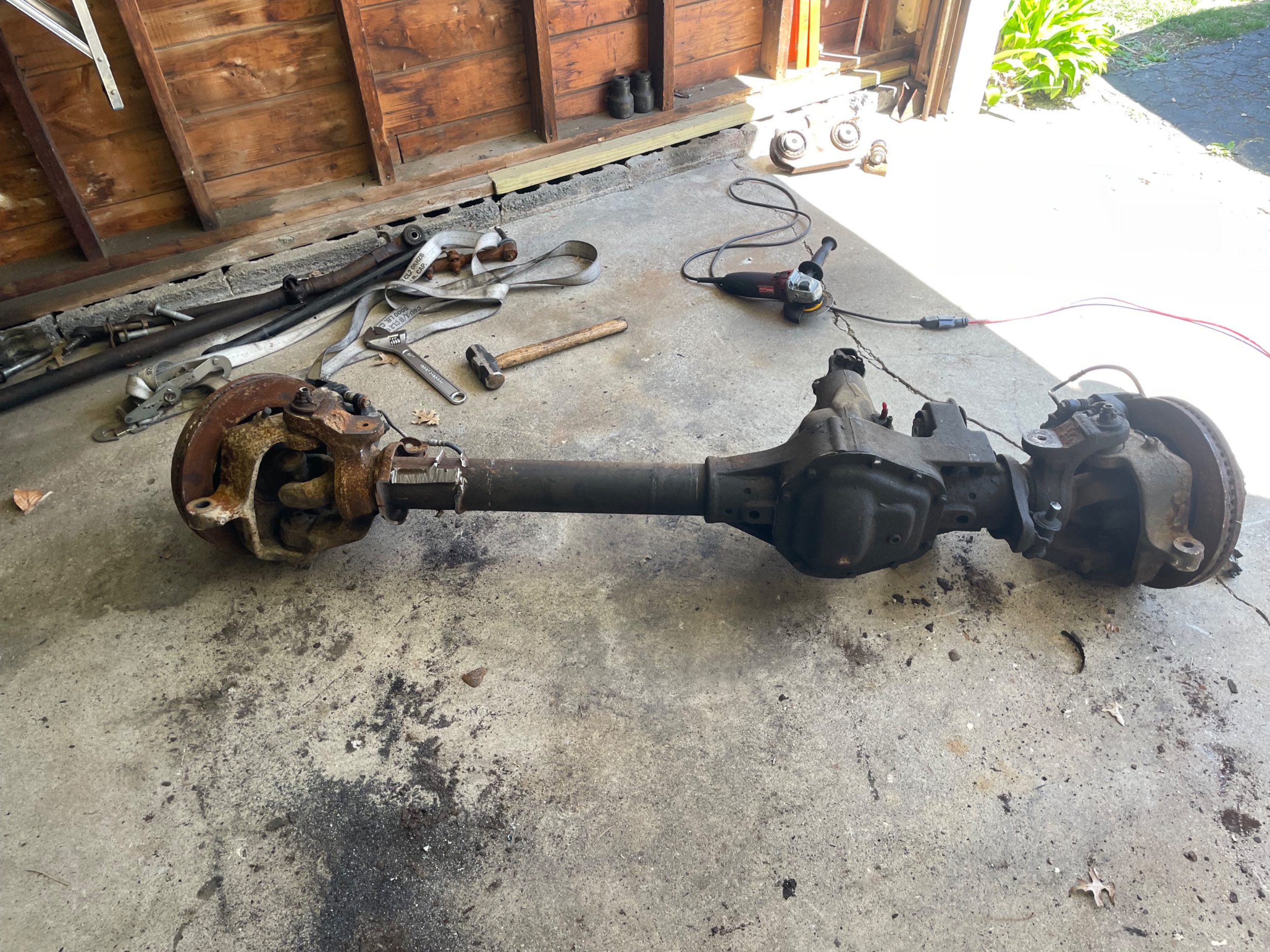

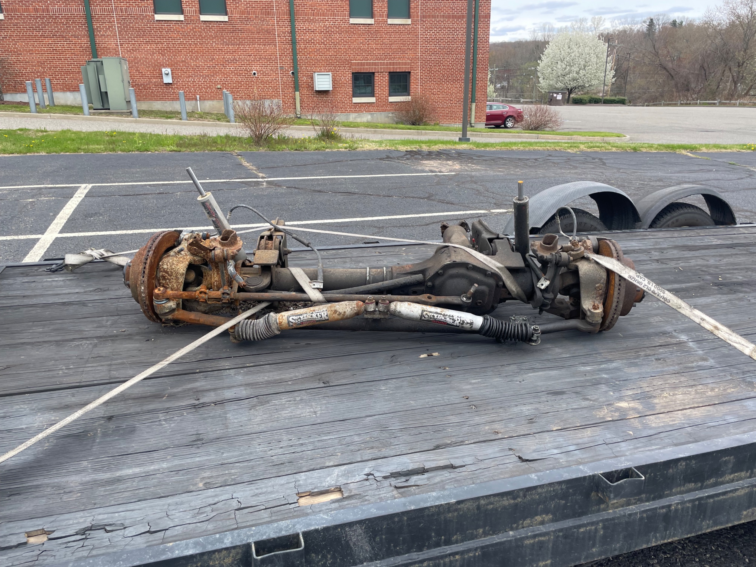

Junkyard 1-ton swap!

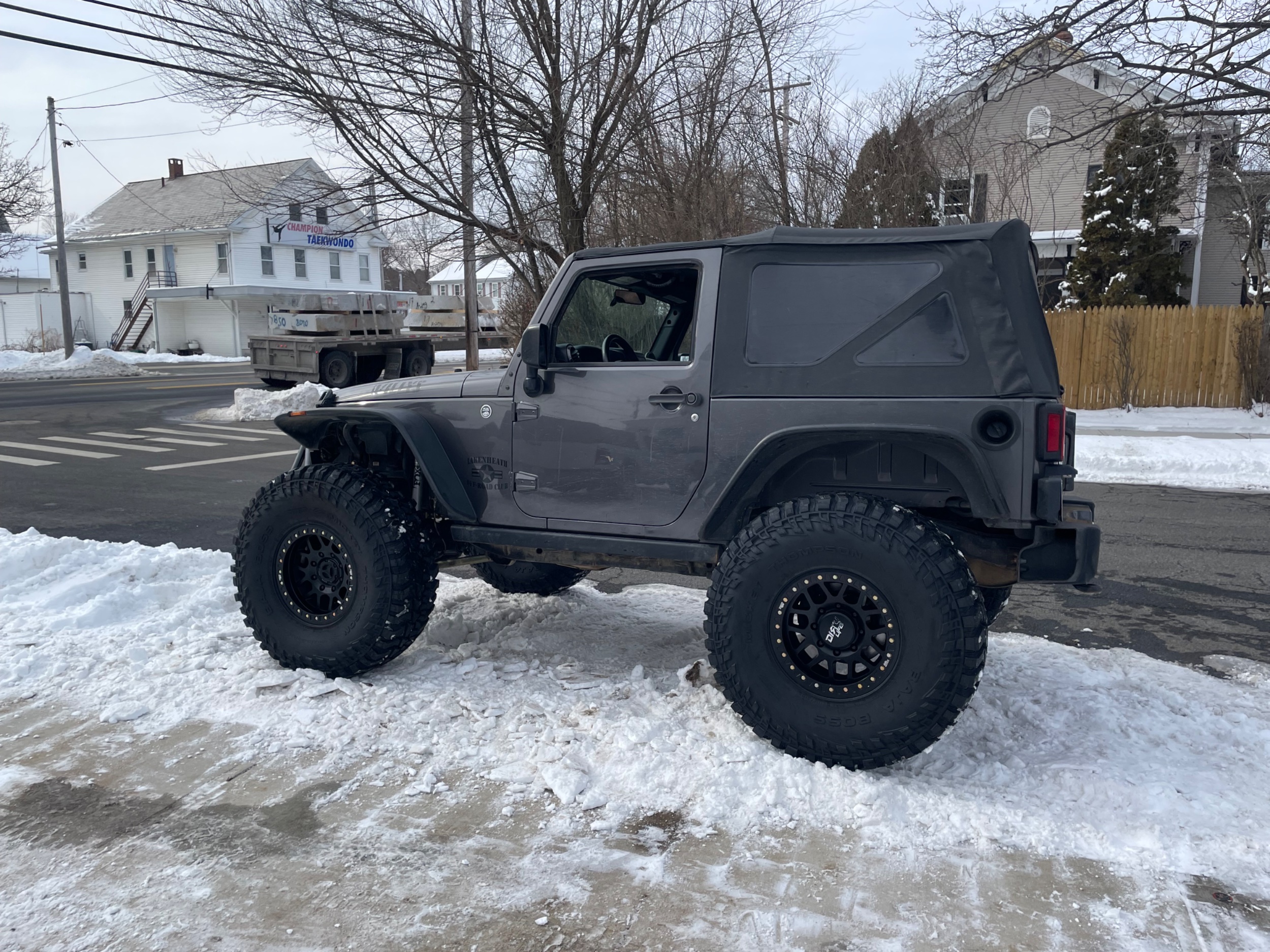

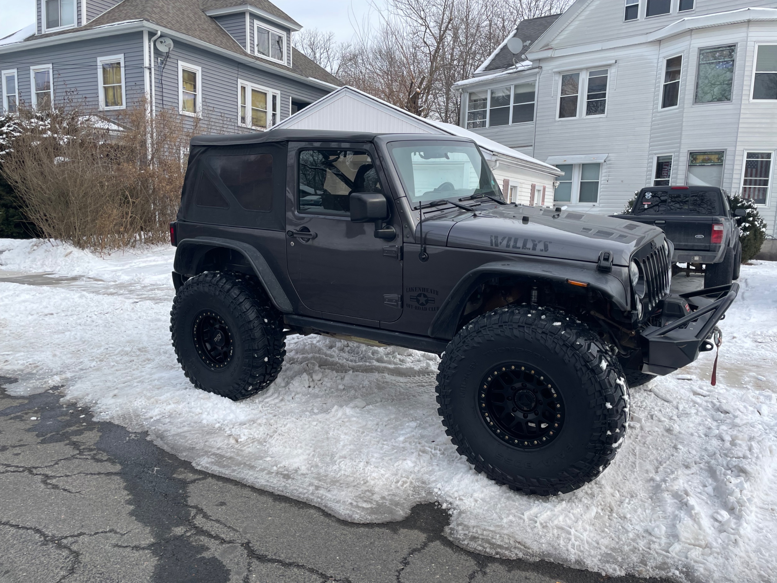

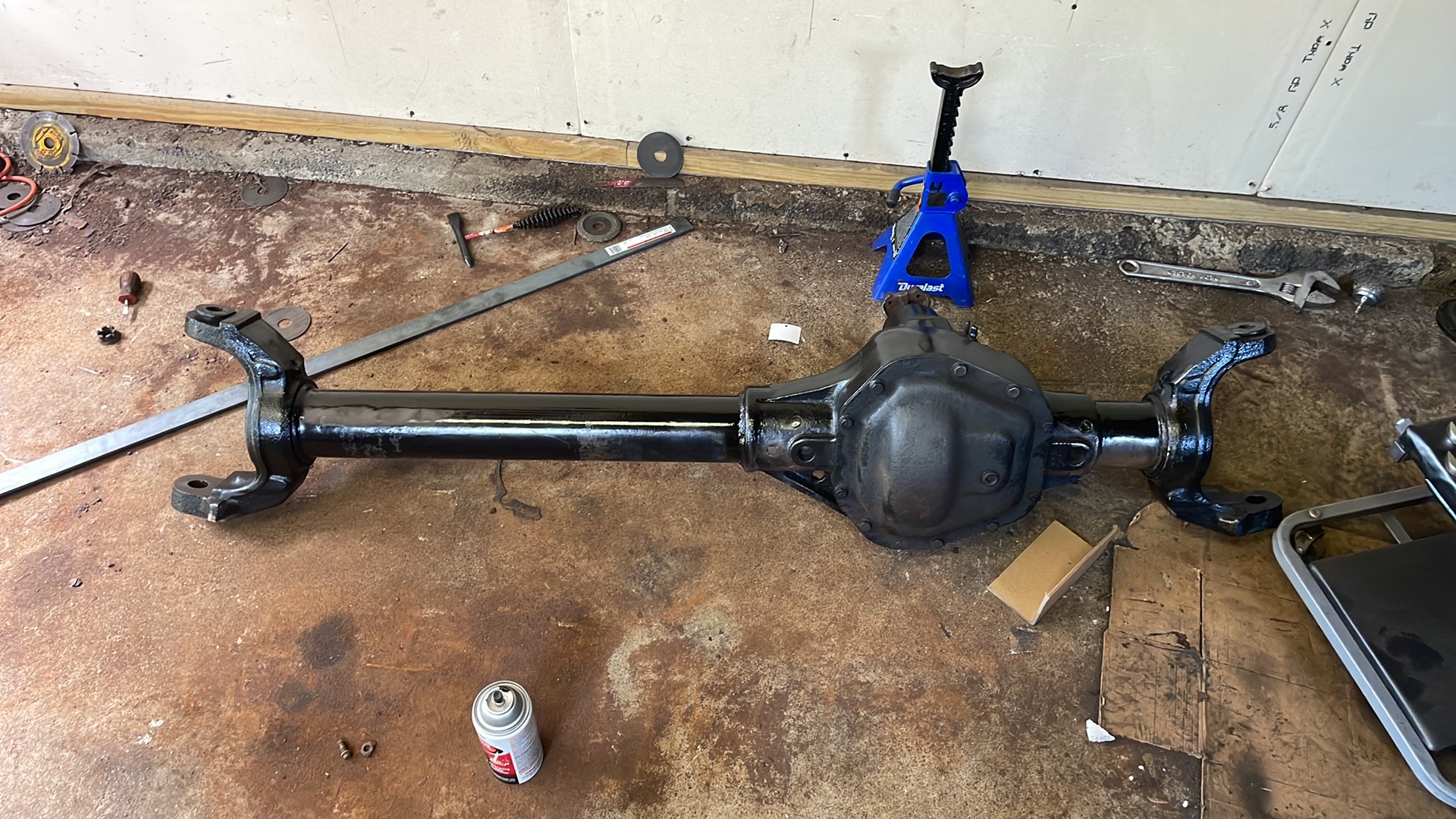

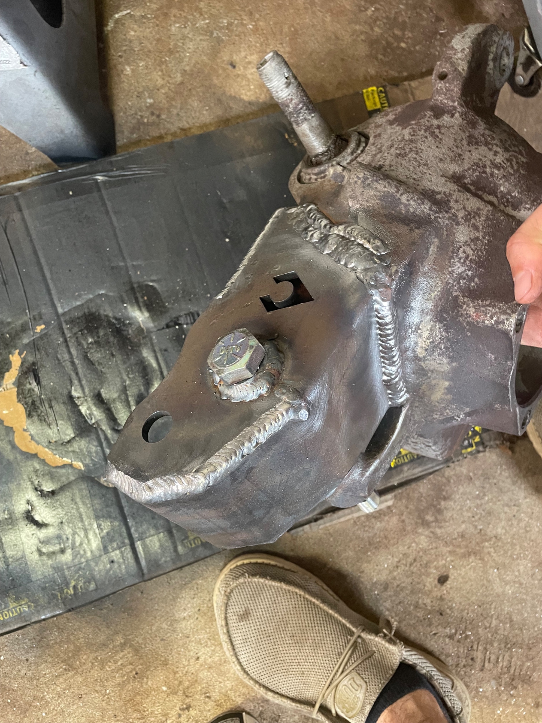

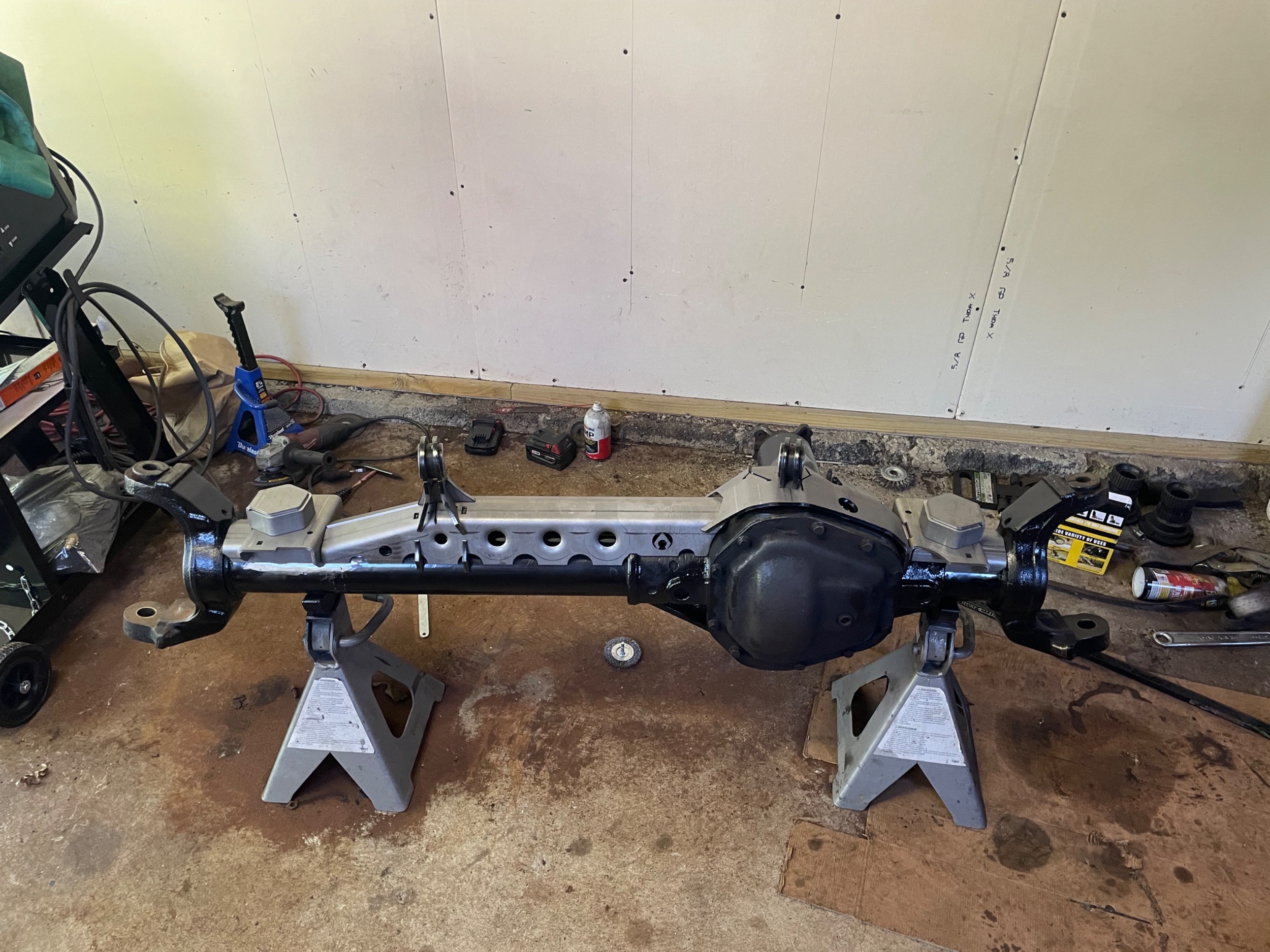

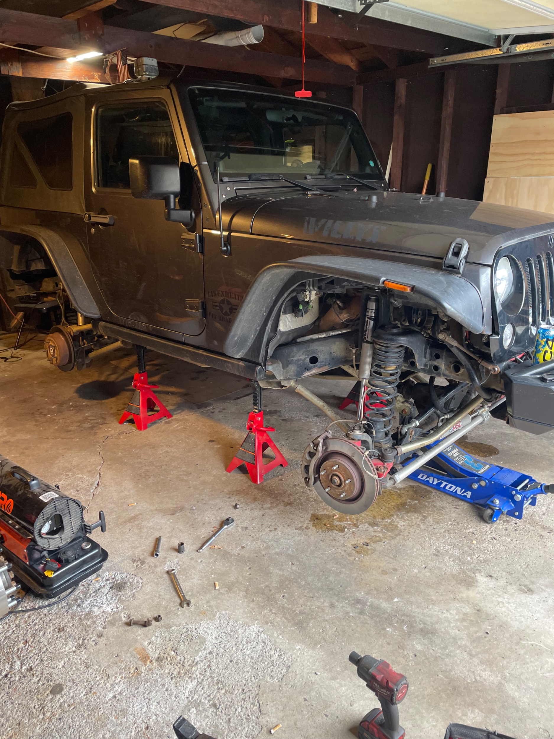

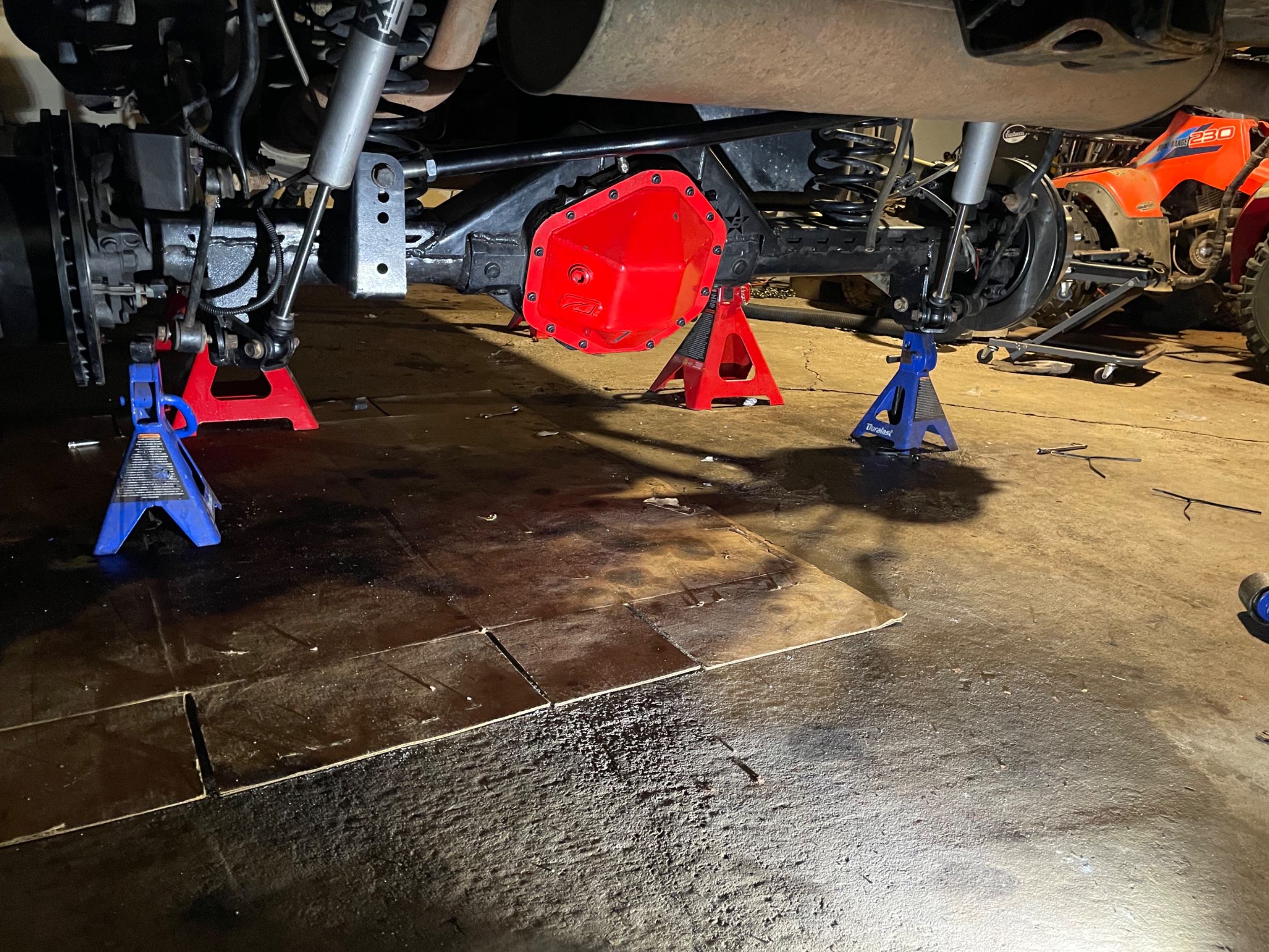

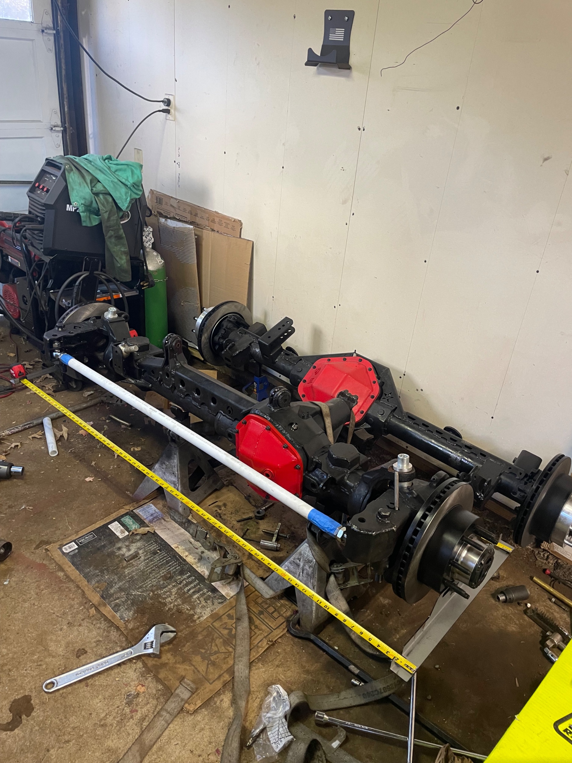

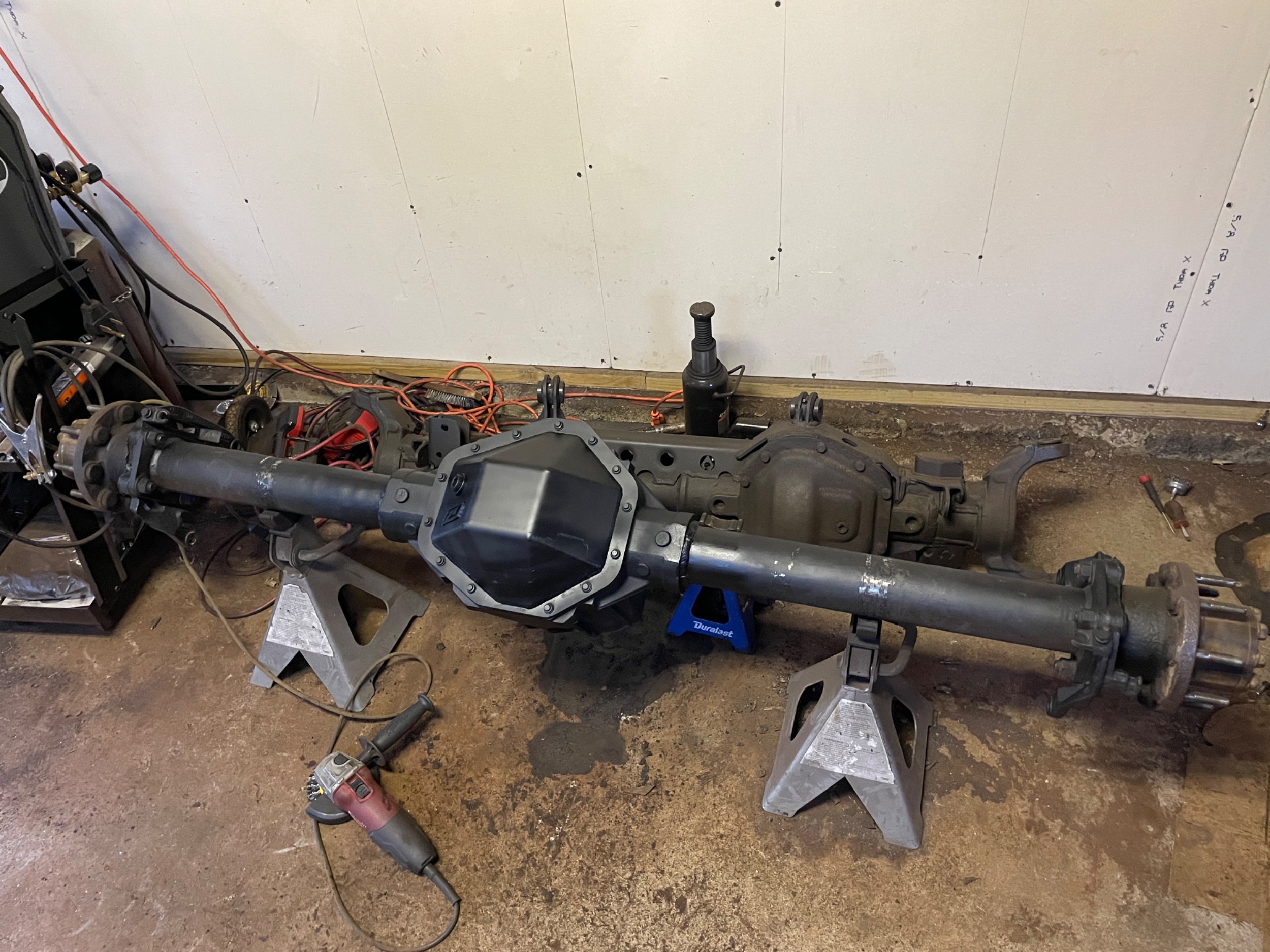

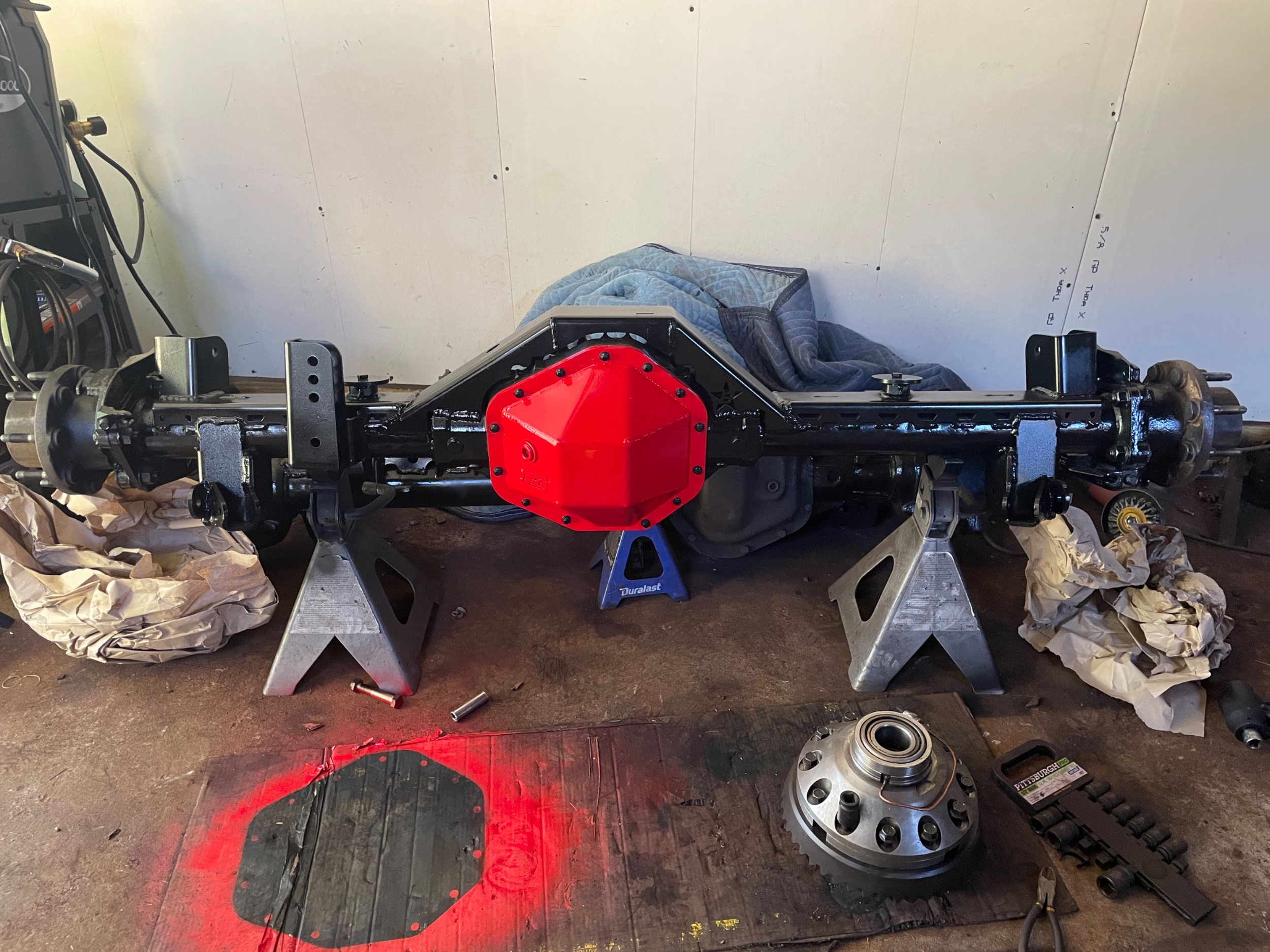

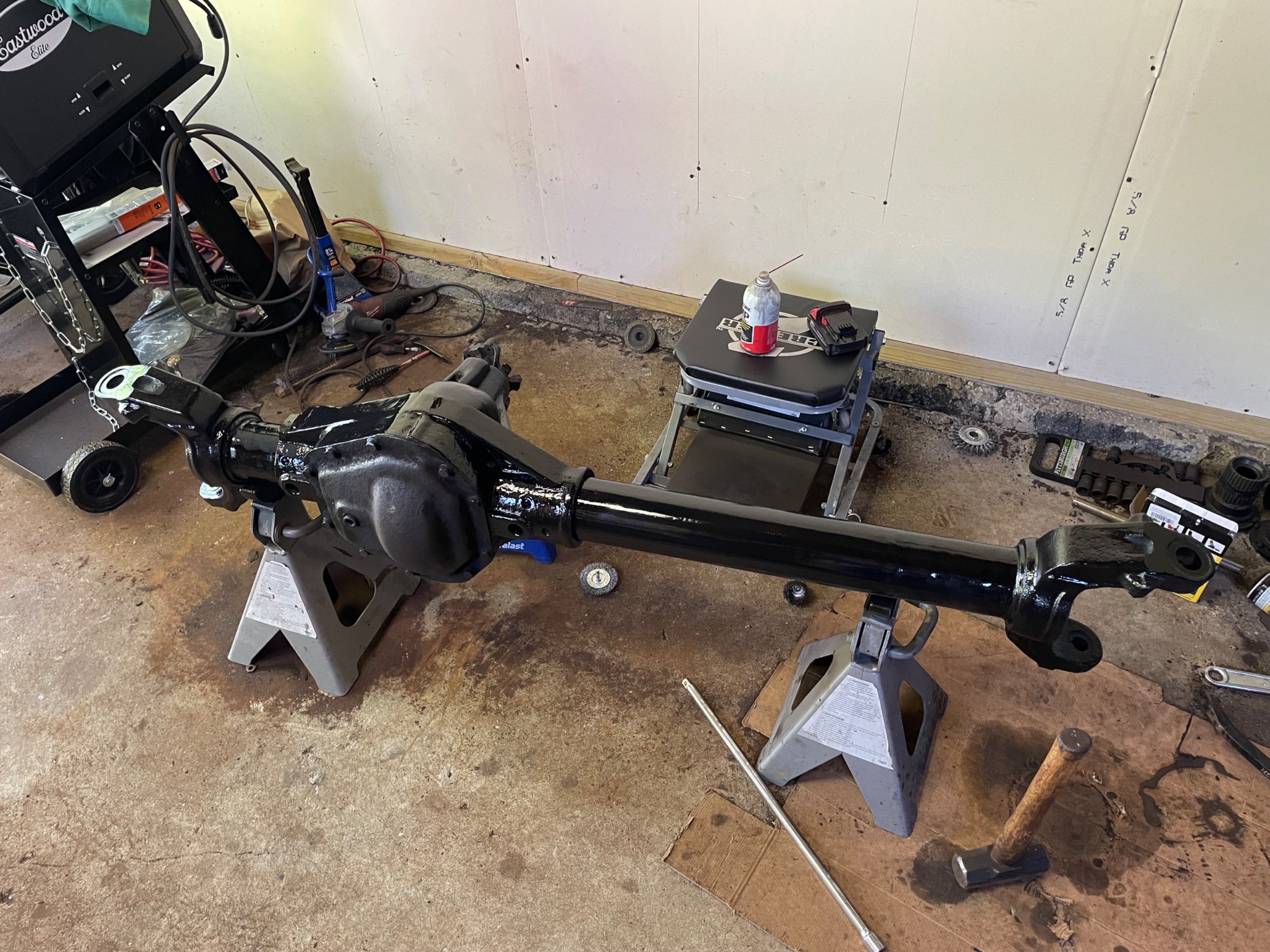

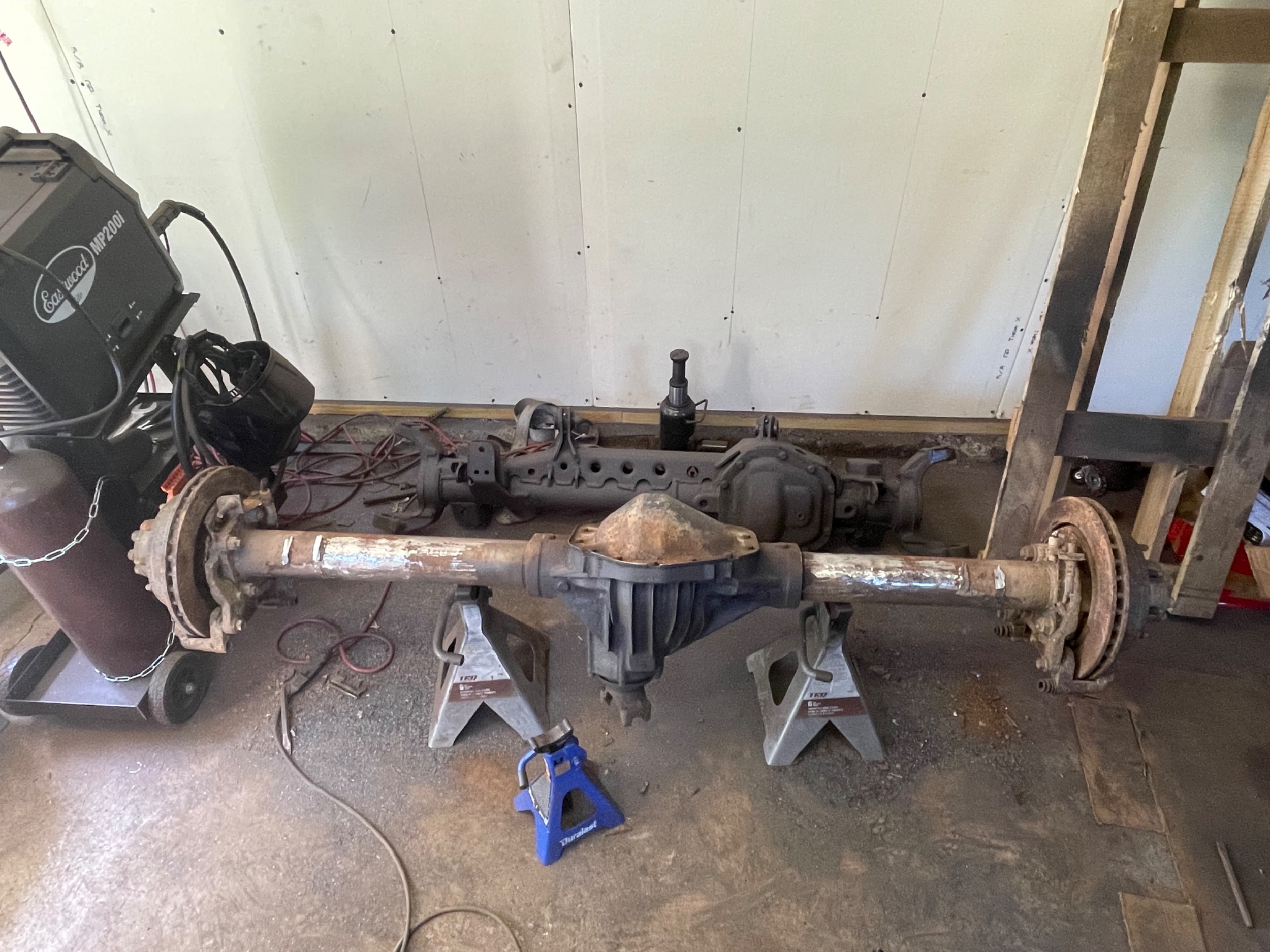

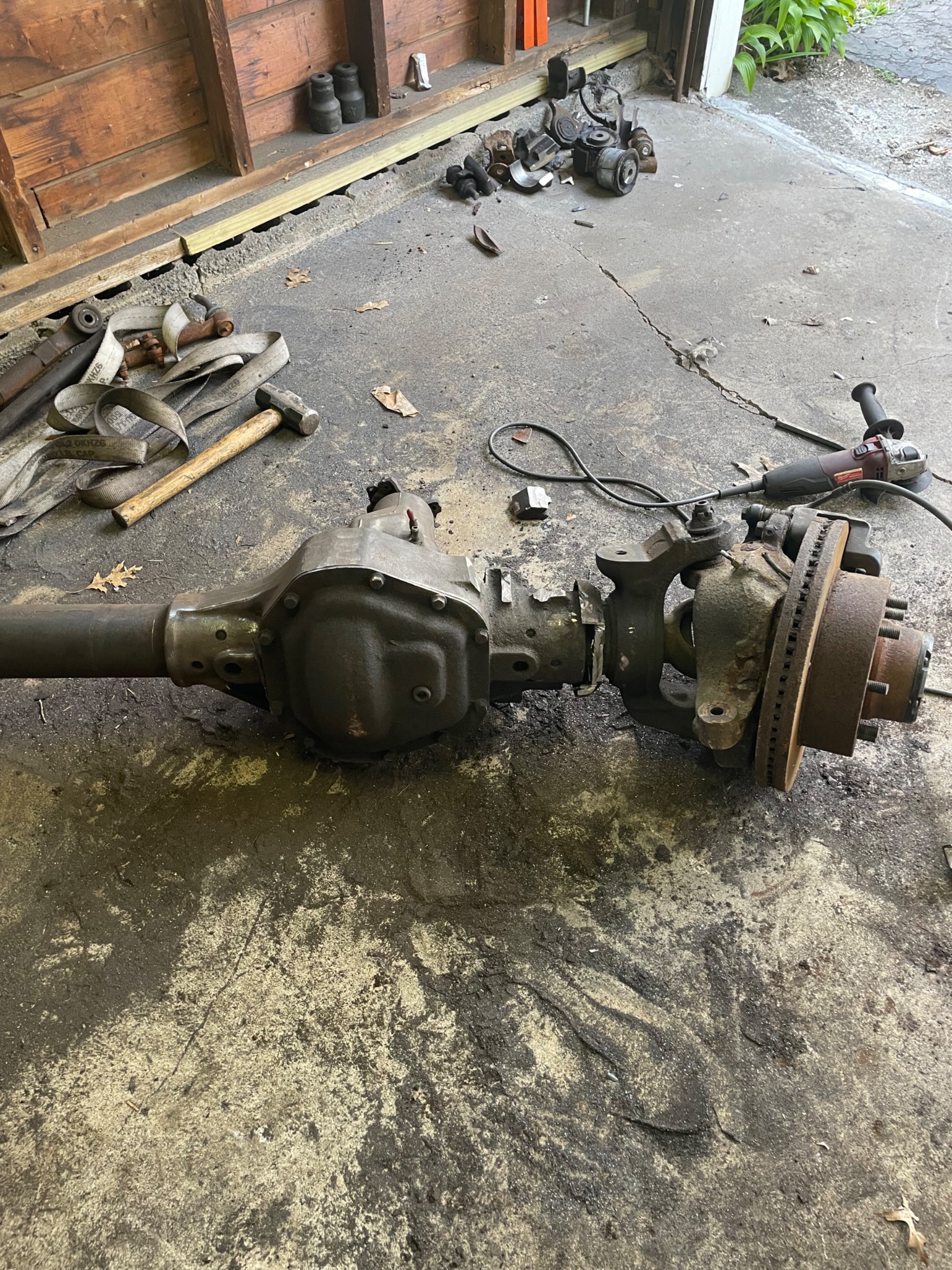

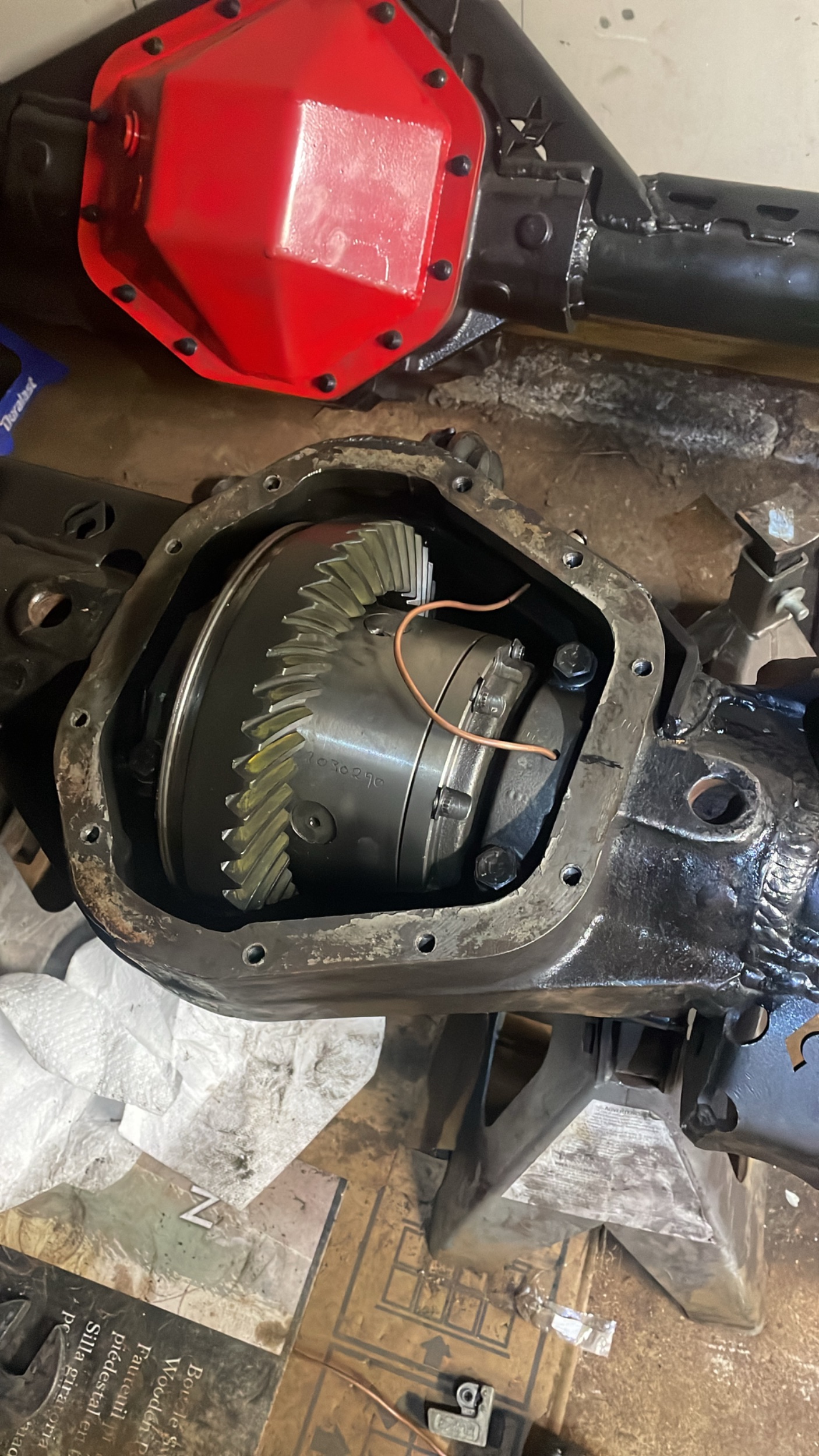

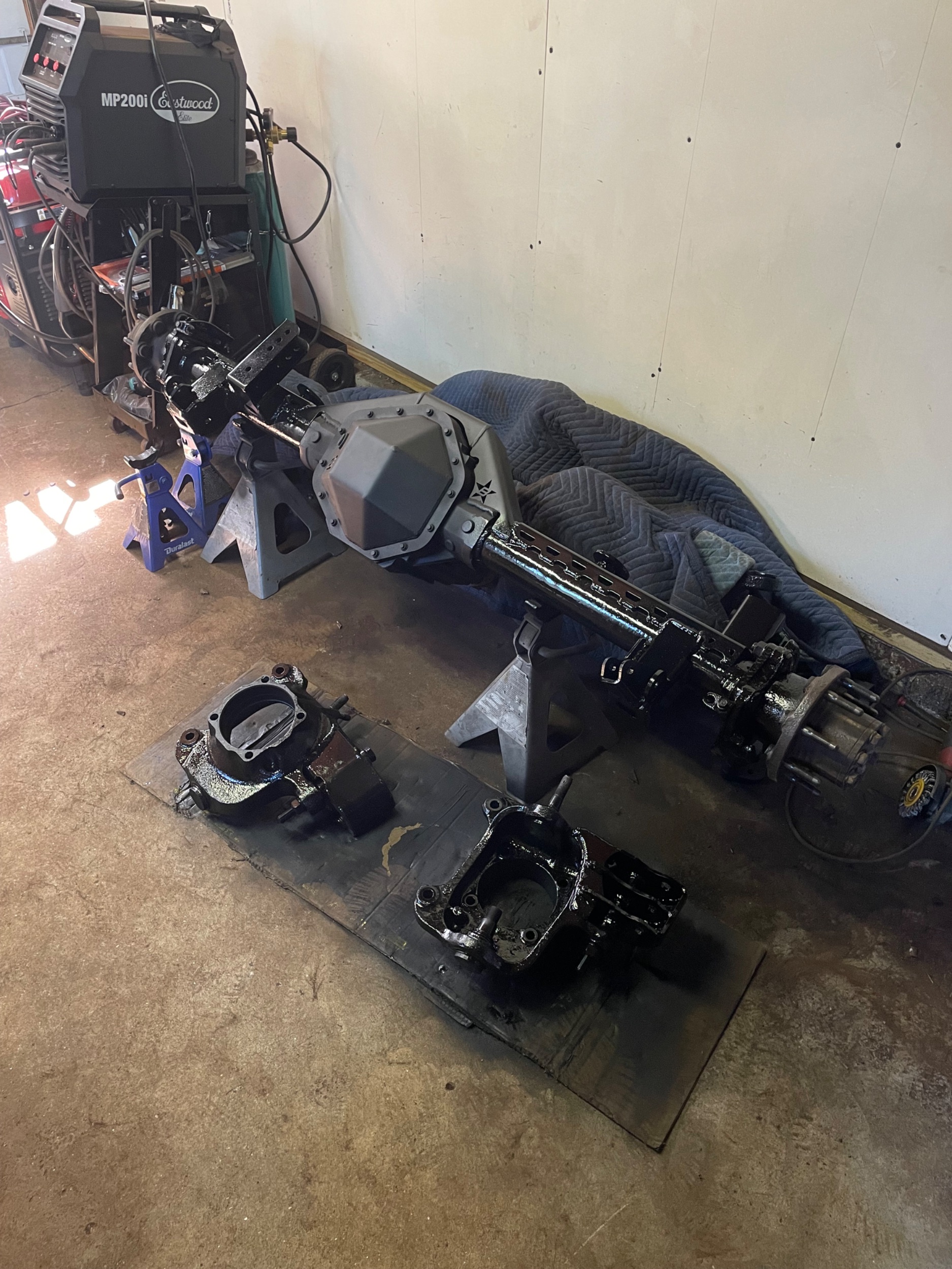

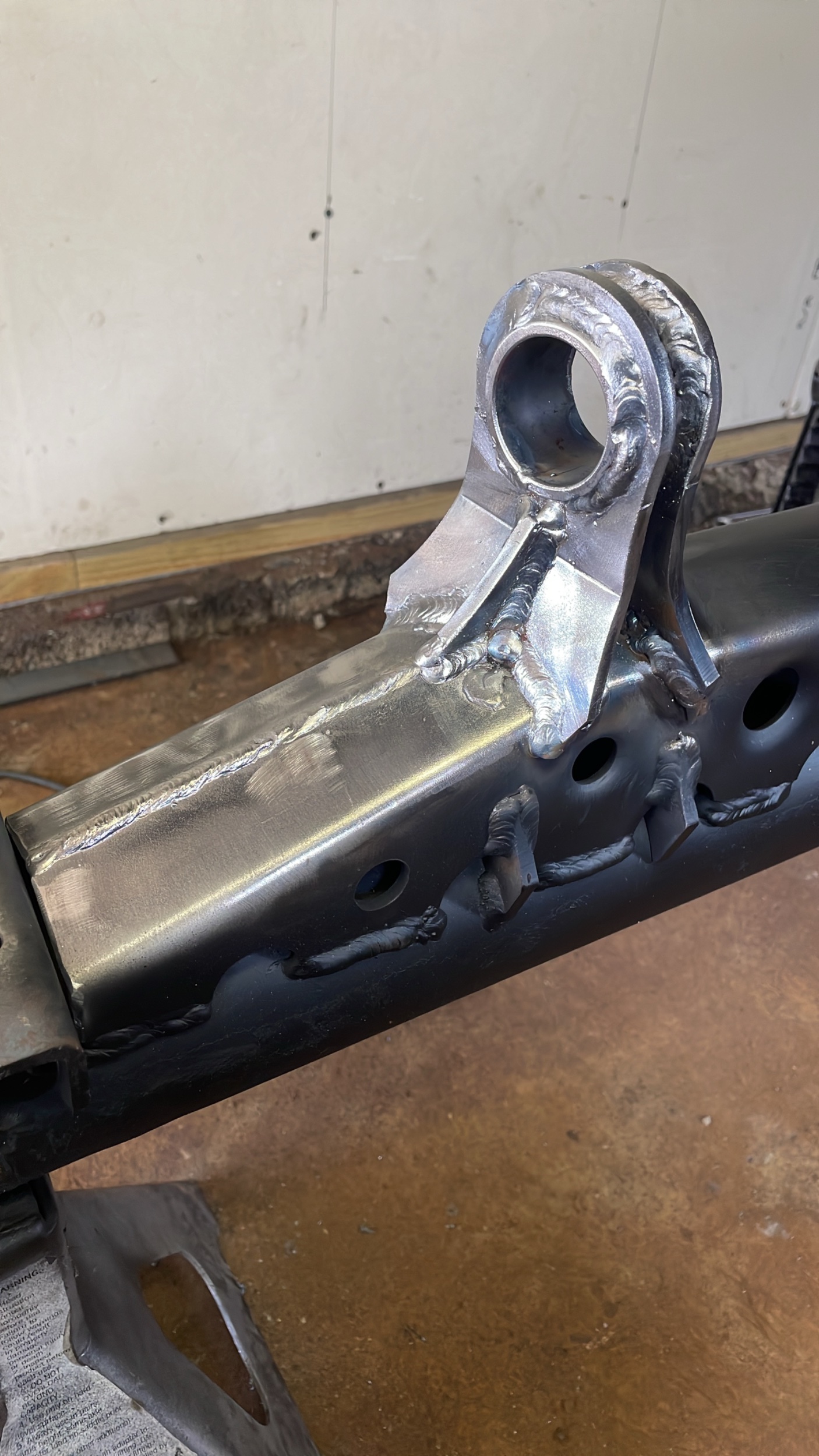

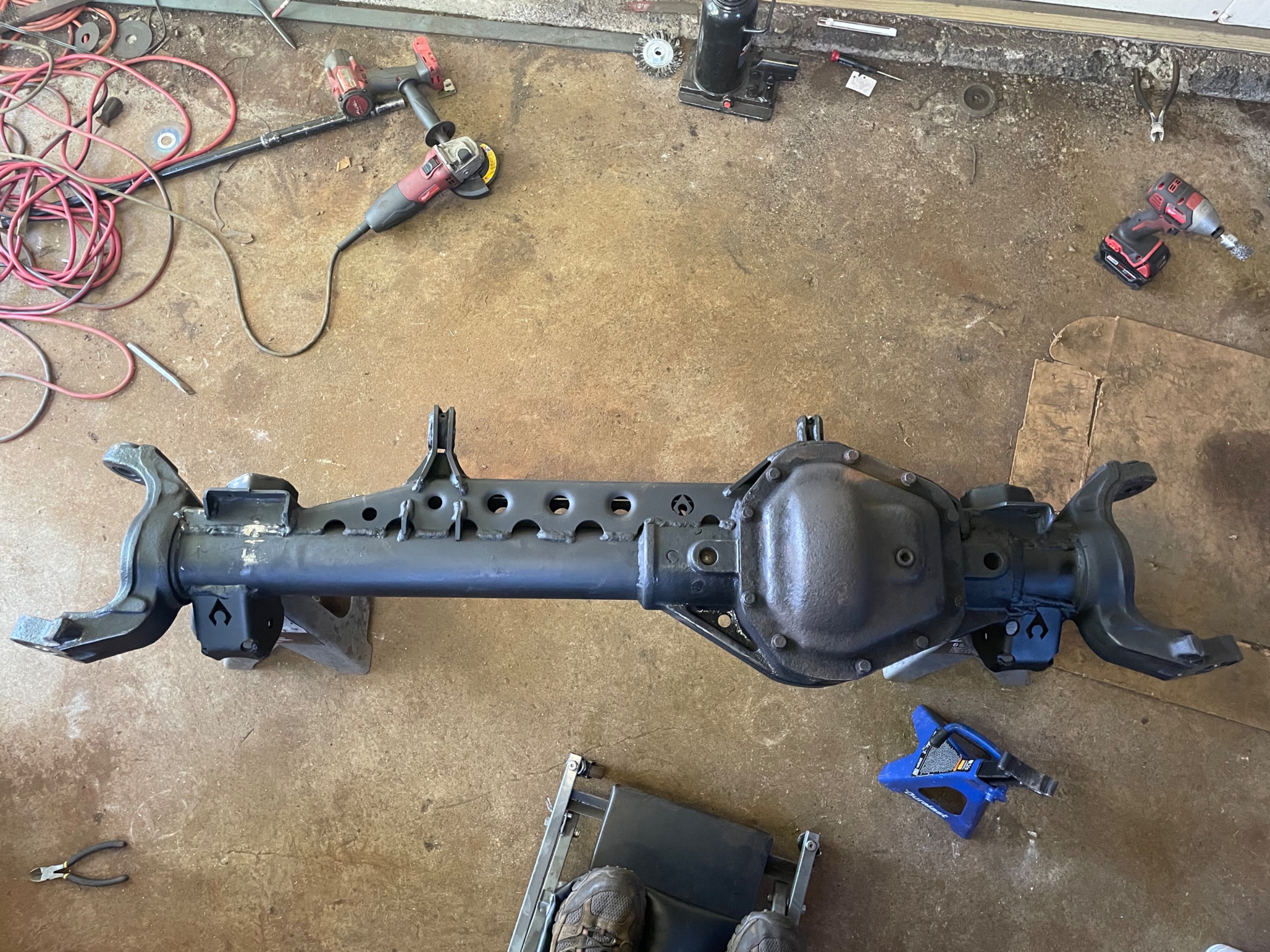

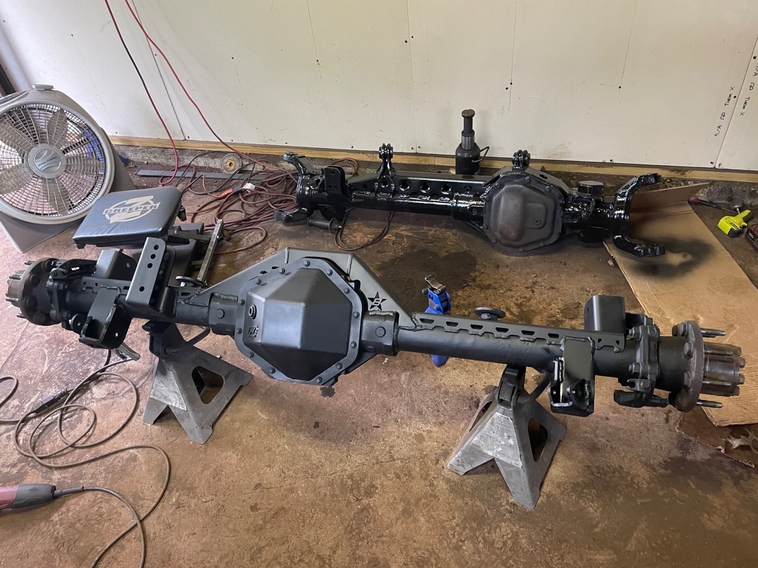

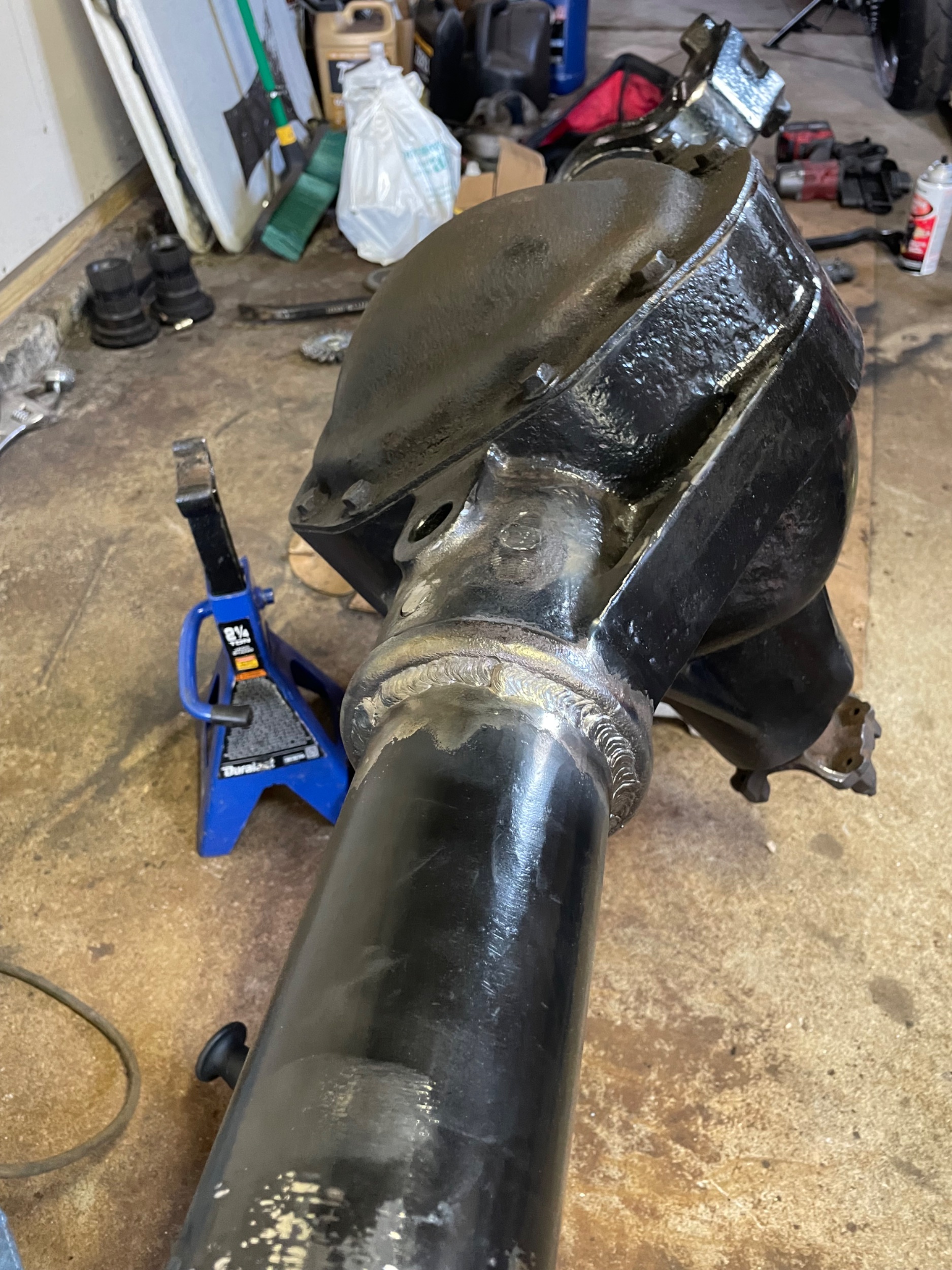

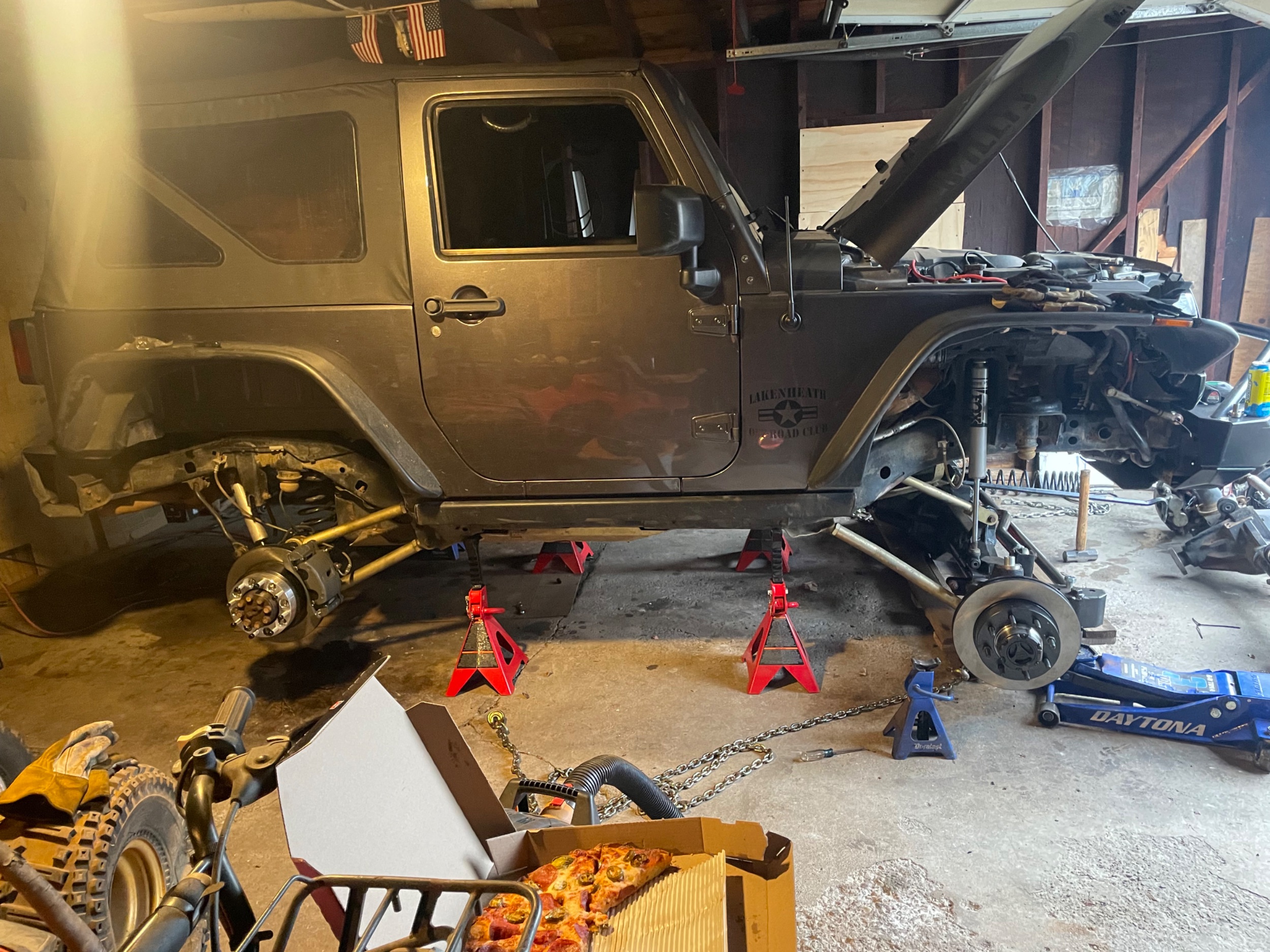

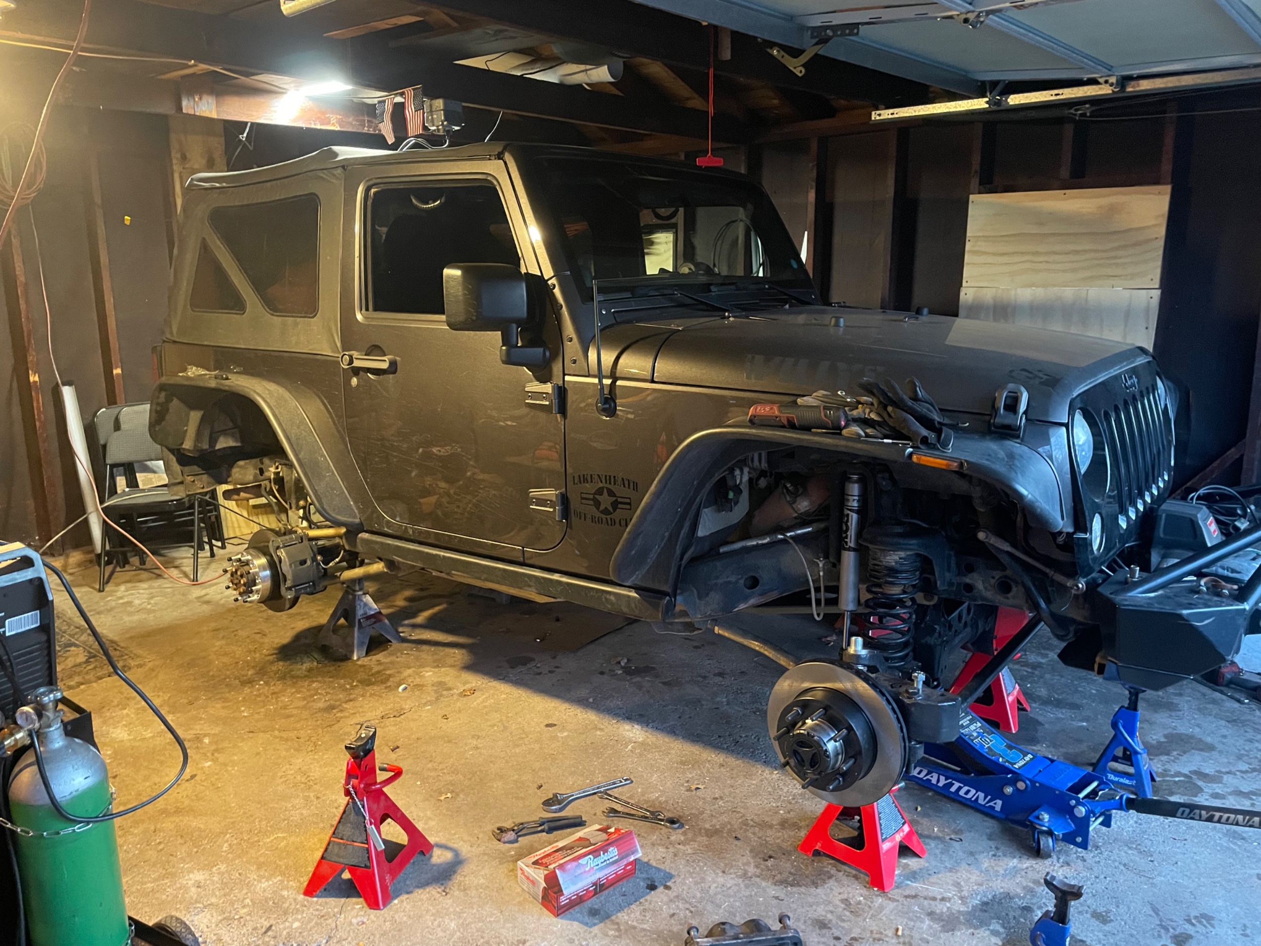

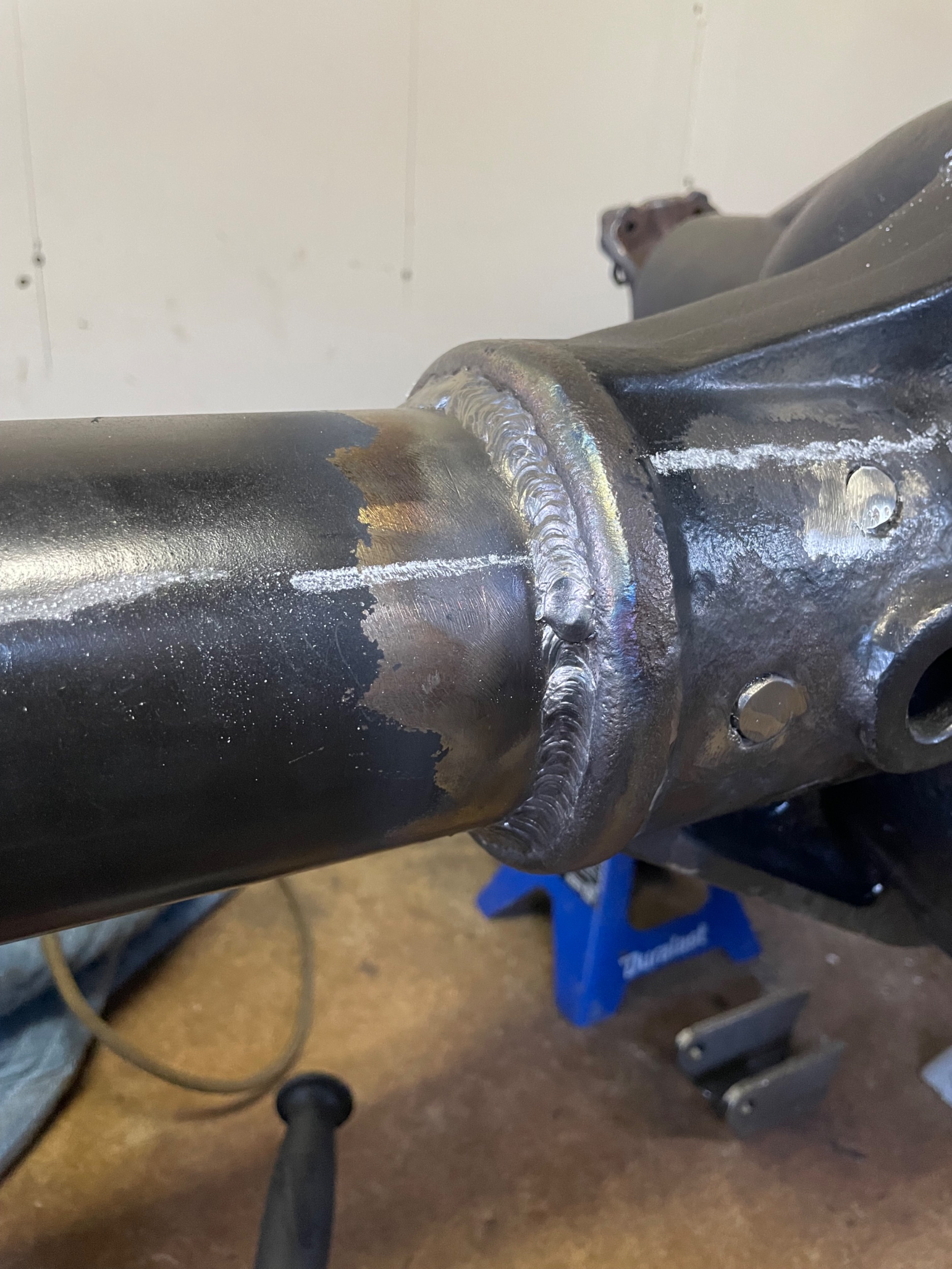

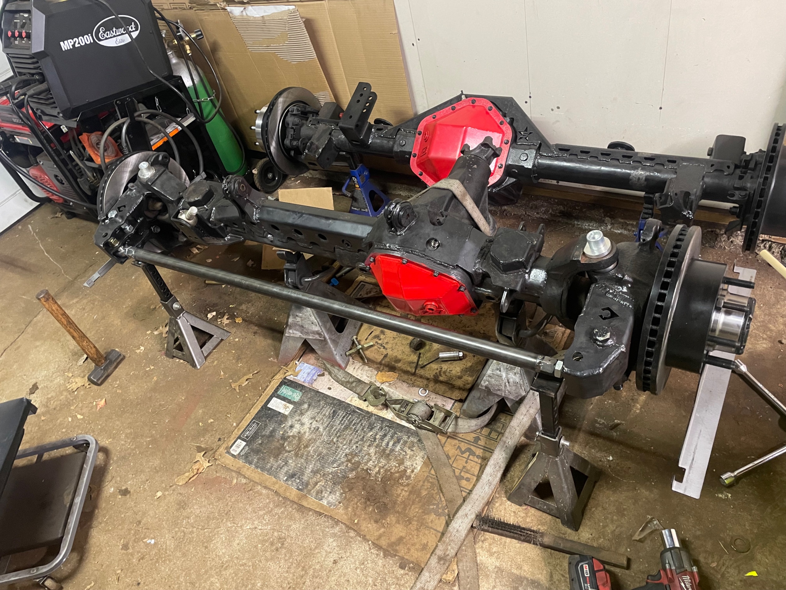

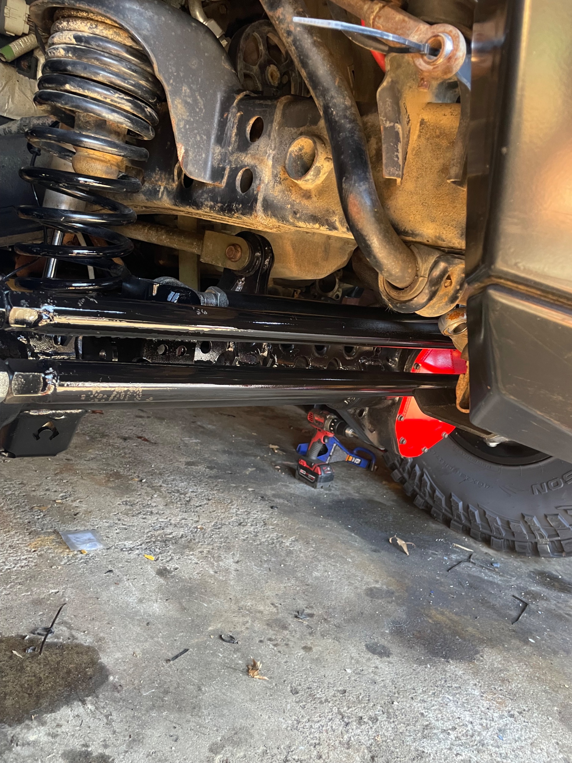

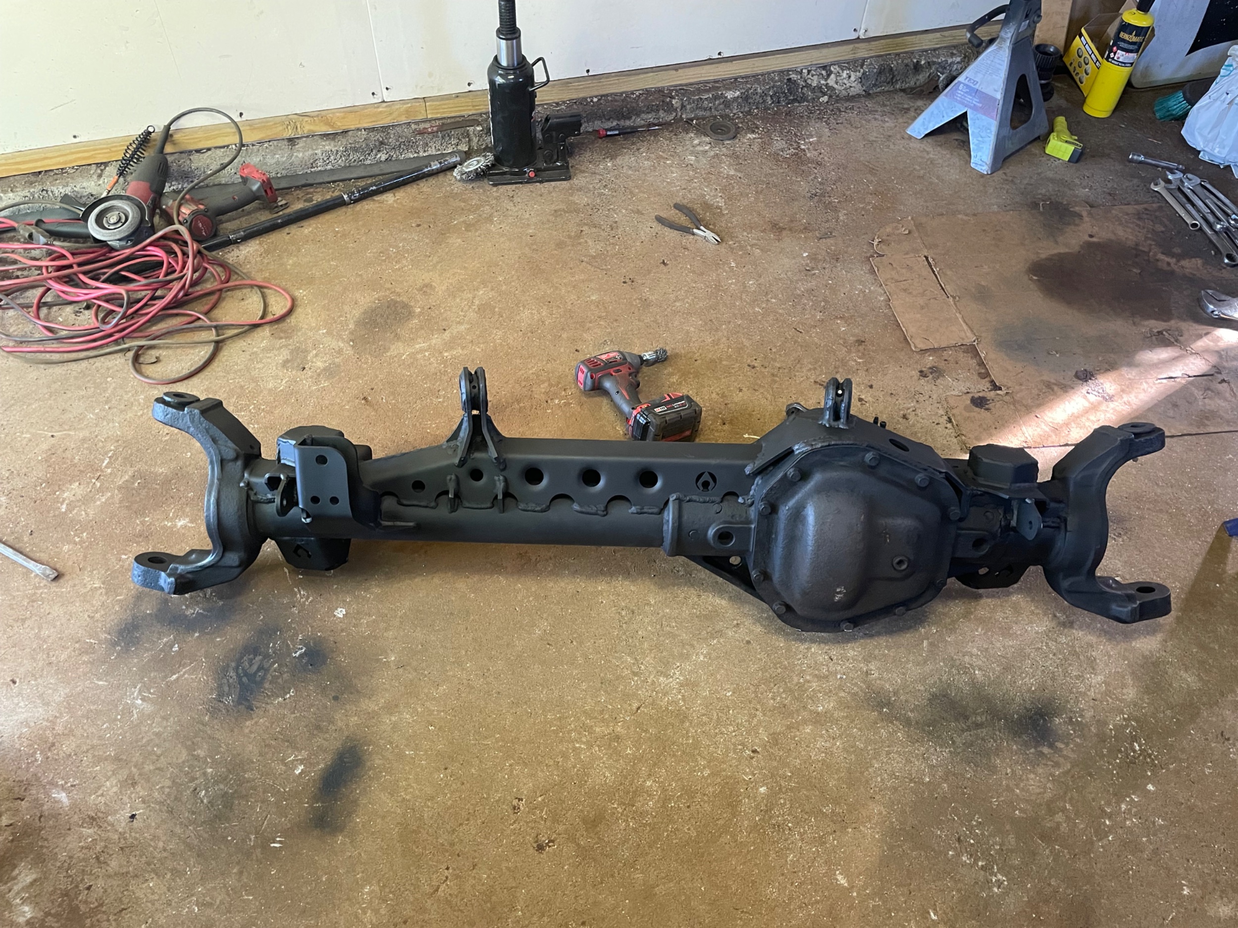

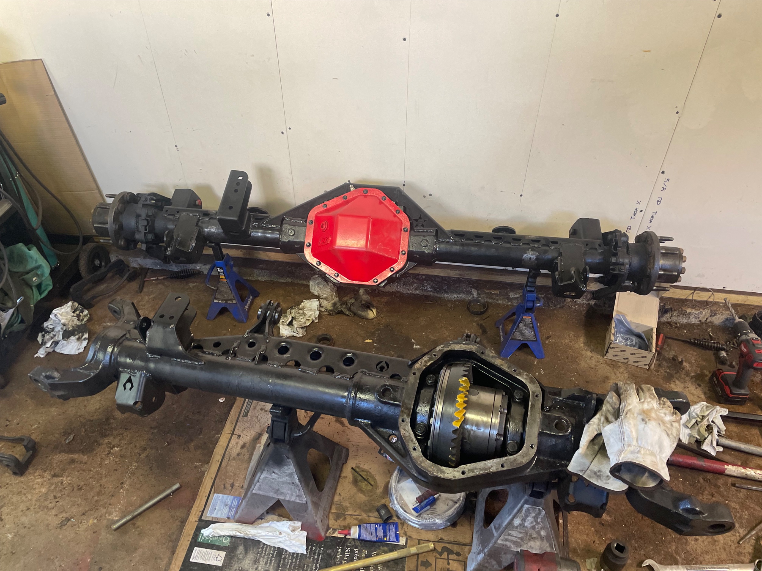

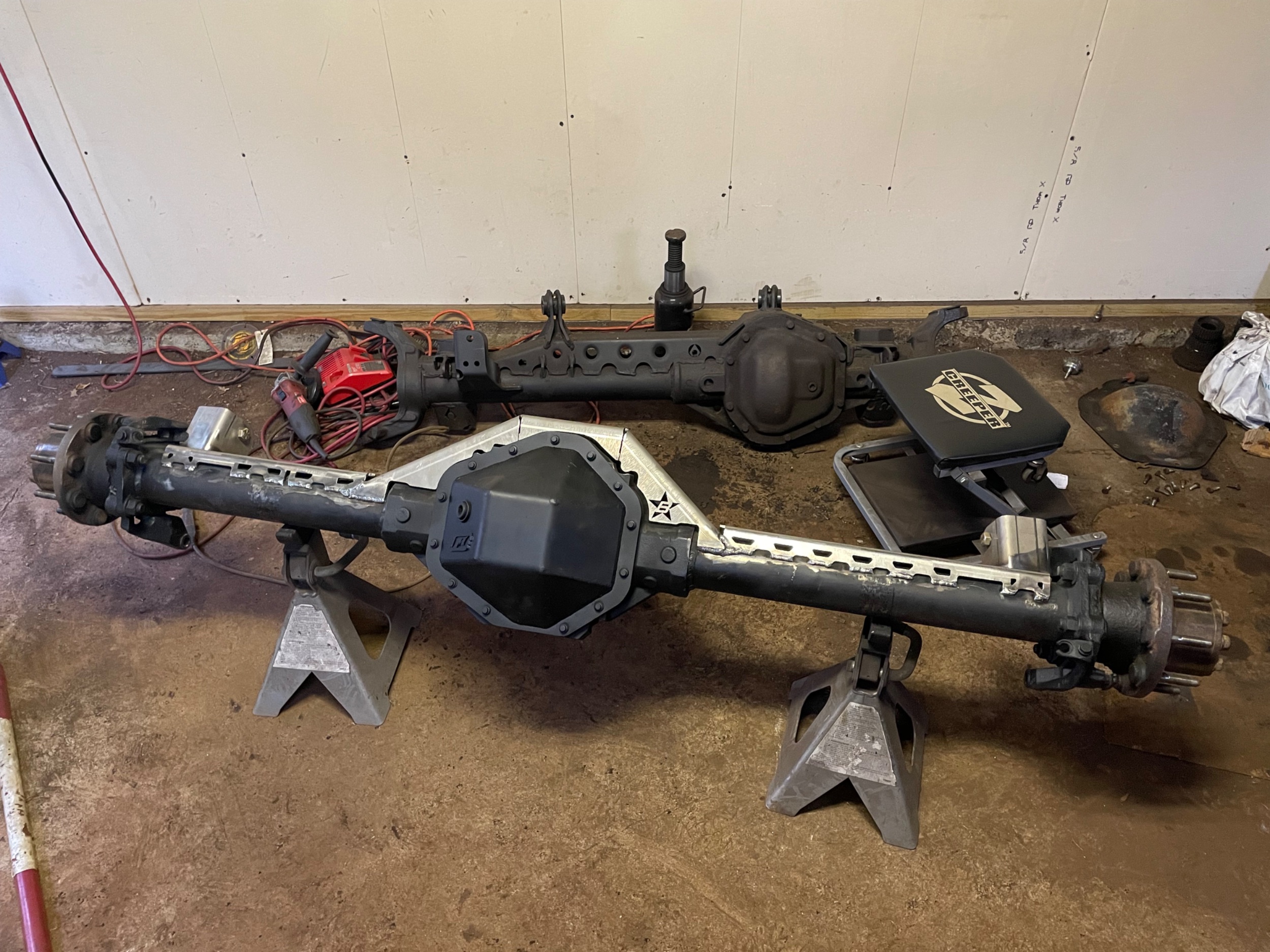

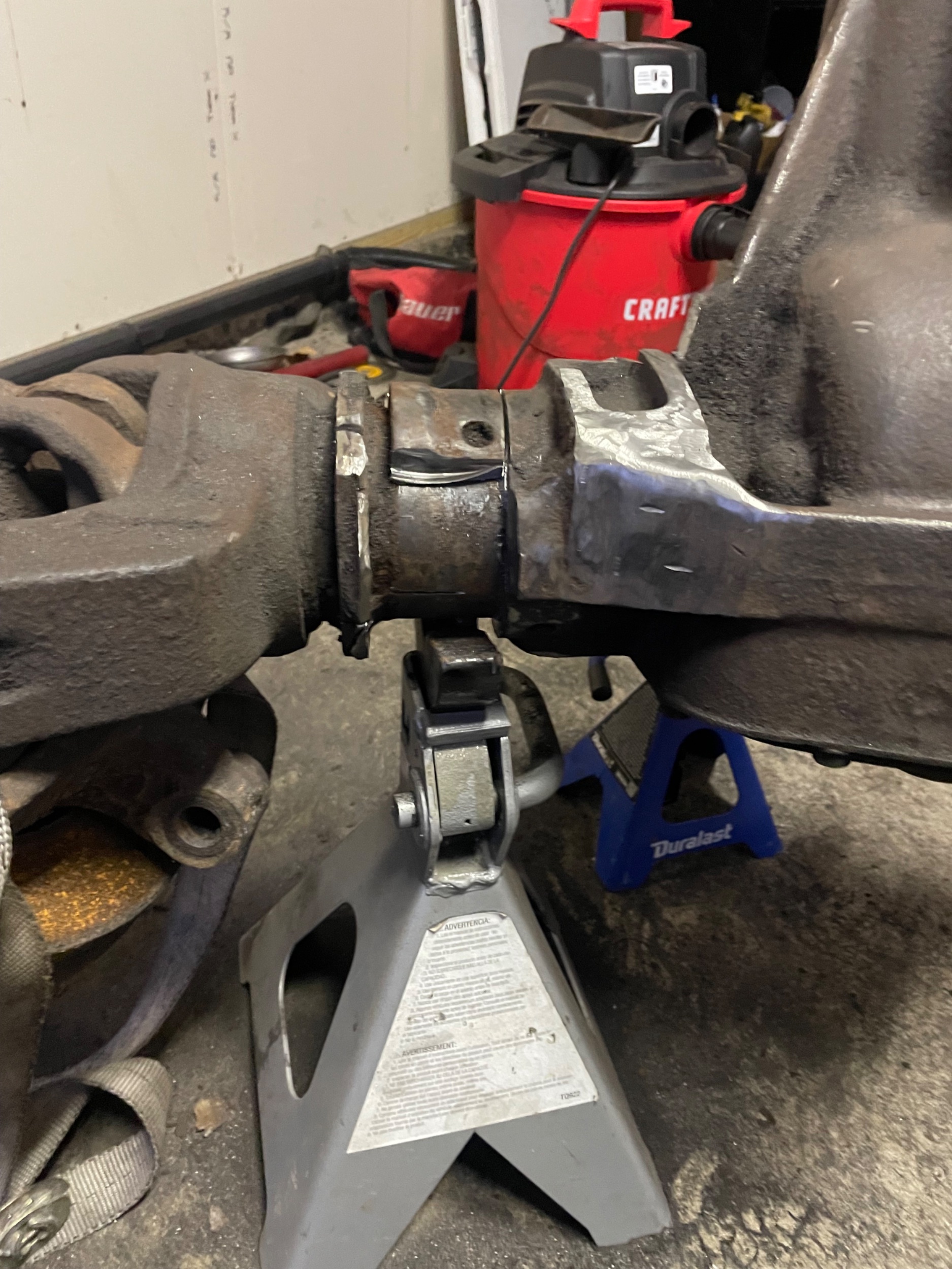

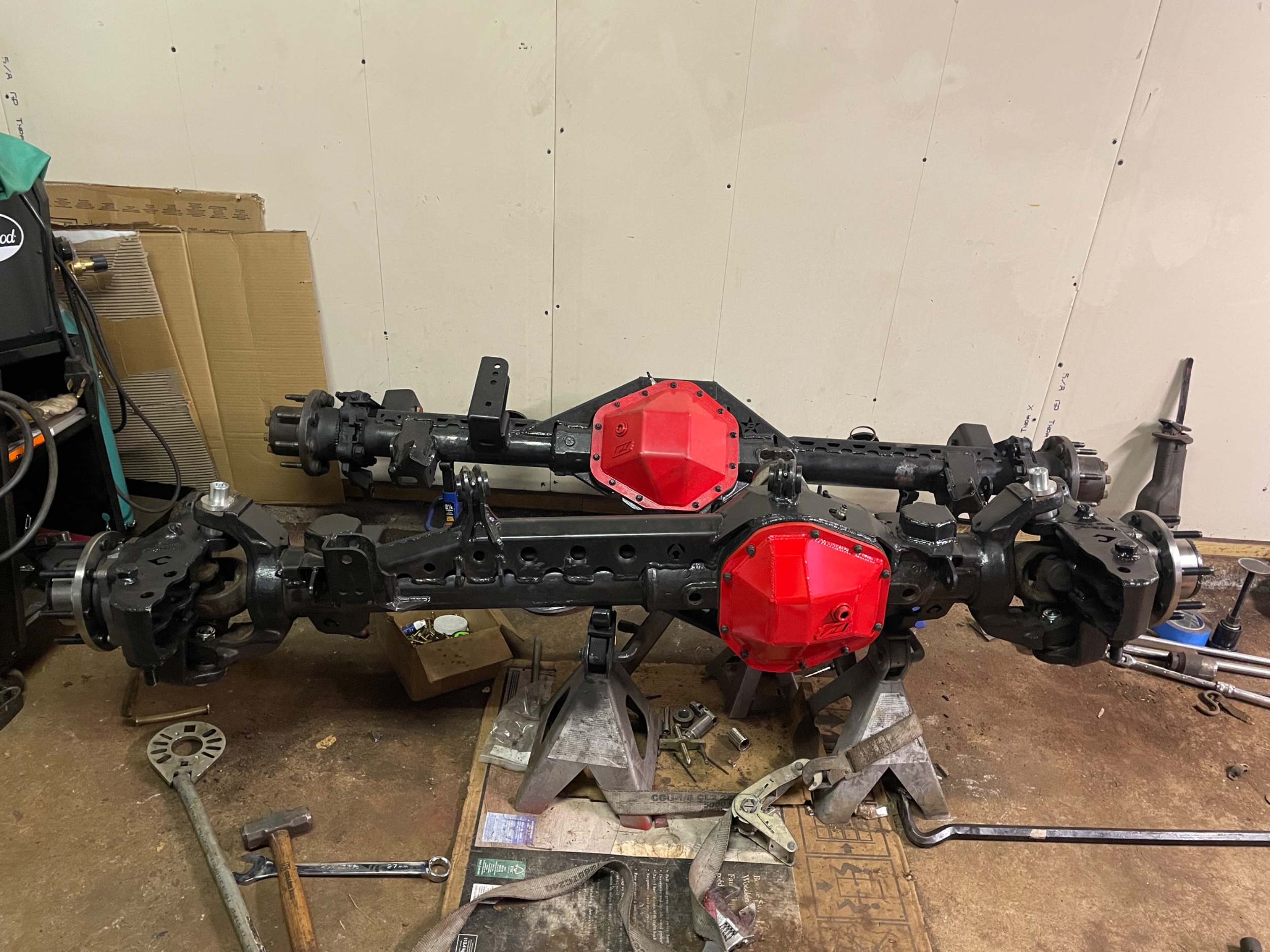

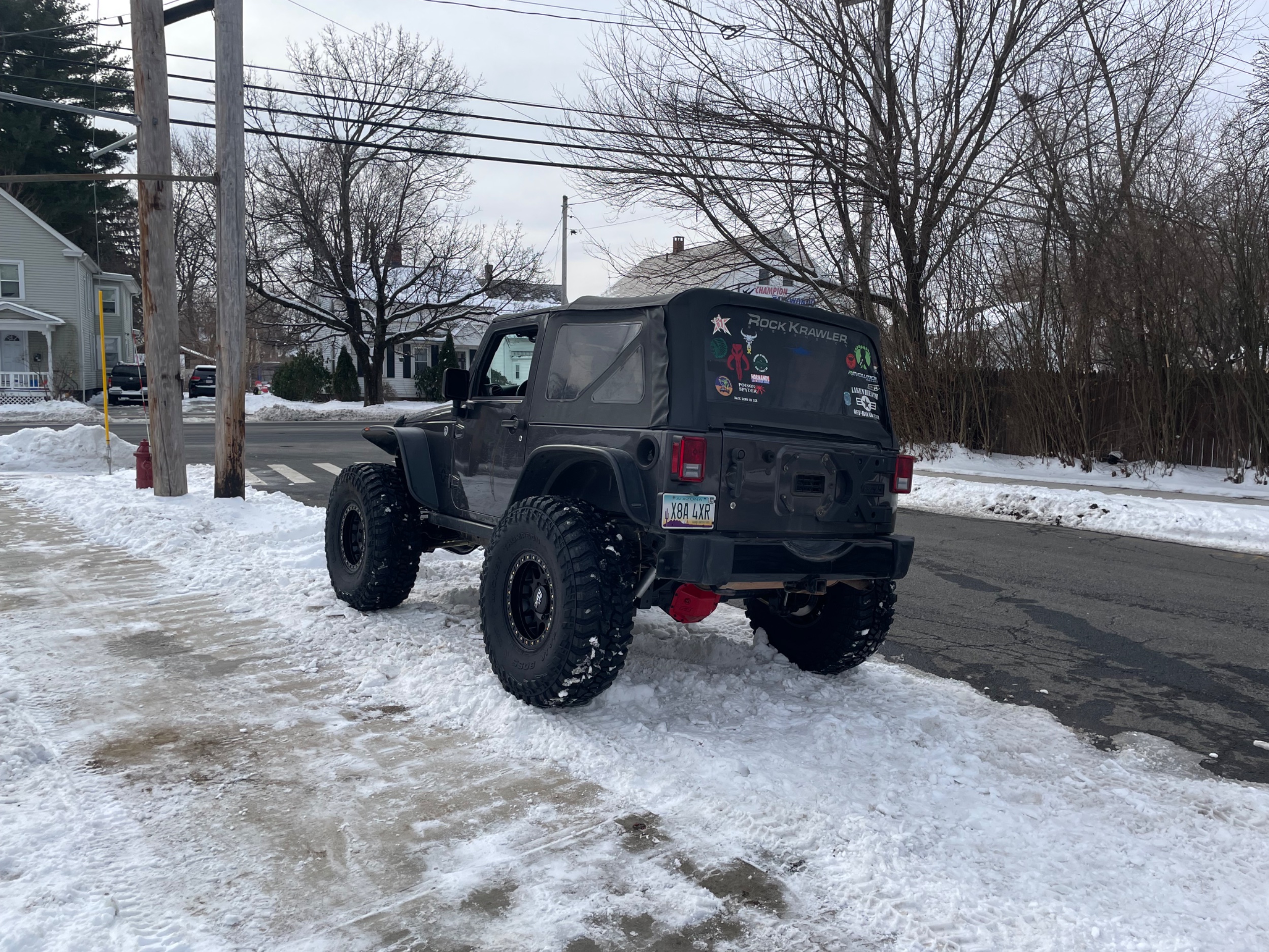

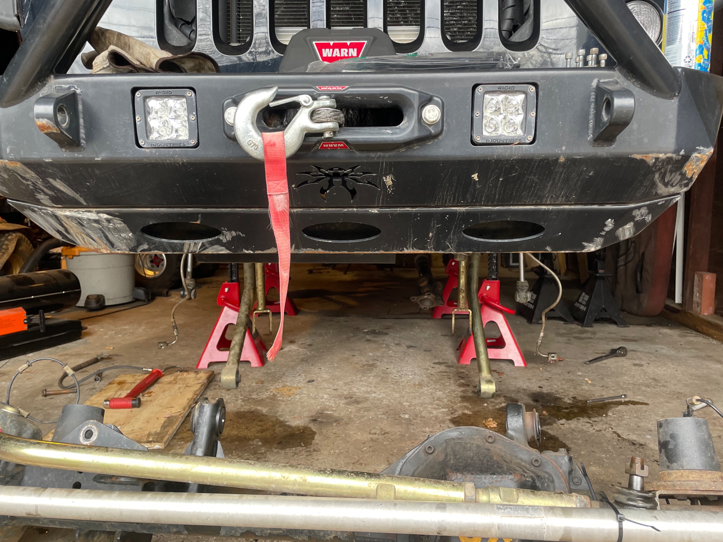

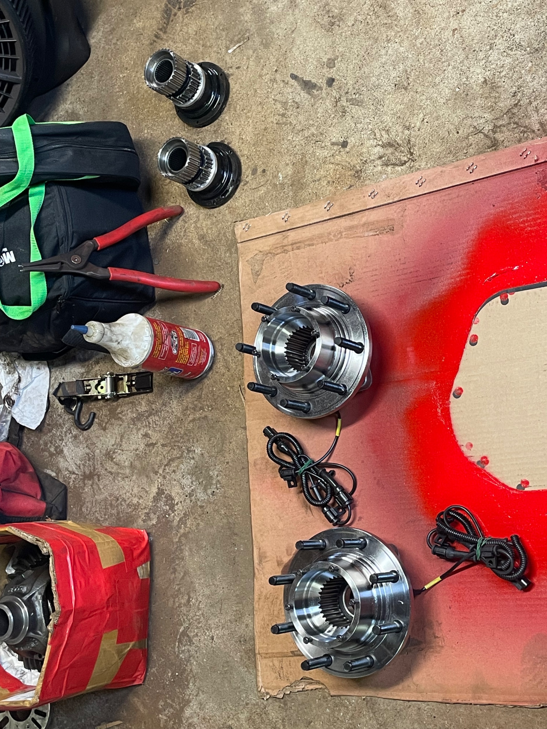

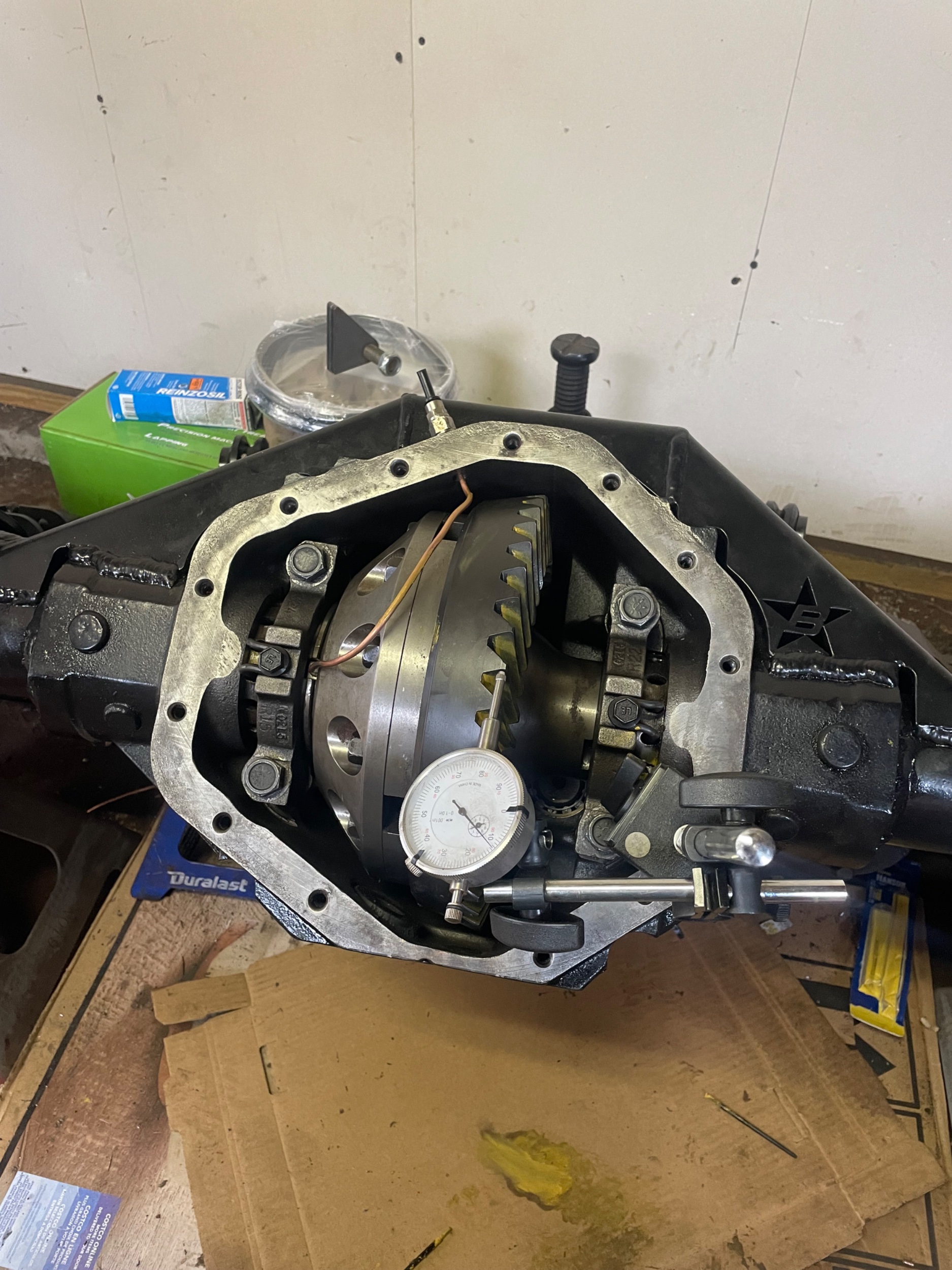

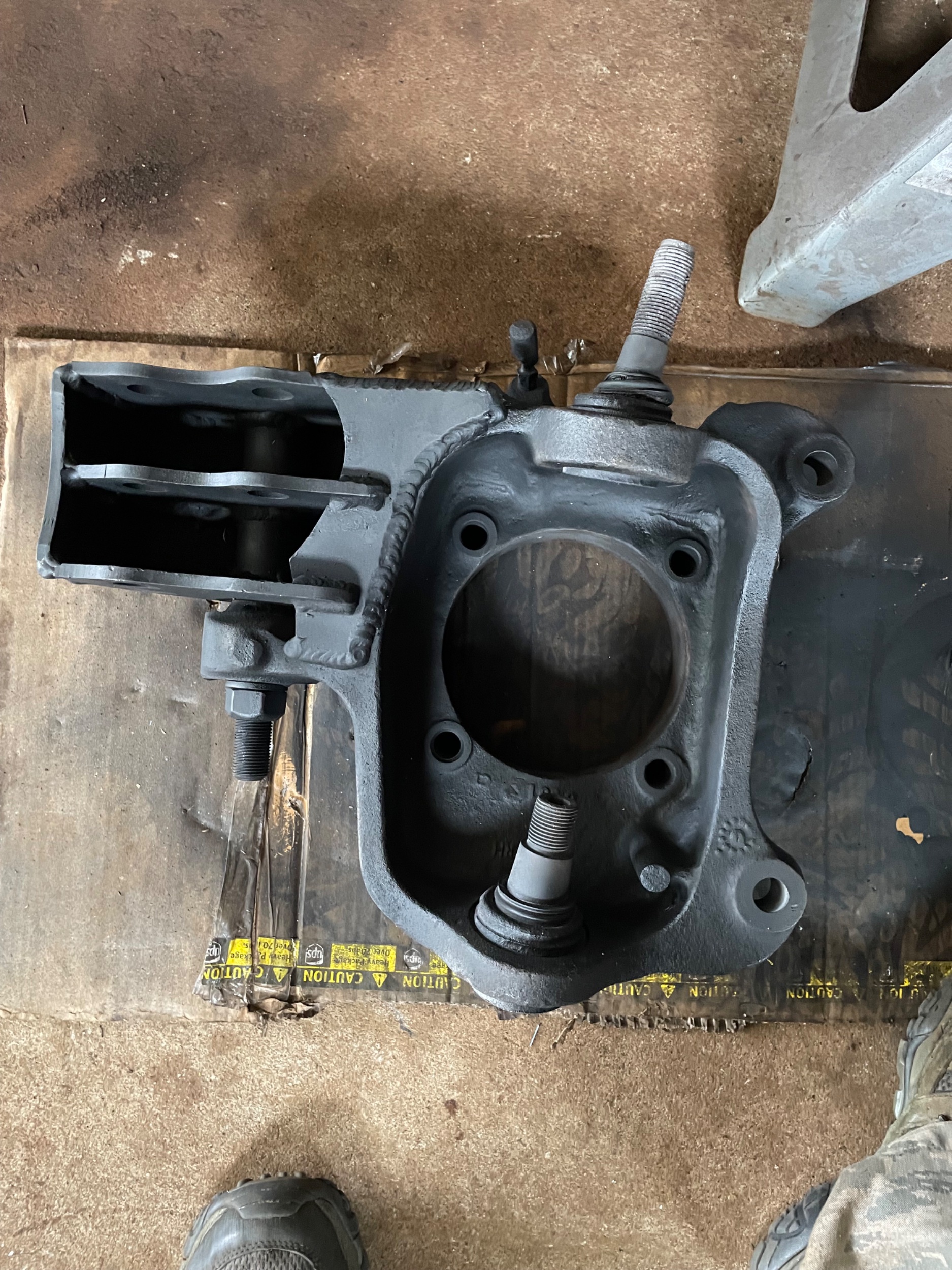

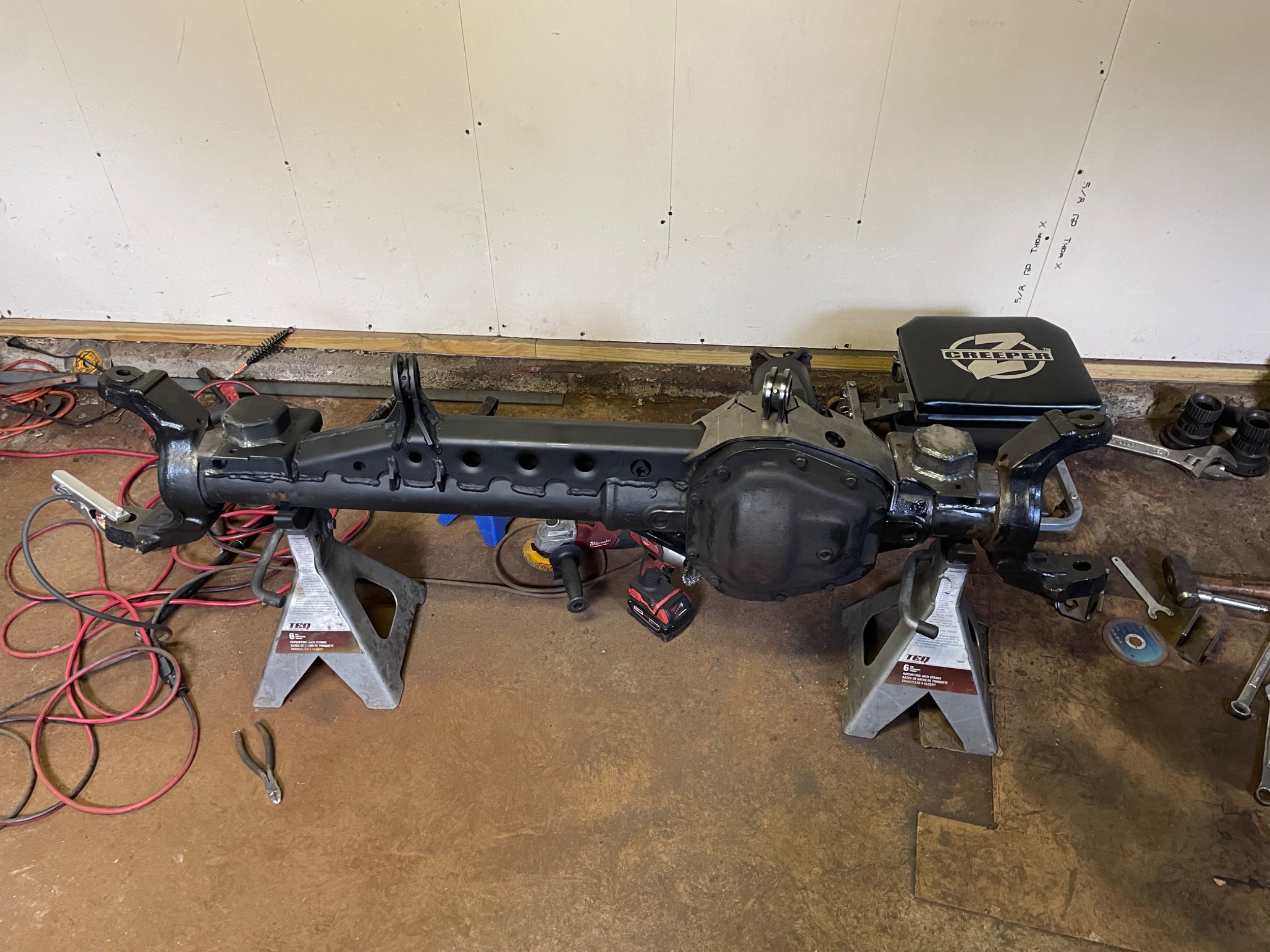

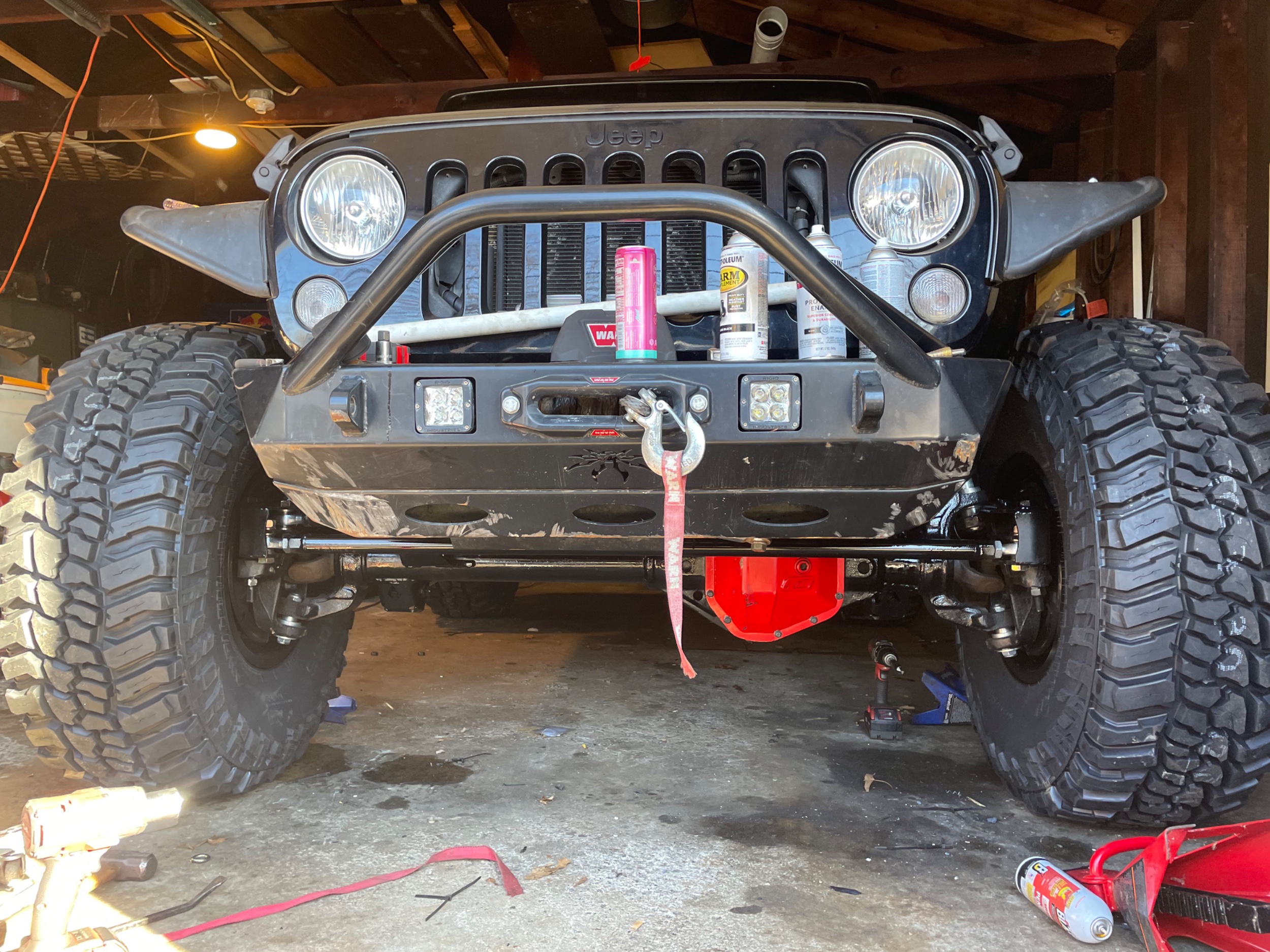

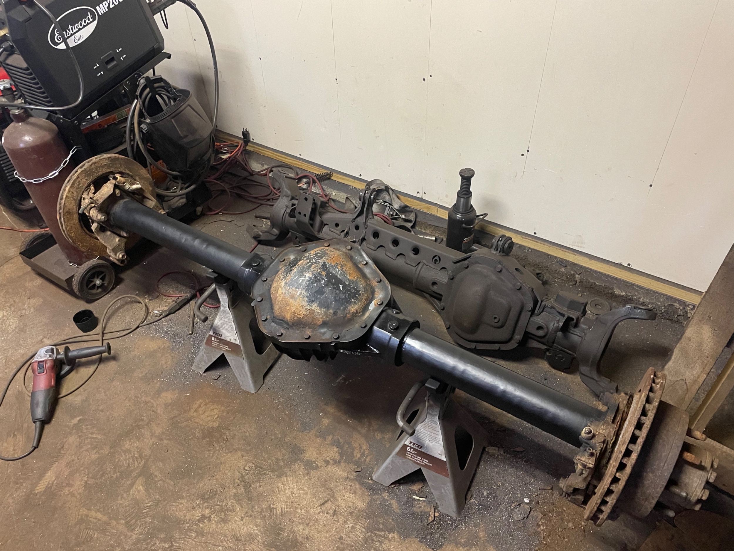

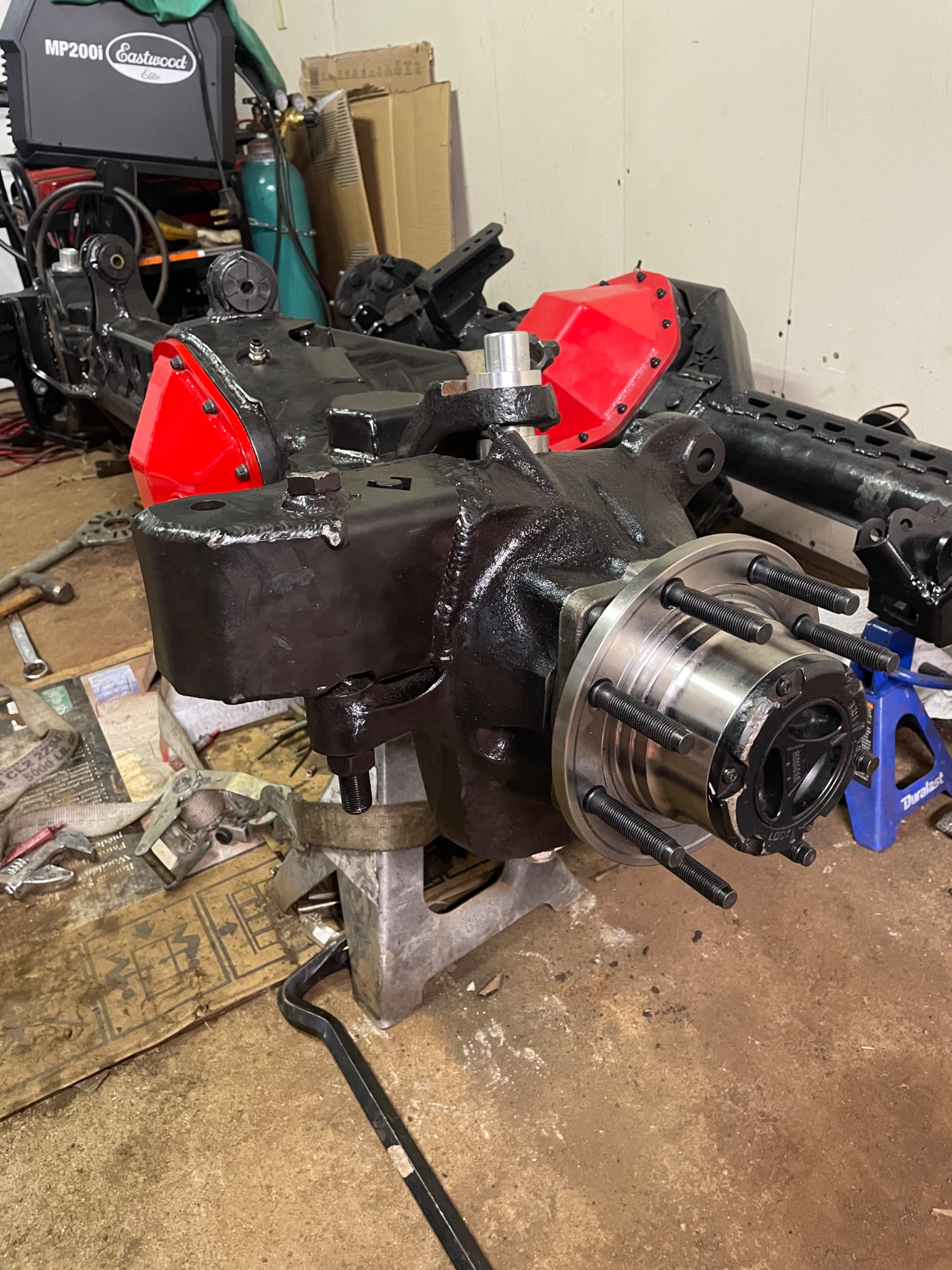

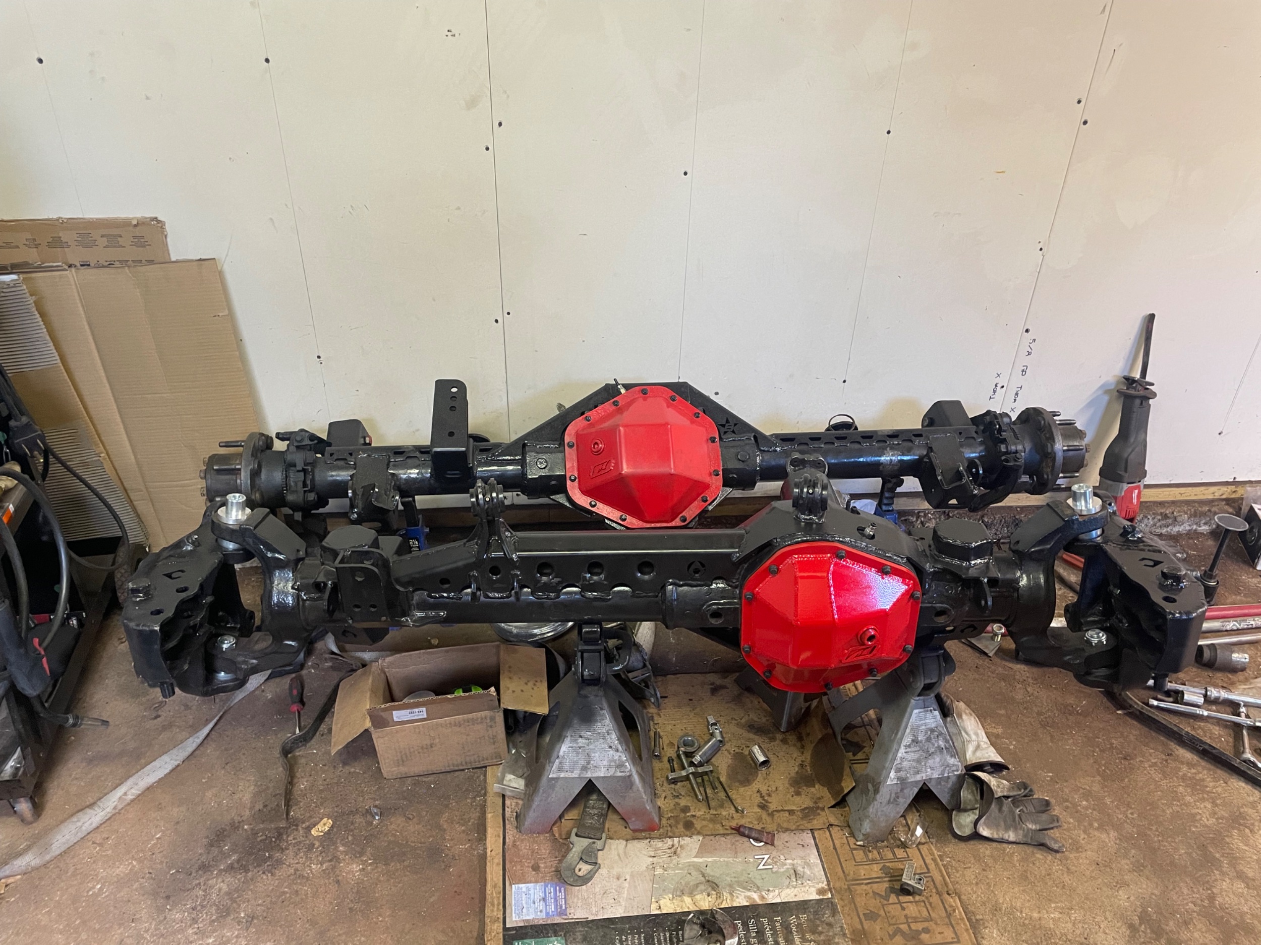

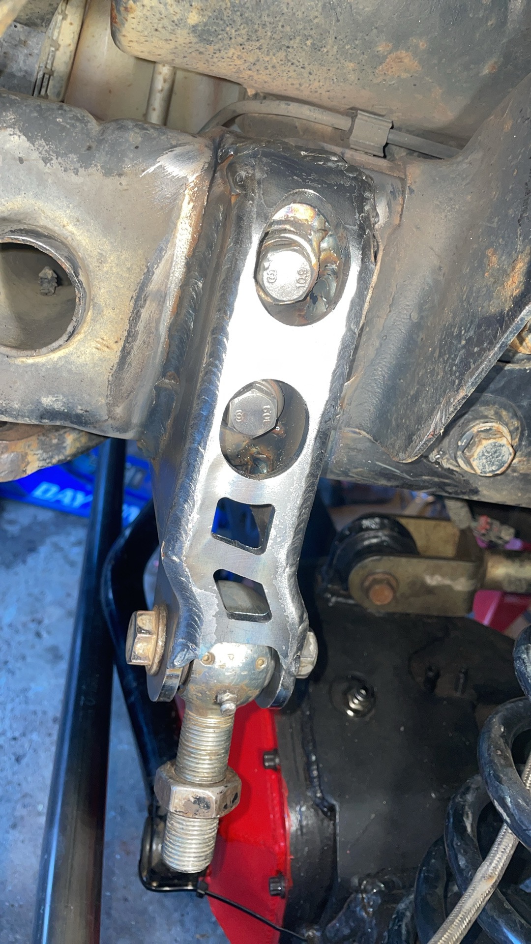

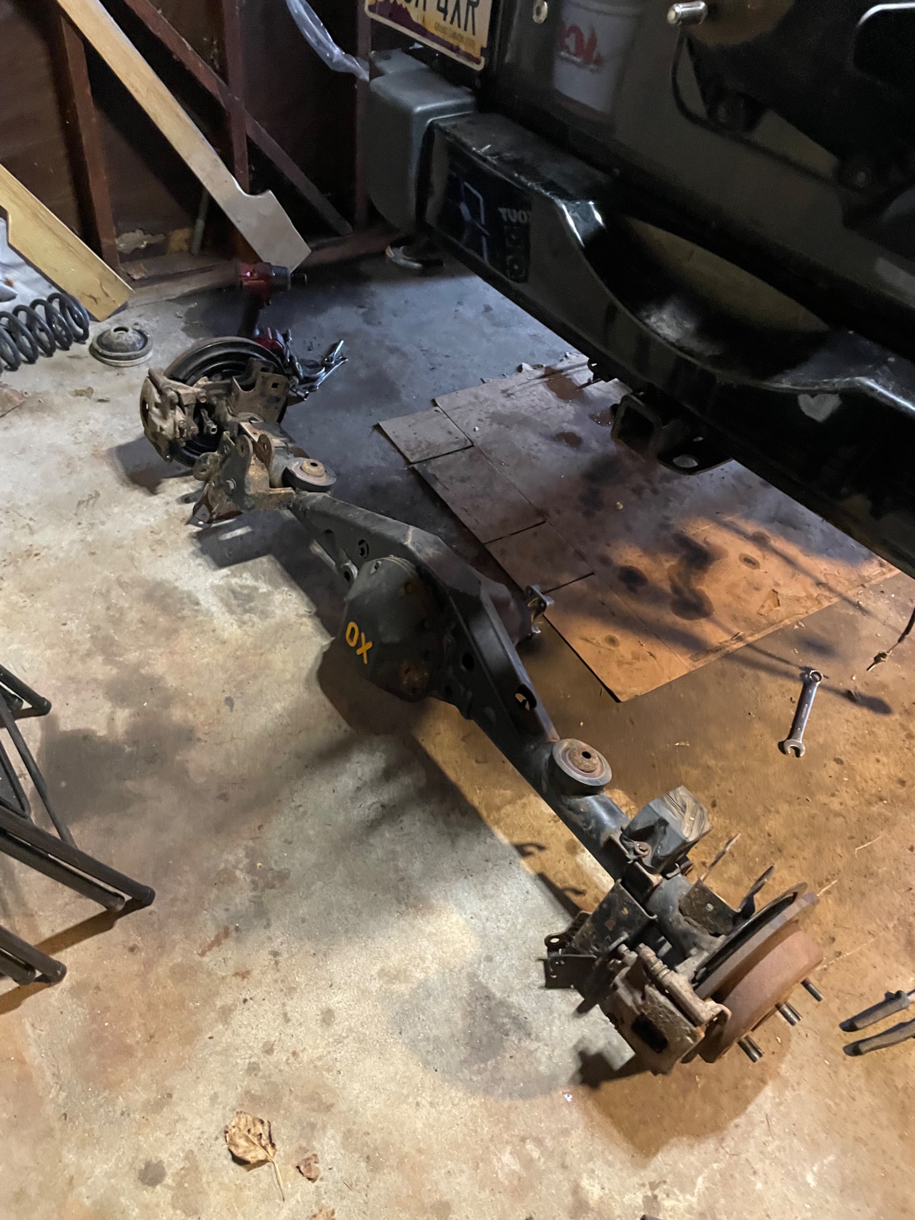

Took her out a few times this last year and started gathering parts for the next phase of the build which will be a 10” rear axle stretch. The rear will be going to coilovers and a double triangulated 4 link. The front will get a 3 link long arm and will be staying on coils and shocks for the forseeable future for simplicities sake.

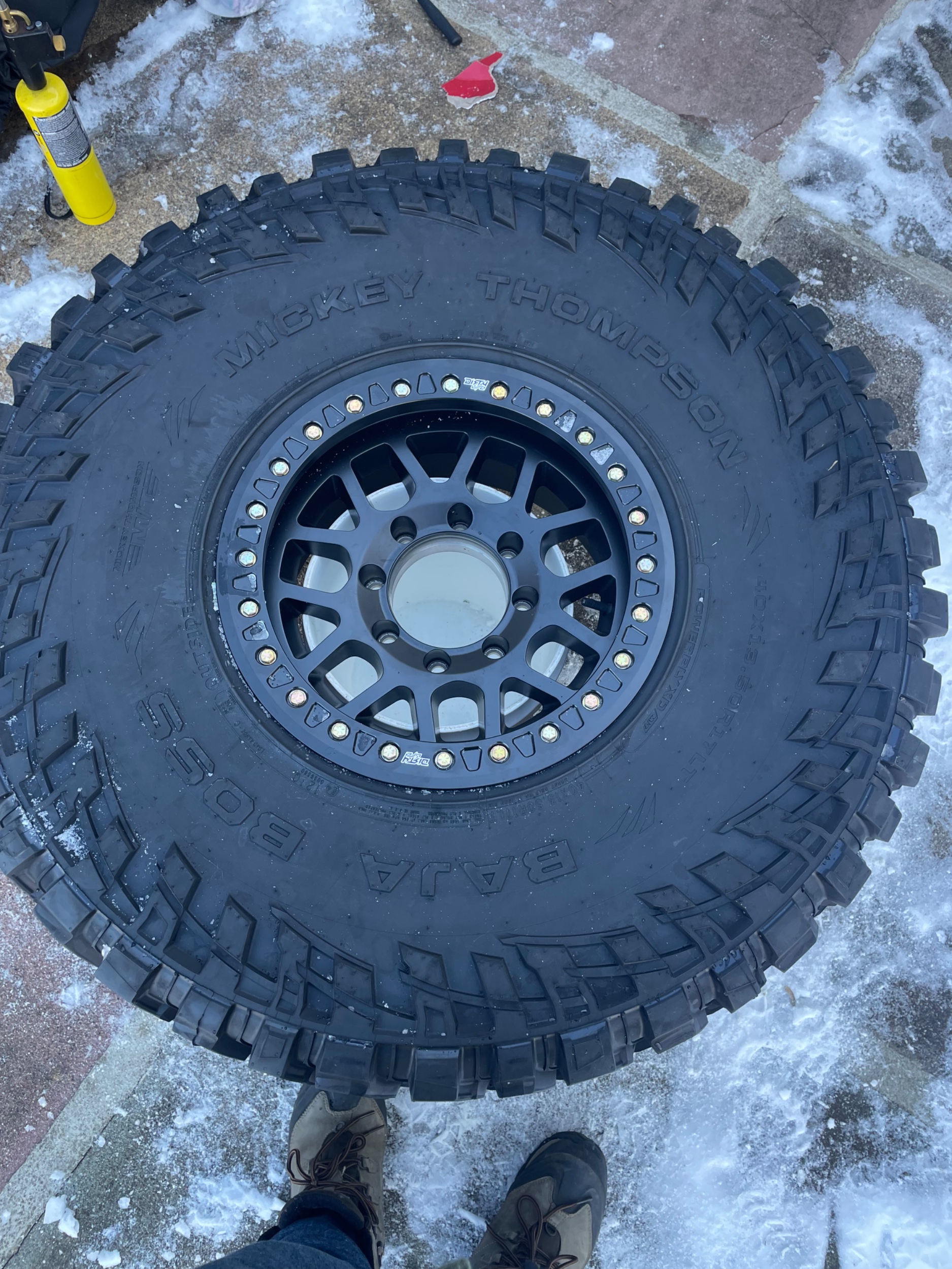

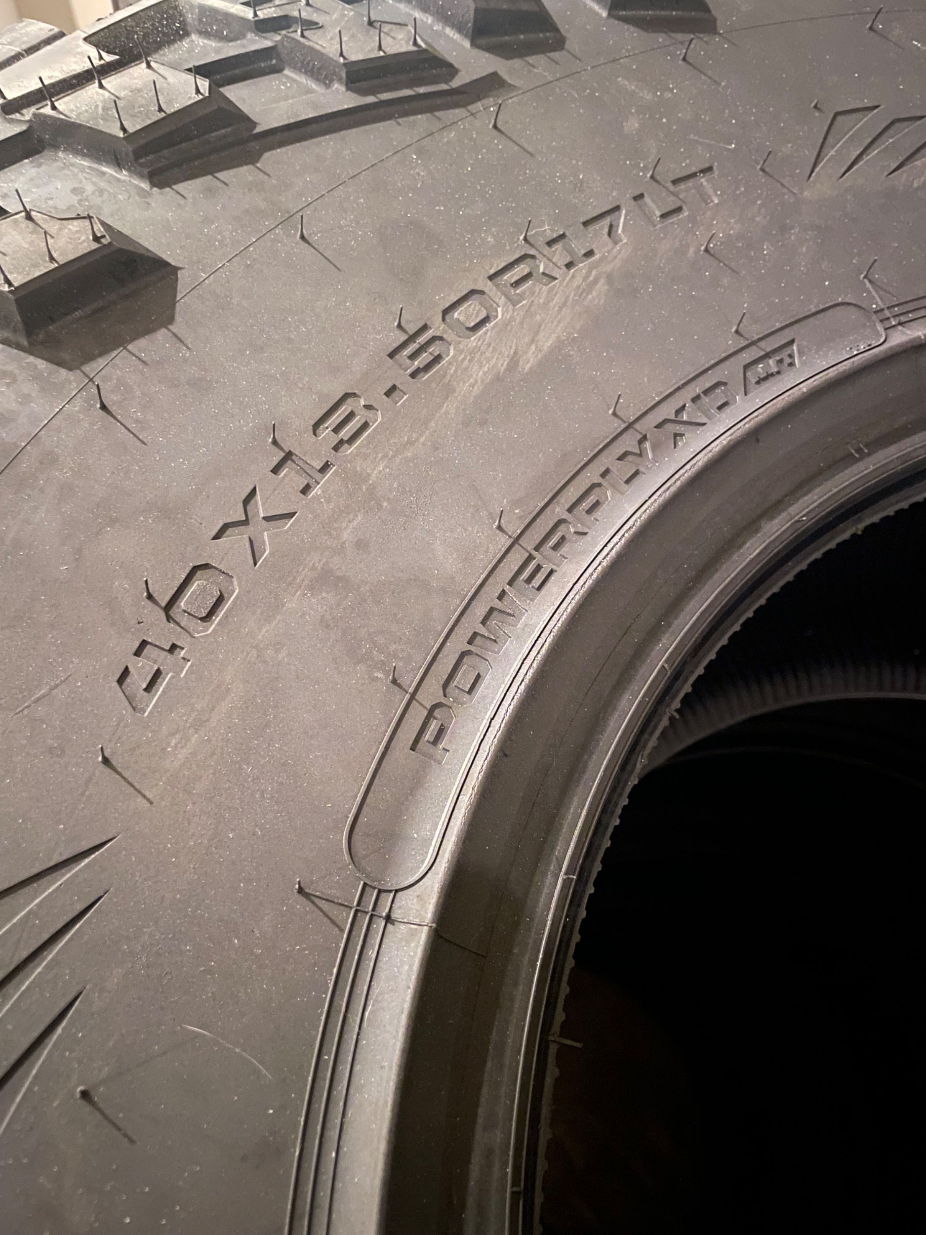

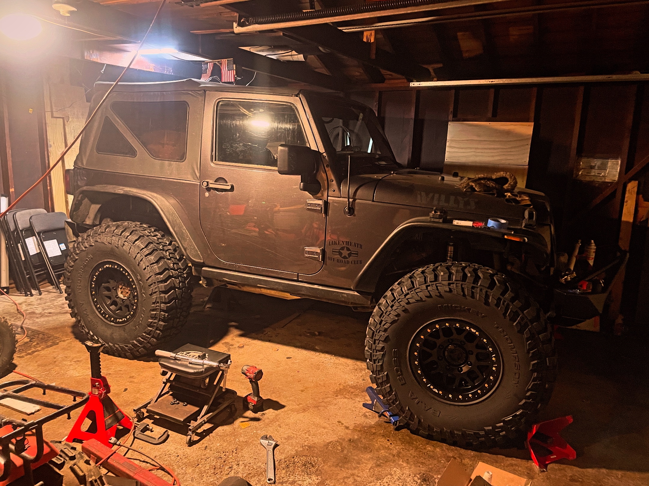

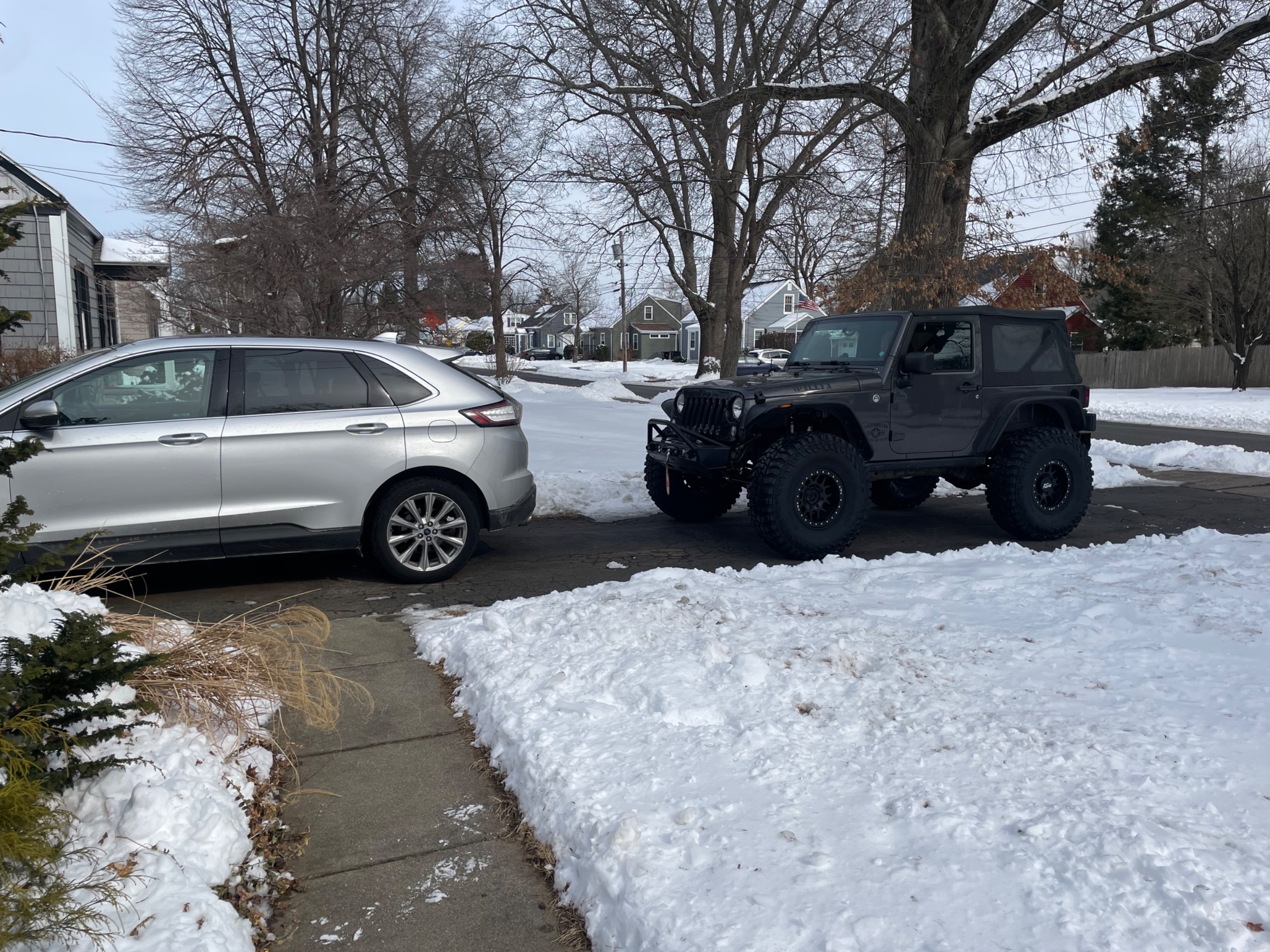

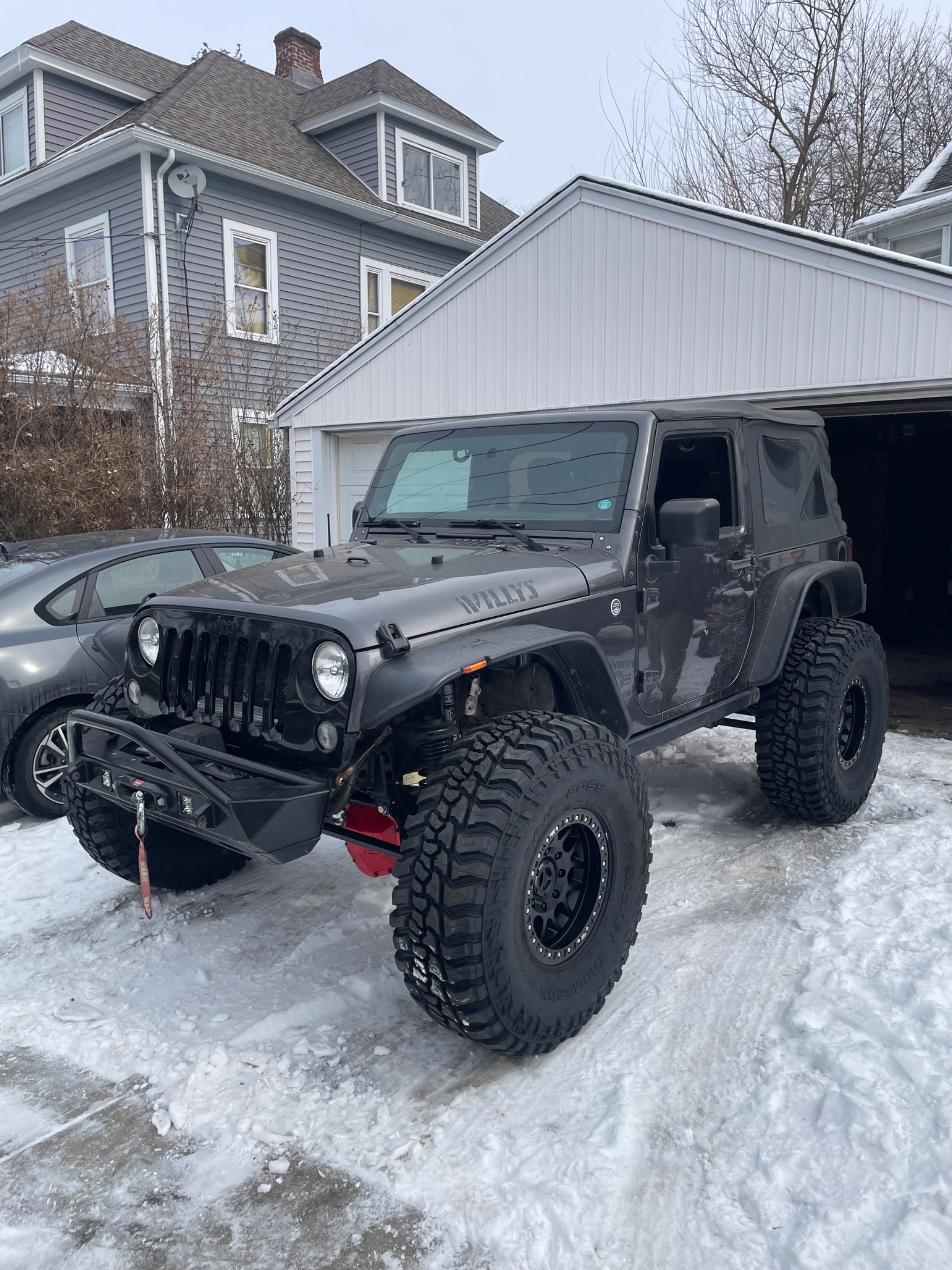

Looks really nice on the ground. I look forward to your opinion on the MT 40's!
The baja boss MT’s are my favorite tire so far. They weigh about the same as my 38” nitto’s and seem to grip better as well. Some people say they are prone to sidewall failures but I haven’t seen any personally even with the sticky compound. When I eventually go up to 42’s I’ll probably grab another set of the baja boss. Its a solid all around tire with a thick bead and nice grippy compound that isn’t too loud on the road.
