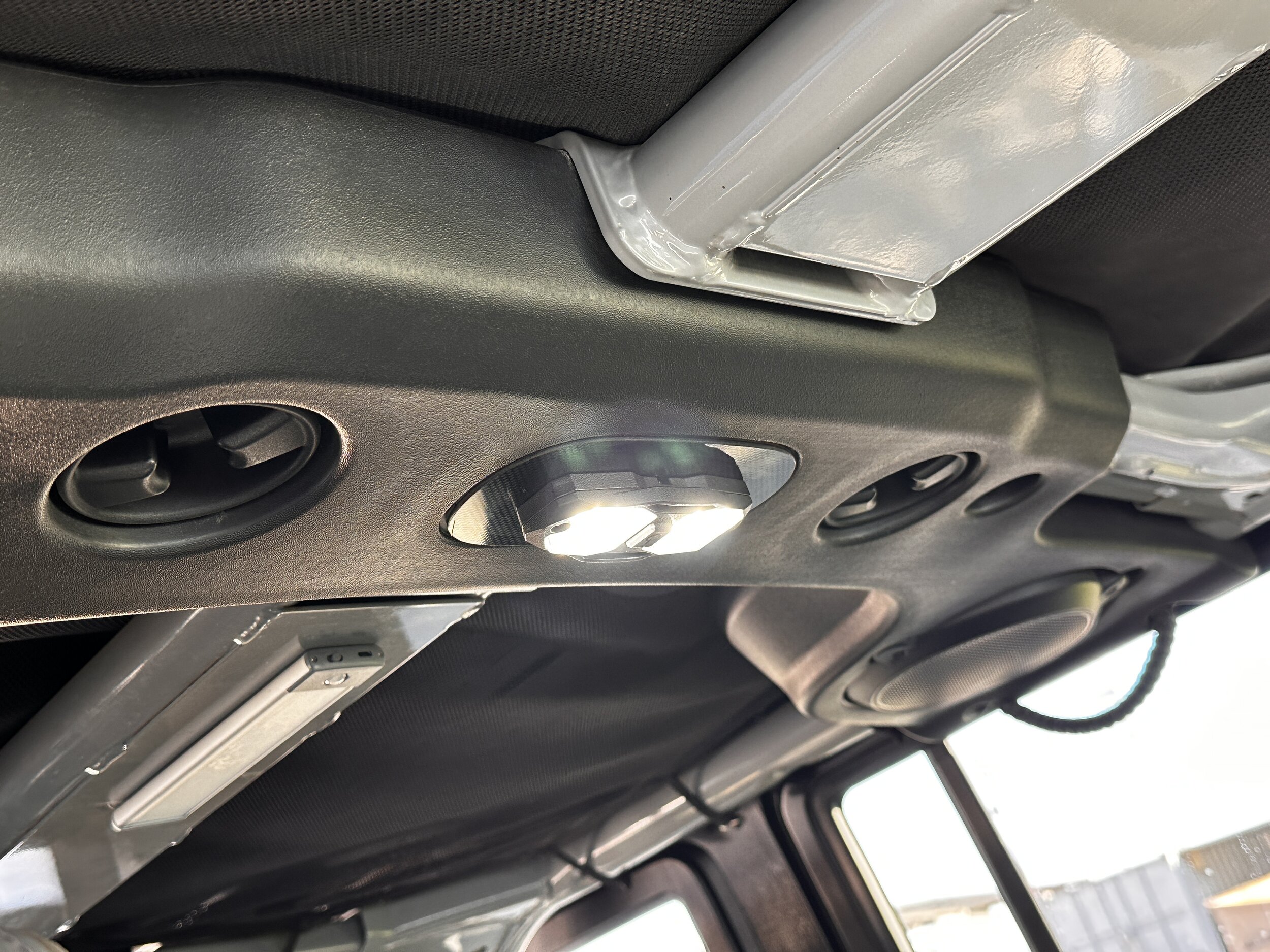

This was the best thing I did to my JKU sound bar. The rattle and vibration is all gone now. The Alpine and Mille pro combination of speakers is great. The OE dome light housing was shaking as well as the actual bulb in the pincher mounts. Used double stick tape to hold it in. The only issue is the led light itself is not dimmable, so when the light turns off, (dims slowly) the led flashes a little.
